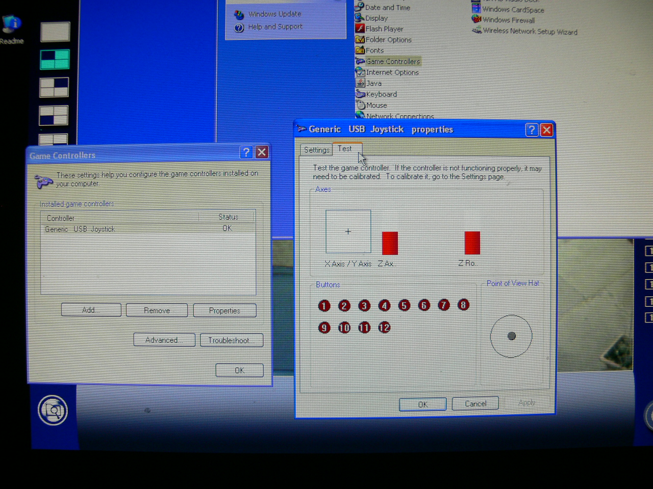

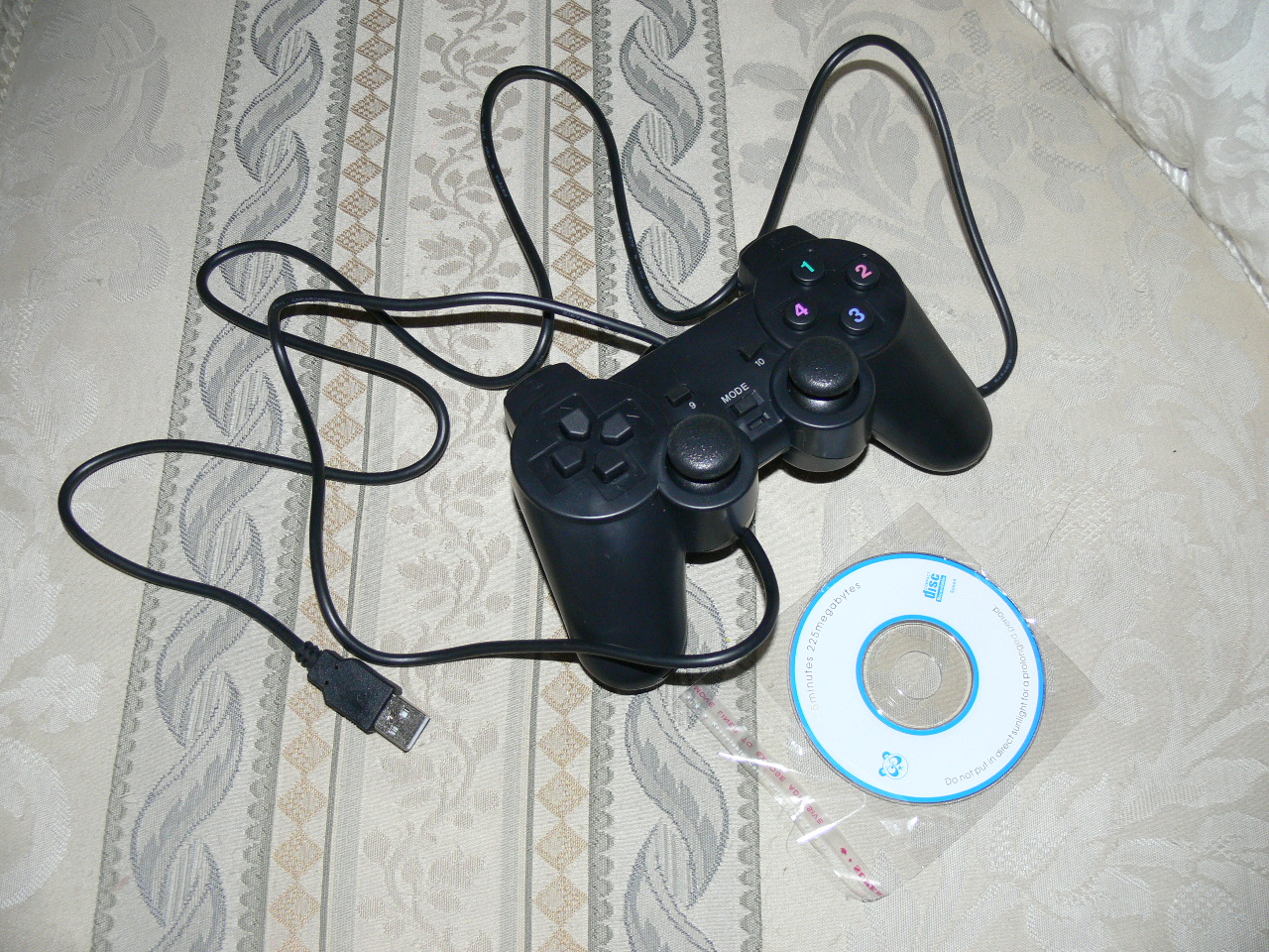

I received today new USB pc gamepads for my boys. First thought I had : is it possible to connect it to mach3 to control axis, feeds, start,stop etc?????
Attachment 5116 Attachment 5117
Did someone do it ????

Yes they have. See here:
http://www.machsupport.com/plugins.php
Look for Xbox, at the end.
Edit: Oh except that's not an Xbox controller? Maybe one of those will work anyway...
An xbox controller is a standard USB one anyway, I know as i utilised the controller ports to run my keyboard and mouse when i stuck linux on it :-)
you can make it wrk easily just using a joypad keyboard emulator such as the one on tis page http://www.gamessence.net/gamepad-keyboard-emulator/
Thanks John. It does work and cooperate with mach3 nicely.
I can control all axis + start stop buttons. £5 gamepad from fleebay with 1.8m long cable does its job. Must order another one or nick from boys room :naughty:.
Does reset, feedrate down or up button have keyboard shortcut???
not sure bout reset feedrate etc having a keyboard shortcut but i think ctrl puts it in step mode so if you old ctrl and then press a direction it will move one step depending on what the step is set to in mach i.e 1mm 0.1mm 0.01mm etc
