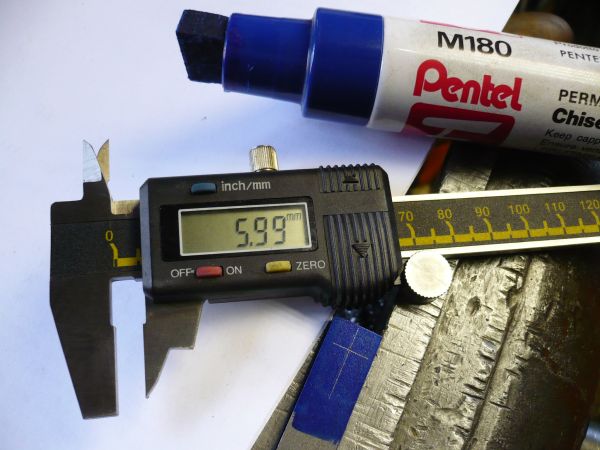

Can anyone suggest where can I get layout blue/dye from? I don’t need a large quantity, as it’s only for marking up six or seven plates for drilling and tapping.

Go to your local stationers and buy one of those big fat Eddings or Pentel pens.
Don't leak, don't get knocked over, always handy.
Attachment 5405
Buy a cheap Aldi vernier, grind the outside leg off and sharpen the moveable jaw and you have *precision* odd leg calipers.
