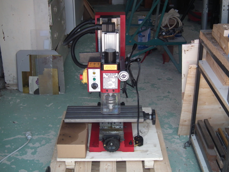

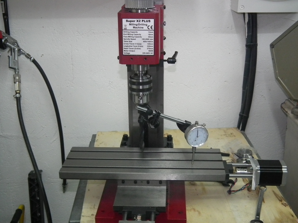

My new mill arrived last week. TNT did a good job of getting it from Leicester to Montpellier (South of France) in 40 hours but it then took them 6 days to get it the last hundred miles. However, it arrived in good condition.
Attachment 5956

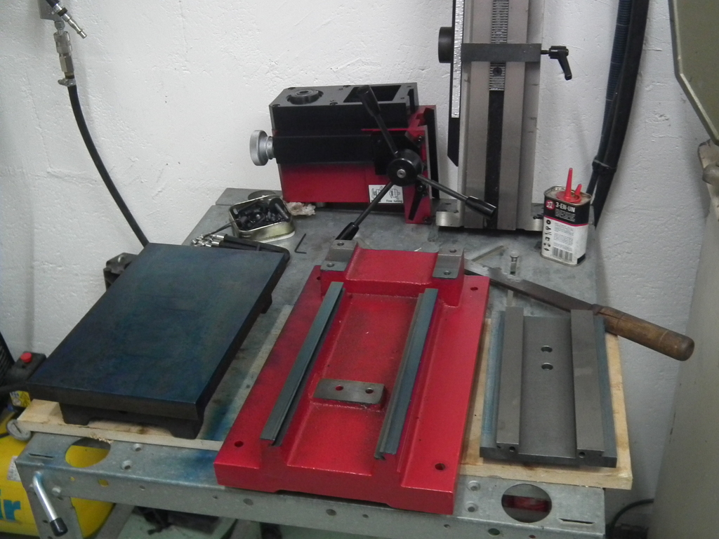

Mill as received. I then stripped it down, washed everything in paraffin, and checked everything. The base was pretty good really but I blued up the surface plate and scraped it in:
Attachment 5957

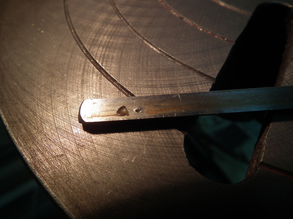

The only fault I've found so far is the gib strips:
Attachment 5958
The photo shows a close up of one end of the X strip. The dimples are only partly formed and are such that any movement will give a wedging action and stiffen things up. I will deepen the dimples and put points on the adjusting screws (as recommended by Arc Euro) and see how they go. If they are still unsatisfactory I will then fit a dowel to prevent side to side movement.
