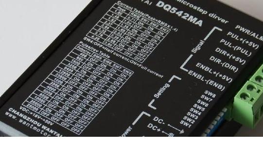

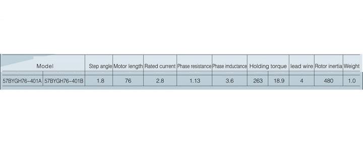

Does anyone know if the Amperage on the nema23(4) 3Nm stepper motors is listed in Peak or RMS?
The international standard is to list it in RMS but we are dealing with China here so that is not a for sure in any way.:joker: I am just wondering as it greatly affects how you set up the drivers. Which set up properly is not a problem and should have smooth running steppers. Step up the wrong way and you are either running hot and going to cause their useful life to shorten a good bit or you will be under powering them massively and there by have step loss issues and such. Just asking as It would be useful to know.
