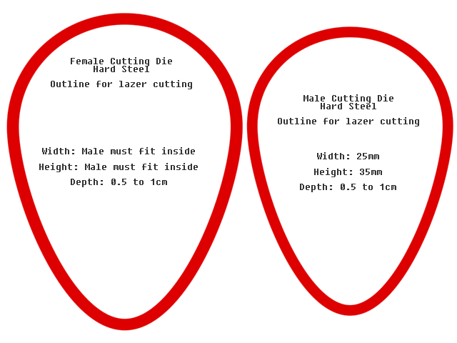

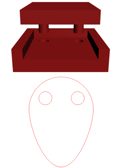

The project consists of
1: A small simple press
2: Male and Female cutting die
3: A Punching Device
4: A bending device
I am not an engineer, but I have at least put together
some 3d models and outlines of what I am trying to
achieve, but it would require the knowledge of an
engineer to turn it into a usable device
What I want is a press that you could put 1mm aluminium sheet into
and when struck with a hammer, drives a cutting die through the sheet
to leave a nice clean cut out. The press then returns to its default position
and the cutout can be safely removed. See attached the press I had in mind
and also an outline of the cutting dies I need.

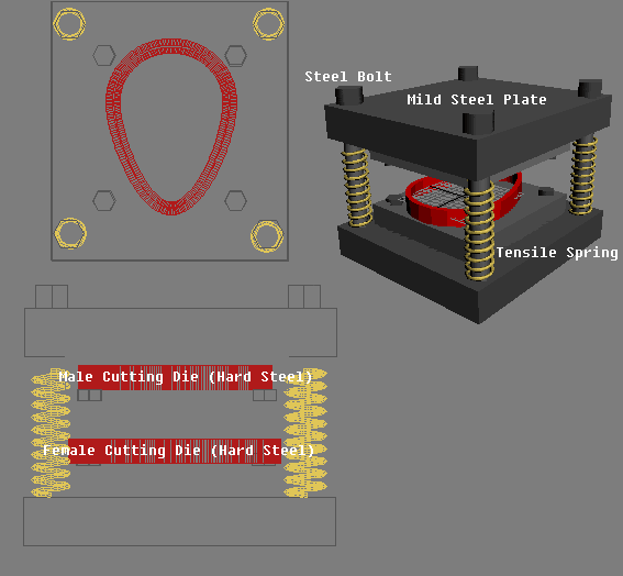

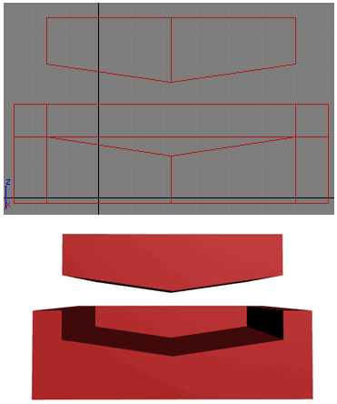

What I also wanted was the ability to swap out the dies for a tool that
allows the cut out to recieve 2 hole punches. After which the punch tool
can be swapped out for a bending tool that allows the cutout to recieve
an exact bend.
All of this for an item around 25x35mm in size.

From what I can see this can all be done with one set of punches on a simple fly press, google fly press.
If the male and female have the bend shape in your last picture, bottom right but also the outline shape of the part the flypress with first cut it, then bend it and a set of spring loaded pins will finally punch the holes.
Ejection springs are needed to obviously eject the part ready for the next item.

Right ok, thanks John. I see what your saying, if I maybe redesigned the
cutting die so that it cuts, punches the holes and bends the shape at
the same time. Good plan. Fly presses look awfully expensive, well outside
my budget, I was hoping to accomplish all this by banging on a mild steel
plate to create the force necessary for the cutting and punching etc.
I am a chainmail armour crafter. I like to keep it simple and bang on
things with a hammer to get a result.
I was not sure if I could generate enough force to cut out the shape
and do the punches at the same time, which is why I seperated them
into individual processes.
