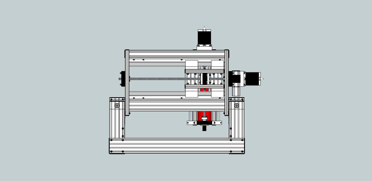

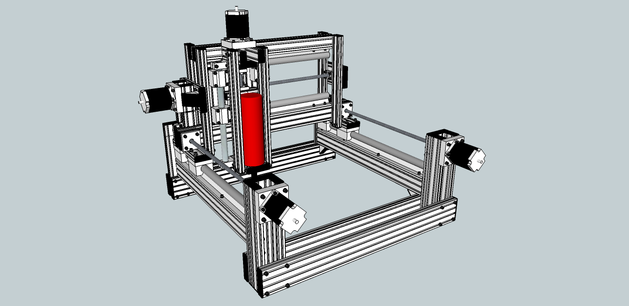

Hello All, here is my first post in what I hope will become a full build log. As mentioned in my Introduction (http://www.mycncuk.com/forums/new-me...say-hello.html) I have one quite tough requirement a bit of steel machining and am building it with a view to making the plans available to others who are in the same boat as me, well not my Narrowboat, but you get what I mean :-)

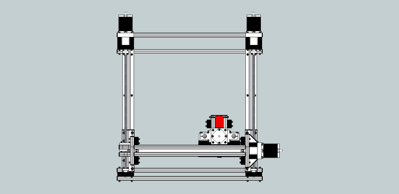

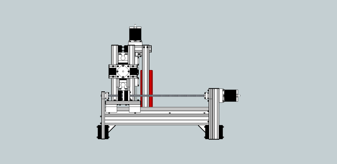

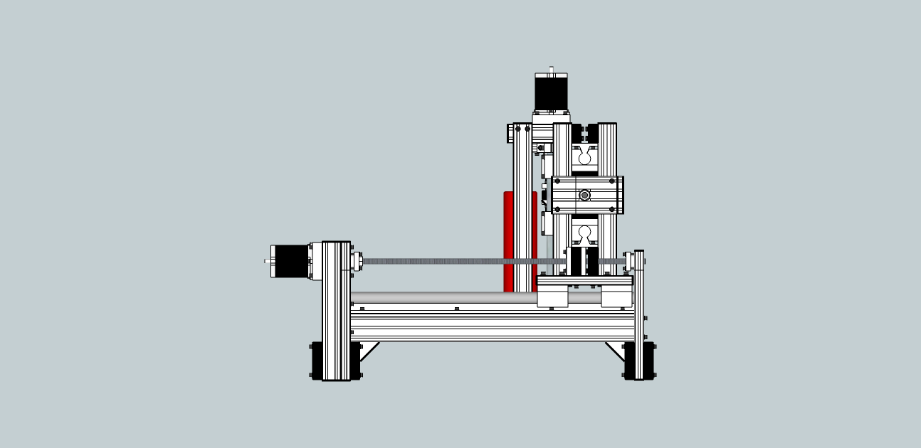

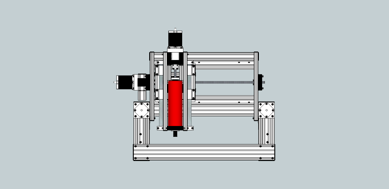

Posted here are the drawings for the machine I have in mind for my use X=600mm (Apprx 400mm useable) Y=500mm (Apprx 300mm useable) and Z=350mm (Apprx 150mm useable). I hope this design is scaleable by adding longer rails and extra rail supports, that was certainly my intention. I have also allowed space where the drive nuts are to go upto 16mm leadscrews for the bigger machines, though I have seen 8'x4' machines with 12mm, to me it just doesn't look man enough.
Attachment 6476Attachment 6477Attachment 6478Attachment 6479Attachment 6480Attachment 6481
Build requirements are to use as many standard components as possible and any unique parts must be able to be made on a Pillar drill. I tried to design it so there had to be no sections that had to be cut to length, but I'm afraid I was only happy with a design that involved the 4 long X Axis beams to be of exact length. All other joints are on the main faces of the extrusions.
To repeat my self slightly My choice of components are governed by 3 factors 1) Cost, 2) Sizing, where possible they are Multiples of the 20mm of the sections I have used & 3) The need for nothing more complicated than a pillar drill.
The machine has come together quite chunky, but that to me is OK as I want to machine metal quite a bit of the time, say 10-20% and I have allowed the cutting area to extend over the rails at the front to give a solid base as I can for doing this.
I will put a Bill of Materials (BOM) on here soon, it's just a bit messy, as it was being constructed along side the drawing. I posted some of the major specs in my introduction, but a BOM will give a more complete story.
I may do a slight redraw to include the DumpsterCNC anti-backlash nuts as for the price I'm not sure my idea, to be posted soon can compete! I have tried to justify Ballscrews, but I wince at the prices and speed and accuracy are not my ultimate goals. I may change my mind of course once I start making stuff, but I am fairly confident I can retro fit them at a later date, without too much trouble. Mostly I want to get a machine going so I can start learning!!!!
I'm happy to provide more detailed views if you need them and really want to know if this design is viable.
