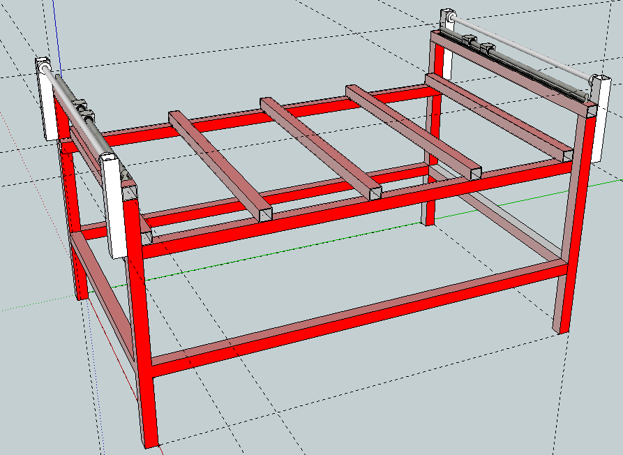

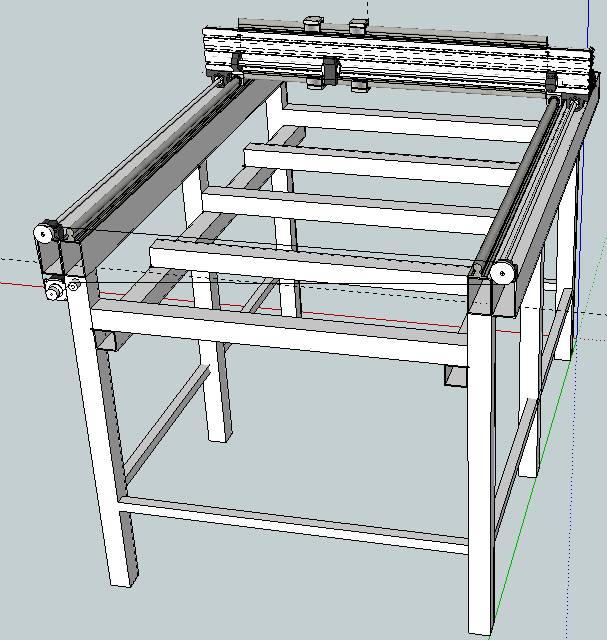

The intention is, to manufacture a flat bed miller. In order to fundamentally cut / carve wood. However, while I am there I wish to make it well enough to cut aluminum which I think will be ultra handy for some other projects I have in mind.
Id like to make it about 3m by 3m however I dont think my bank balance will afford it. I dont want to compromise too much on size just because of the cost so if I can achieve a working area of around 1m x 1m I wont be too disappointed.
My original idea was to copy some of these angled ali / bearing linear ideas I see so frequently on youtube with a wooden frame etc. However after reading some of your thoughts and comments on here Ive decided to do it properly, so if at any point I seem to be cutting corners please feel free to point it out.
Today I have learnt alot. The differences for example between Trapezoidal Spindles and Ballscrews for example. Vibration, jitter etc

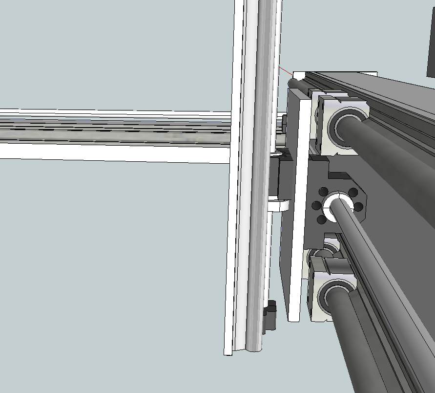

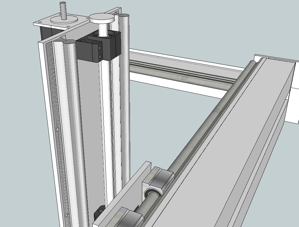

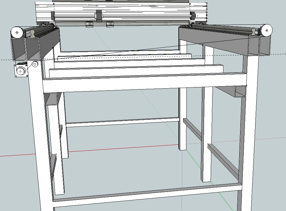

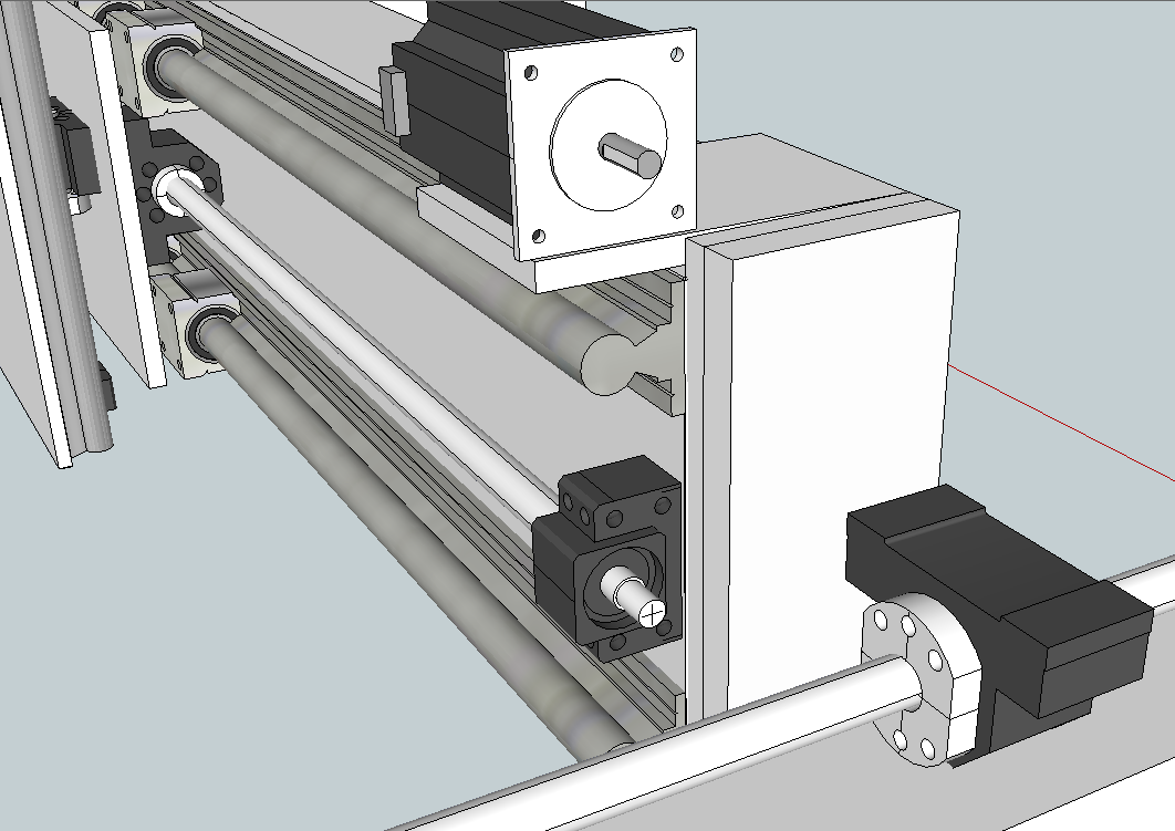

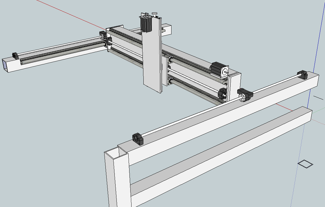

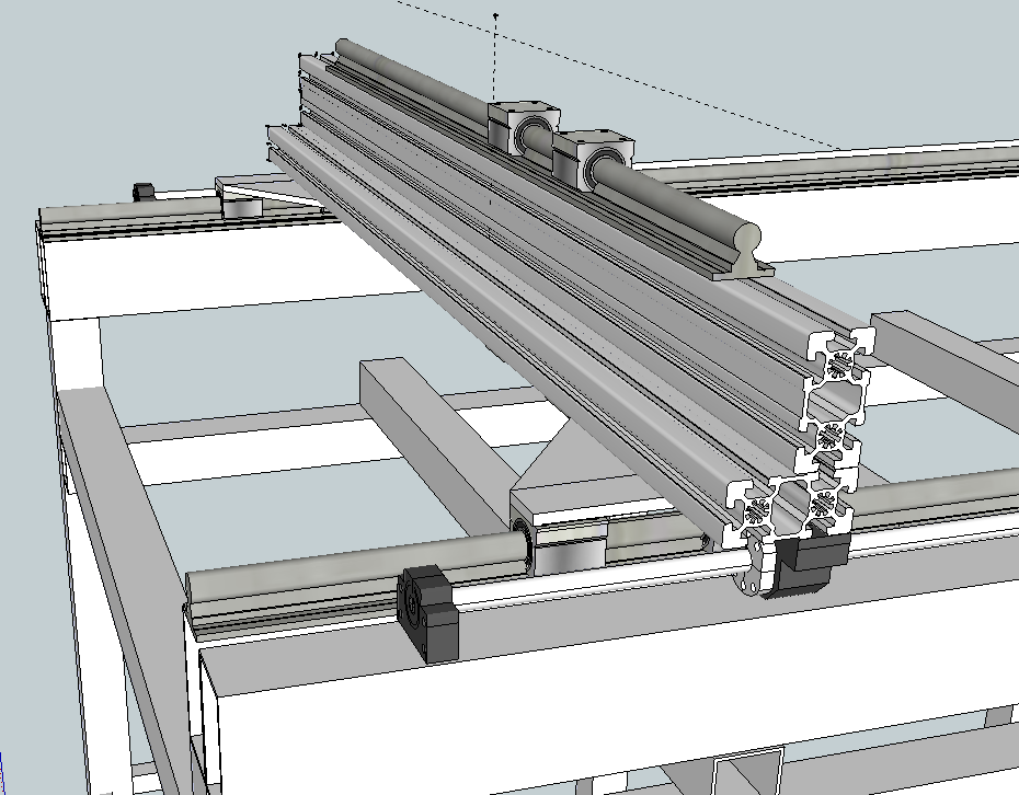

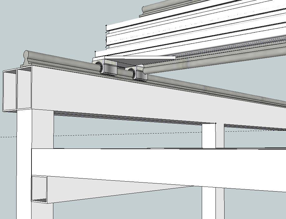

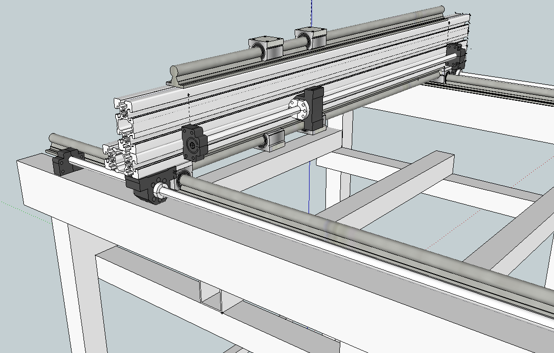

On request of fellow members of this forum, I think its prudent I make some drawings discuss all my ideas etc before I go balls deep and order the gear. So today has been a crash course in 'sketchup' which incidently ROCKS. Ive attached pictures of my gantry design
It is, to be fair a bit similar to motoxys. But as there was so much discussion around this subject I hope he doesnt mind me harnessing the wealth of ideas around this very subject.
So assuming the gantry is 1300mm does this look about ok?
