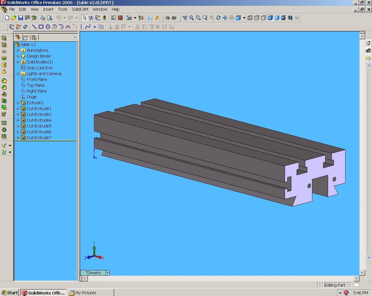

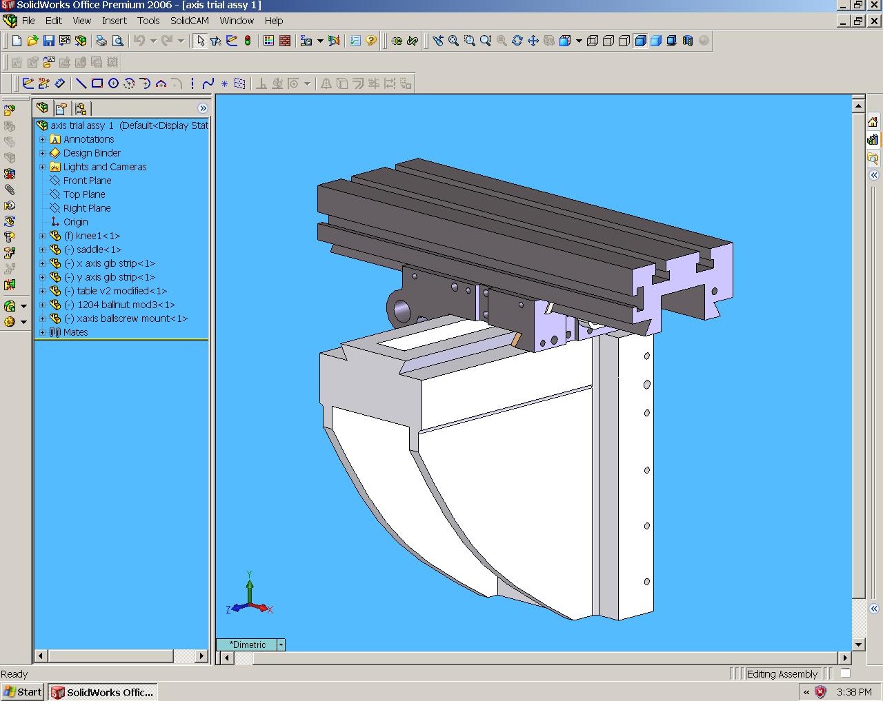

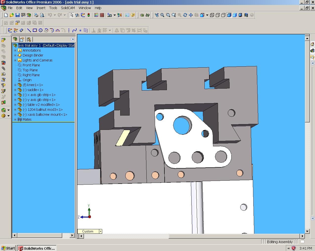

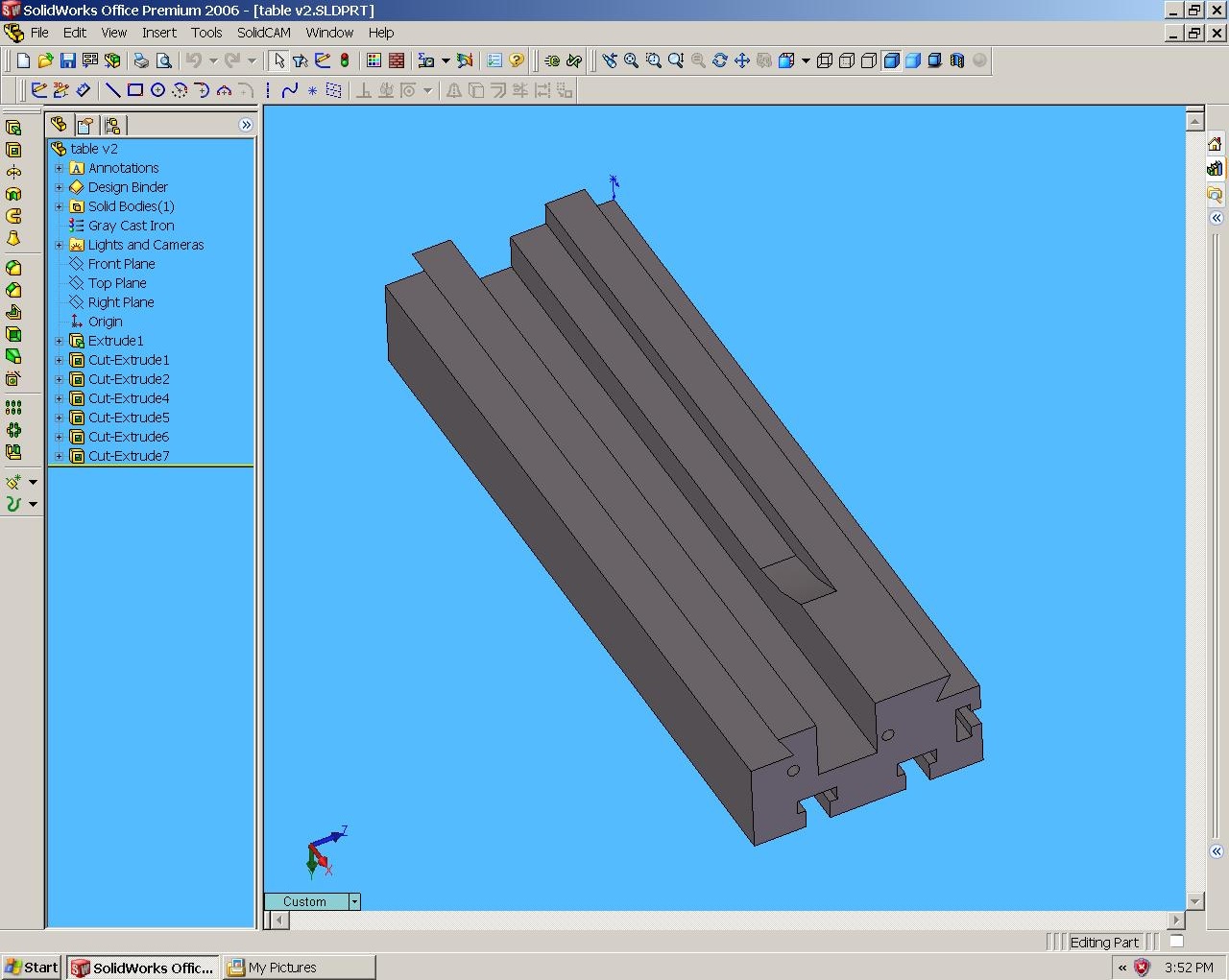

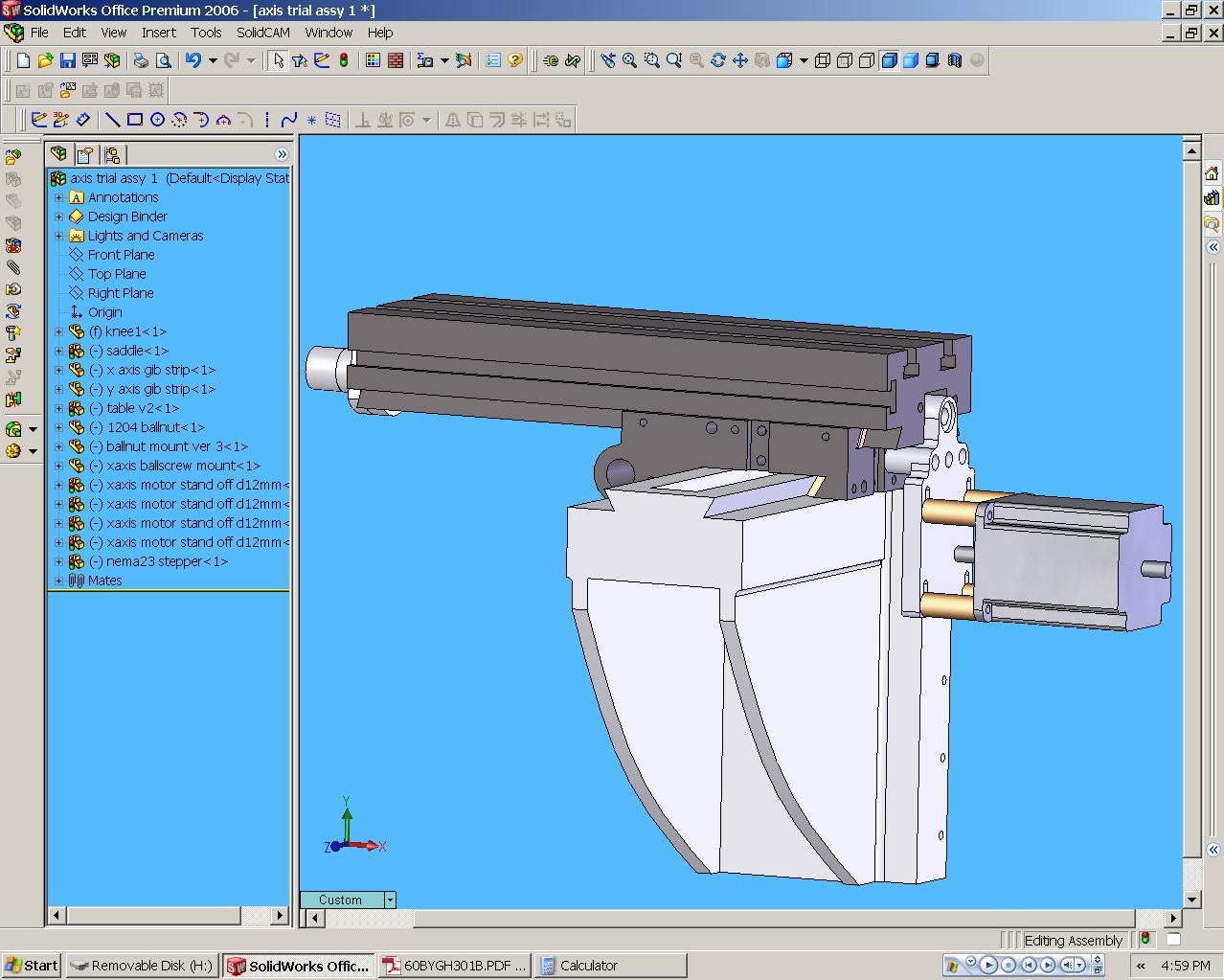

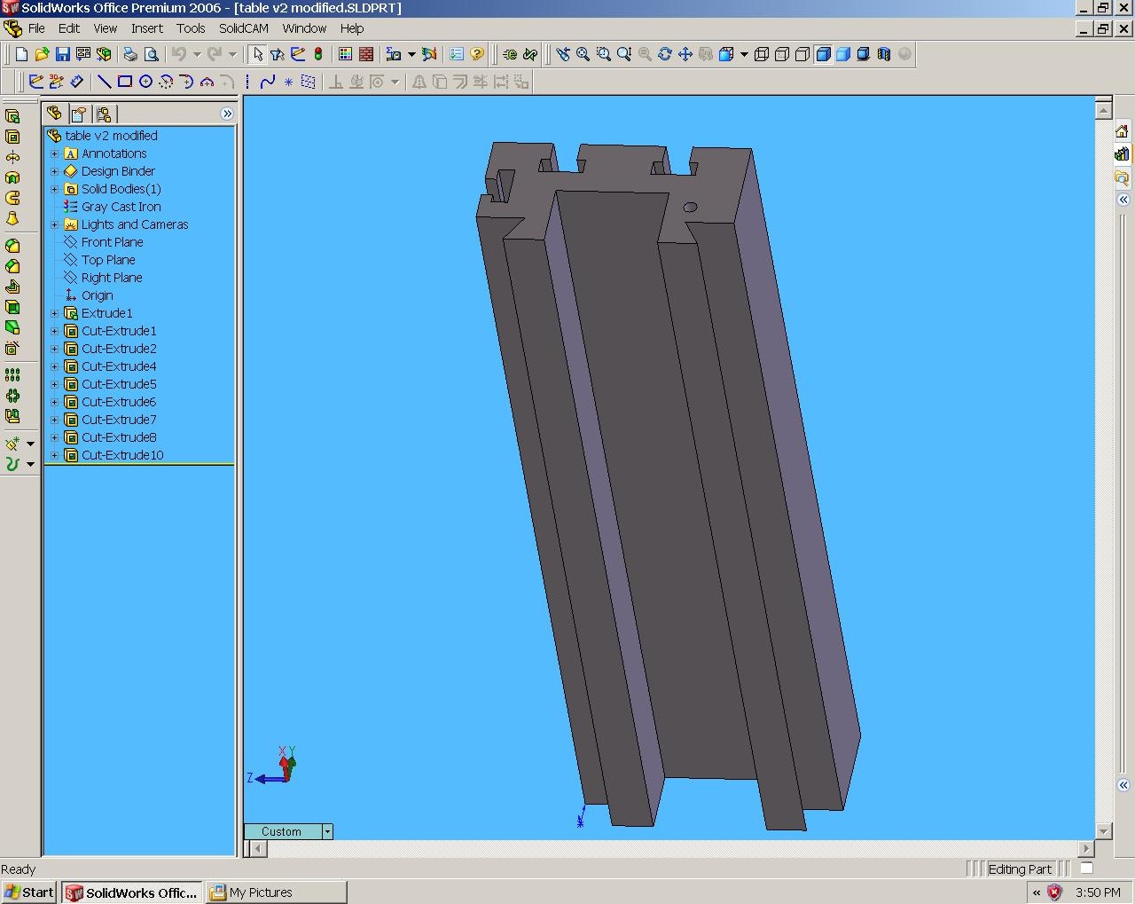

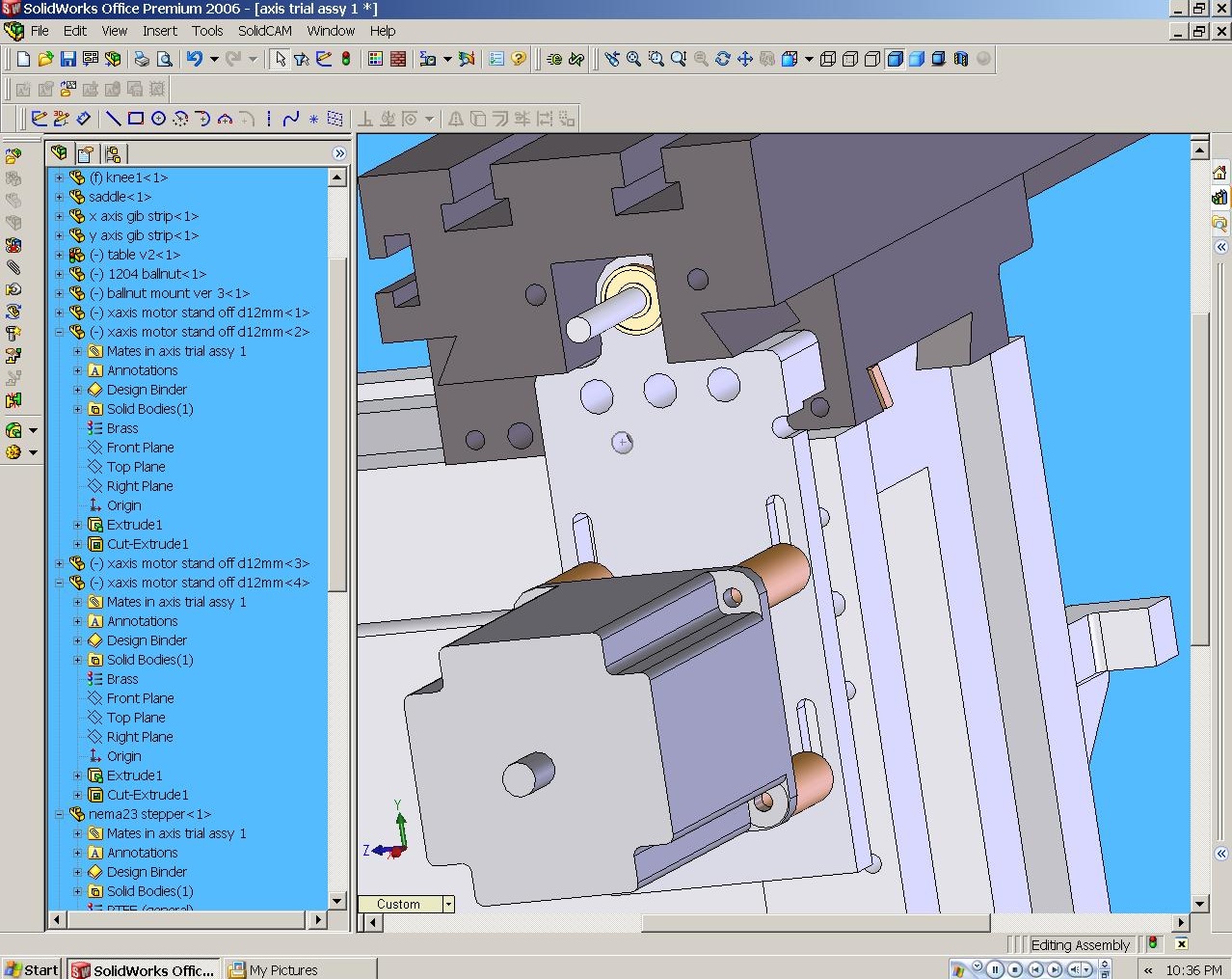

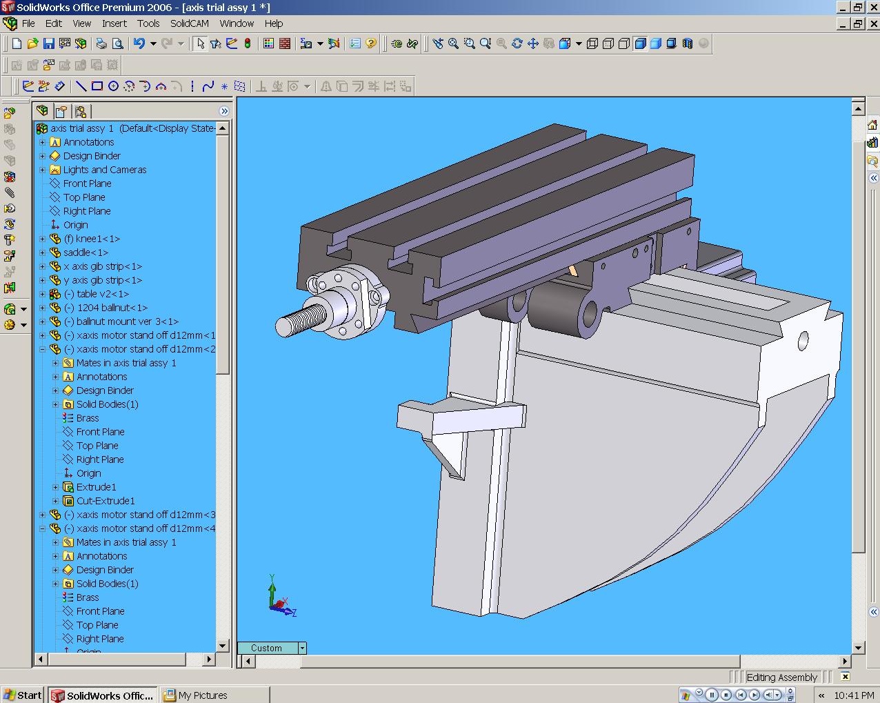

im currently still at the planning stage for converting my centec 2 to cnc

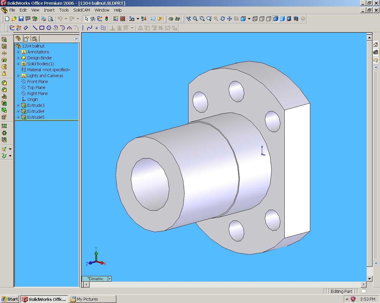

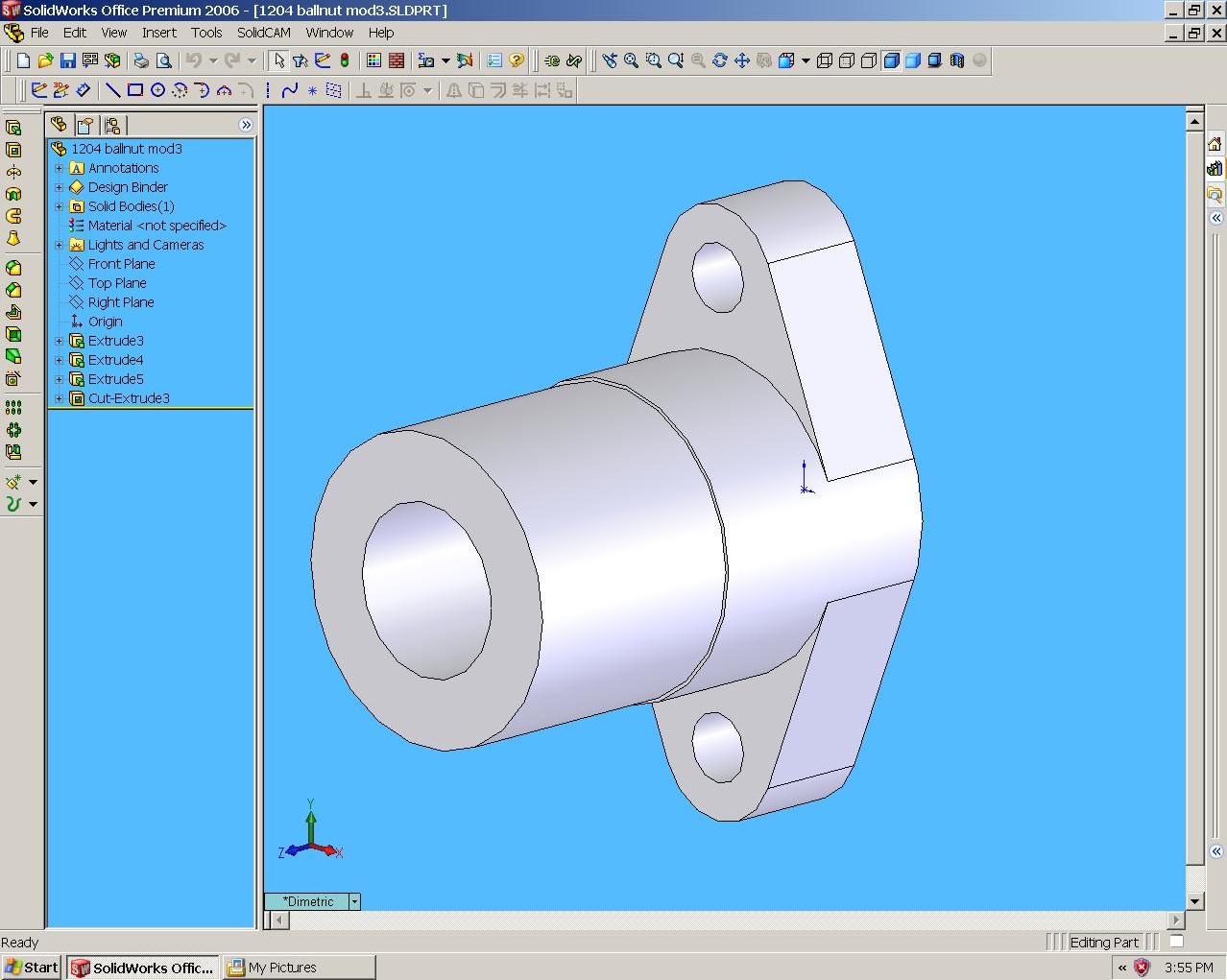

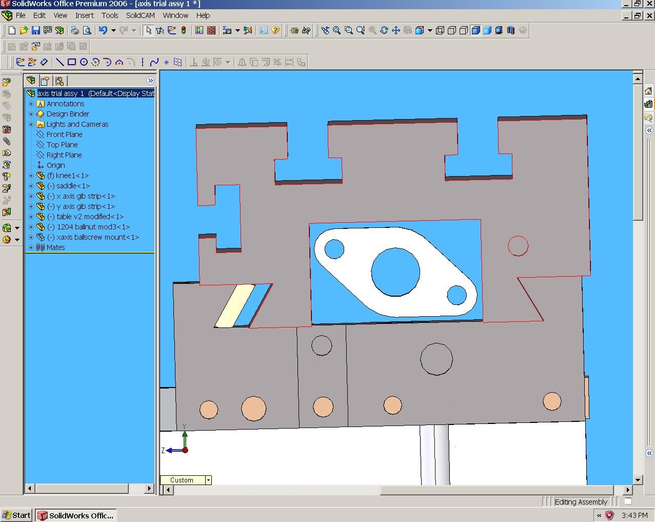

one major issue with converting this machine is the sheer lack of space under the table and to even squeeze a flange 1204 ballnut through requires major metal removal to both the table and ballnut
since im not particularly happy about the amount of butchery necessary does anyone have any ideas on where to find smaller ballnuts for 8mm or 10mm screws that arn't twice the price of a 1605
failing that, any other ideas?
