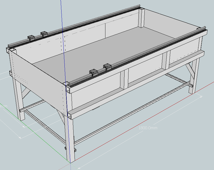

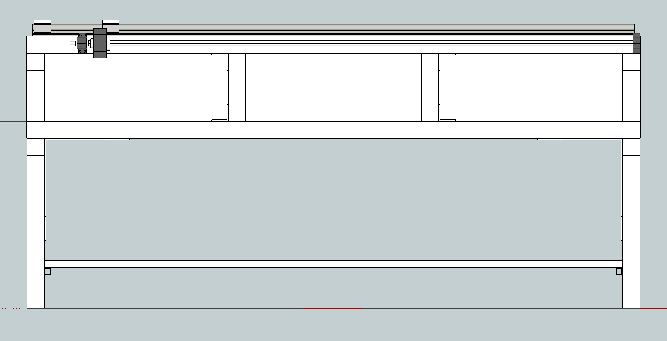

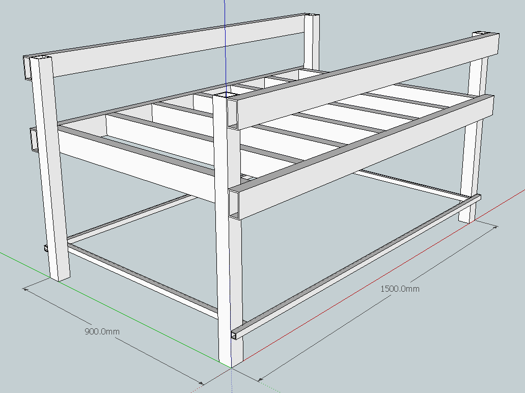

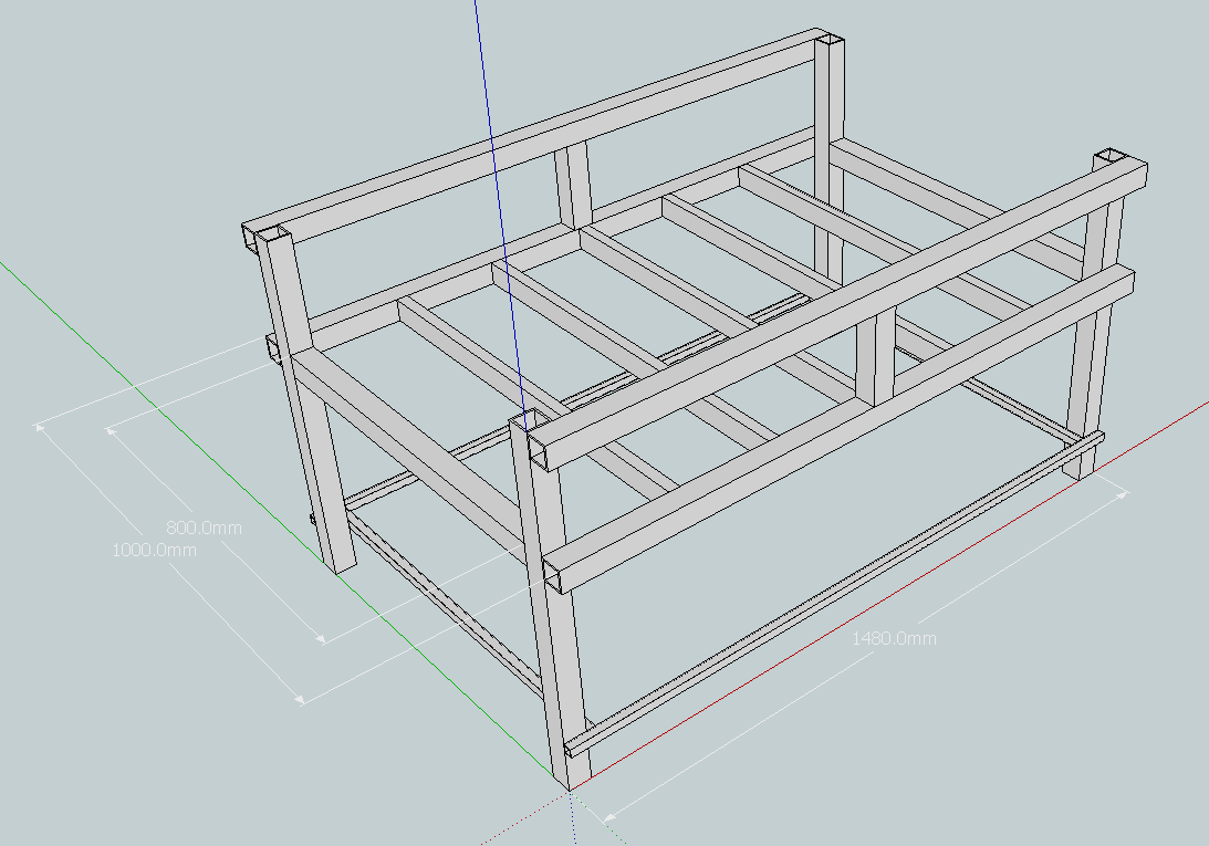

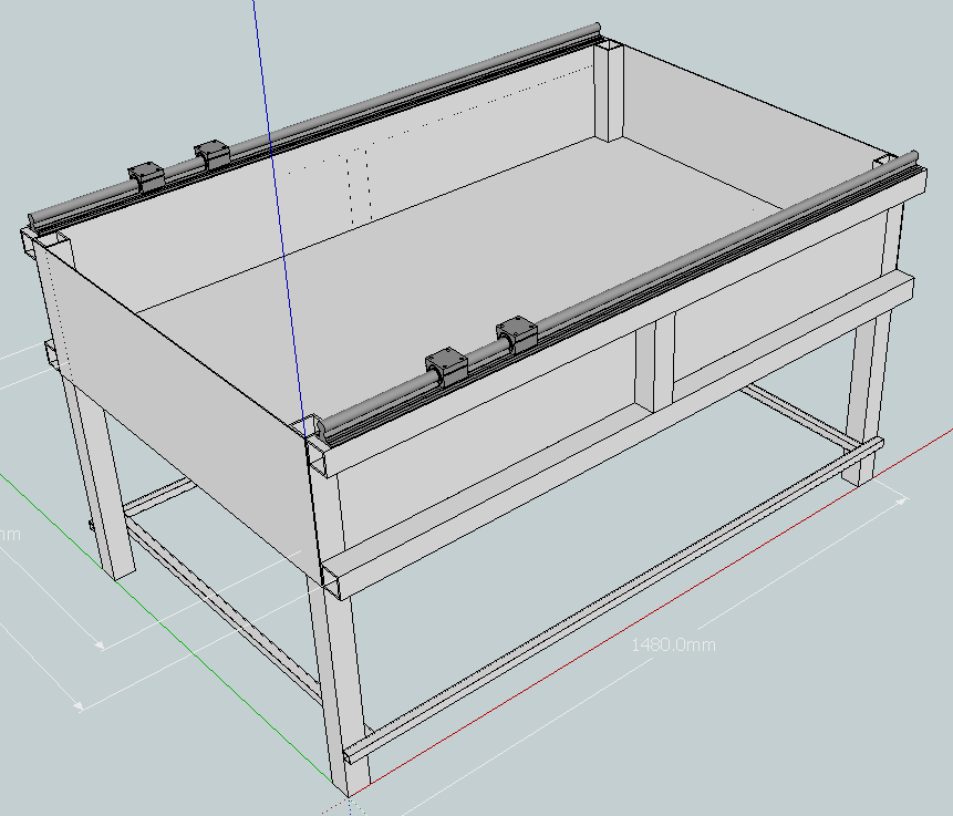

The X-axis rails and the bed are 80x40x4mm the legs are 50x50x4mm. The bracing around the bottom is 20x20x2mm. Overall, the X dimension is 1500mm the Y is 980mm (900mm leg to leg) and it stand 800mm tall. I believe this should give me a maximum possible cutting area of about 1400x800x200 which is a little more than I was initially aiming for.
Attachment 7297
The frame will, initially at least, be bolted together possibly with epoxy on the X-axis rails (inspiration from here: My First Router, Built in Steel - CNCzone.com-The Largest Machinist Community on the net!). I would rather it was welded but I need to be able to dismantle the machine for moving in the future and I'm pretty sure I couldn't get it down the stairs in one piece :joyous:.

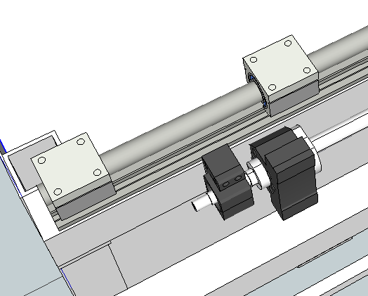

The current plan is to put the rails on the top of the X-Axis rail with the screw on the outside (there will be a screw on each side). To keep the length down I'm considering mounting the steppers on the bottom rail and using timings belts but I can't help feeling that's just complicating matters.

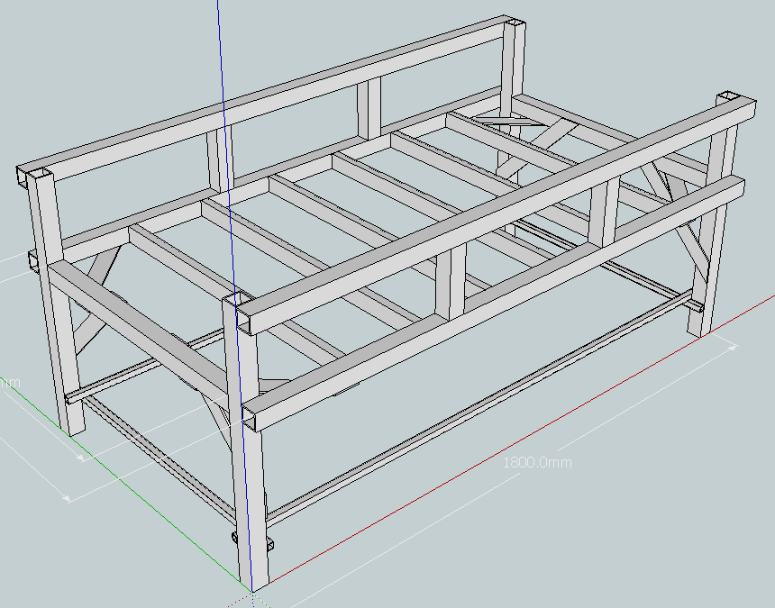

Looking at the design again I think I'll stick at least one vertical support from the bottom to top X-axis rail. Do you think this design needs any other bracing? My gut is telling me it could do with some diagonal bracing but I want to keep the weight down if I can so where would be best to put it? The big question I have though is regarding the straightness of steel box section. I've read quite a few posts that say it comes with a bit of a wobble on it, presumably I need to mount the rails onto something that is fairly straight and flat? How do I go about flattening out at least one side of the top X-axis rail?
