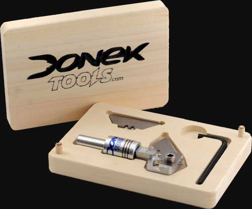

Hi guys , I have a ER-11 and I want to buy a tool that uses a 1/2 inch collet.. can I use the tool with my spindle ?

Andy , would I need to buy another chuck etc to fit the 1/2 inch tool, the specs for the tool is below ? Is mine a 1/2 inch spindle in other words ?
"The drag knife fits into your CNC router’s 1/2 in. router or spindle collet, making it a universal fit for almost any CNC router available."

If the shank on the tool is 1/2", then ER11 is insufficient since, as GTjim said, that size collet will only accept up to 7mm. The minimum size collet series that accepts 1/2" is ER-20 which goes up to 13mm, so unless you can make some sort of adapter which is 7mm on one end and has a 1/2" hole in the other...you're stuck. That may be possible since a drag knife isn't spinning fast, so the rigidity isn't so much of a problem. Possibly the tool itself could be modified on a lathe to give it a 7mm shank?
Looking at the tool in question..
Attachment 7372
It looks like it could be modified, so long as it's not made from a very hard grade of steel, which seems unlikely.

Thanks fo the replies folks I'll ask the seller if it can be made smaller or they do say a smaller type is in the process of being made for sale.

A drag knife puts a large sideways force on the shank, not sure it could be made that much smaller if it is not to bend.

Just wondering if I could make a dummy spindle for the tool, as it doesn’t actually spin it would only need to be a clamped in?
Ah just got a reply from the makers, they are going to do a 1/4 in the next few months, I'll wait for that :)
