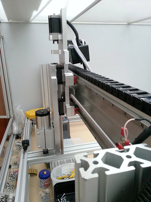

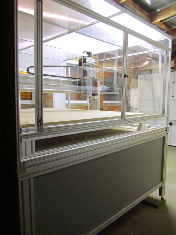

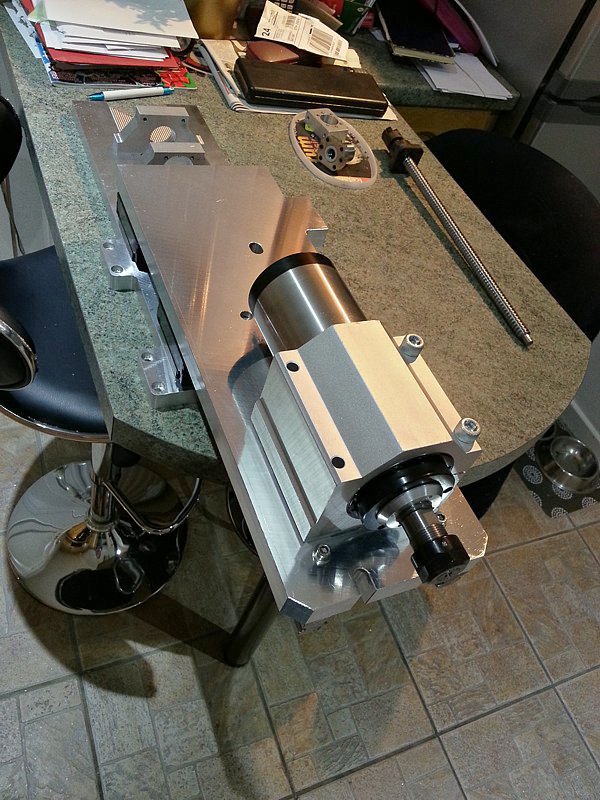

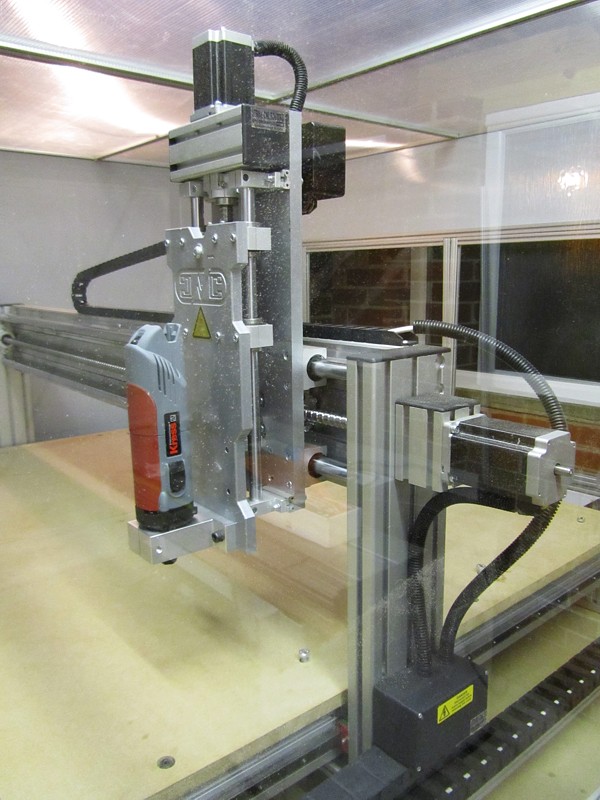

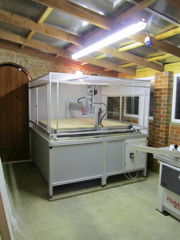

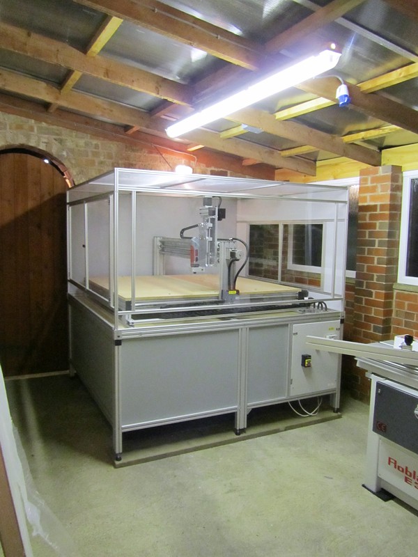

		Hey guys,
After buying shite from Strike CNC, I've spent the last year fixing it along with a bit of upgrading to cheer myself up too! Starting this thread to just give myself a bit of motivation and something to look forward to as its nearly complete and should be cutting very soon.
Here's the original turd I got from the anus at Strike. And yep I know, millions of problems and only just up to the task of cutting air (bit of an exaggeration but its not far off the truth)
Attachment 7686   Attachment 7687   Attachment 7688   Attachment 7689

		Looking at the quality of work you have done its a shame you did not build it all in the first place. Congrats on actually producing that silk purse from a strikes ear. Nice work.

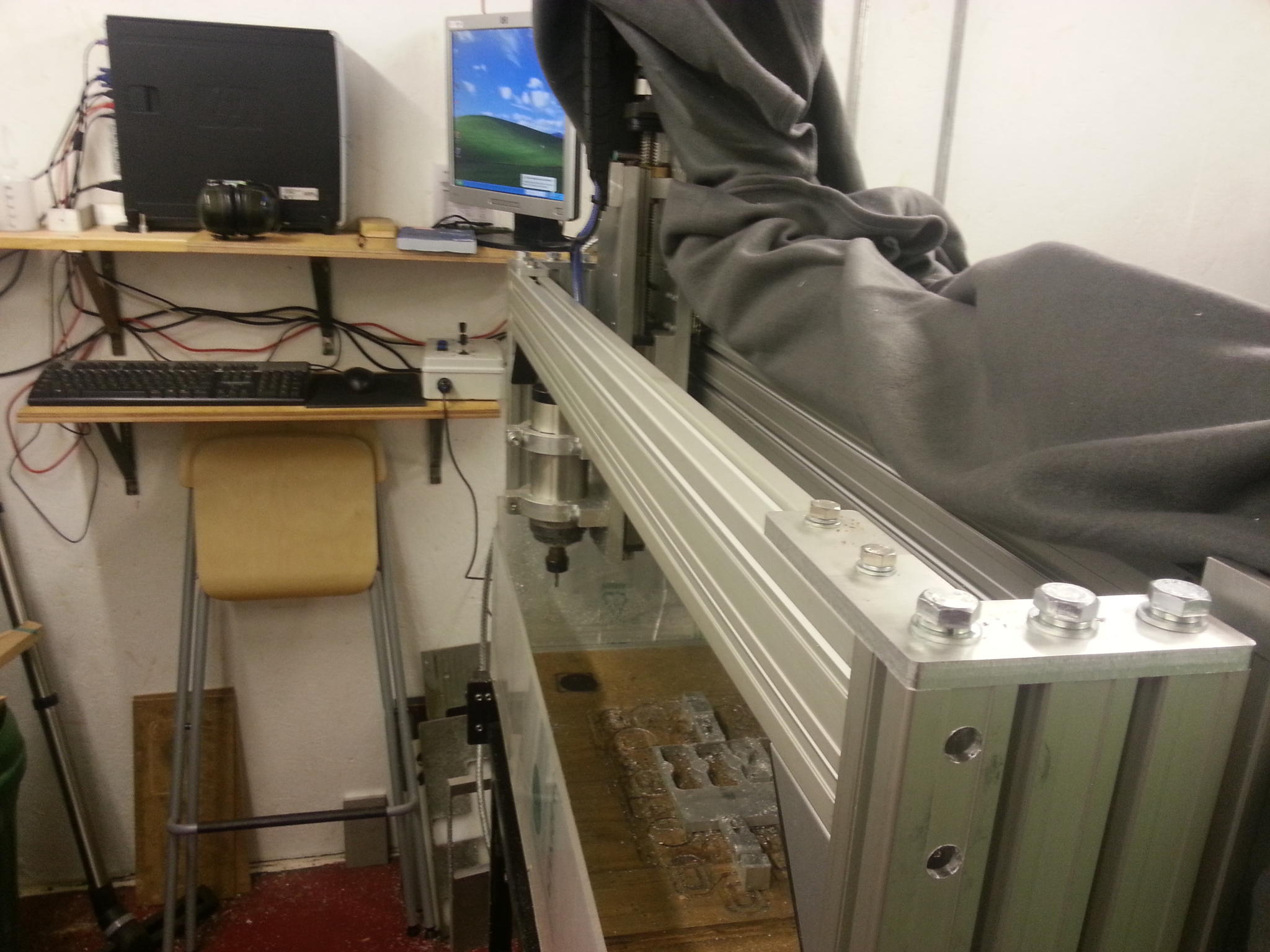

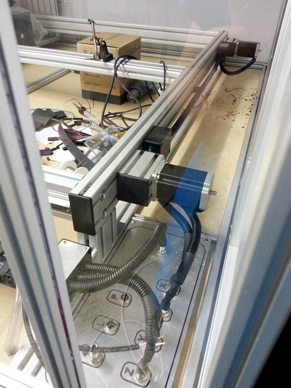

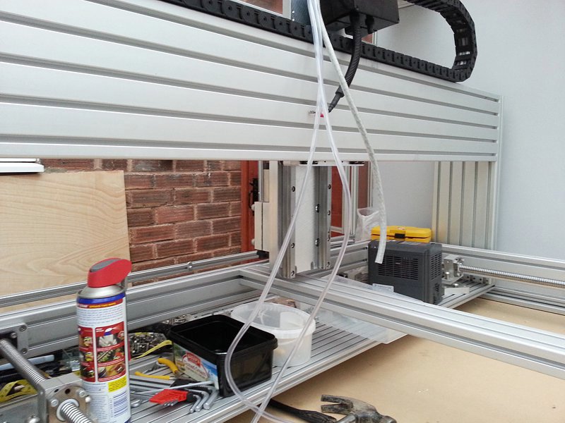

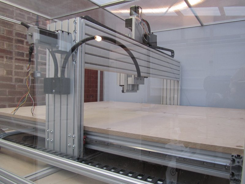

		One thing I would recommend is to add another beam across the front of the machine like this:
Attachment 7732
My build is similar to yours and I found that the machine was twisting slightly and this solved the problem. Its much more rigid now.

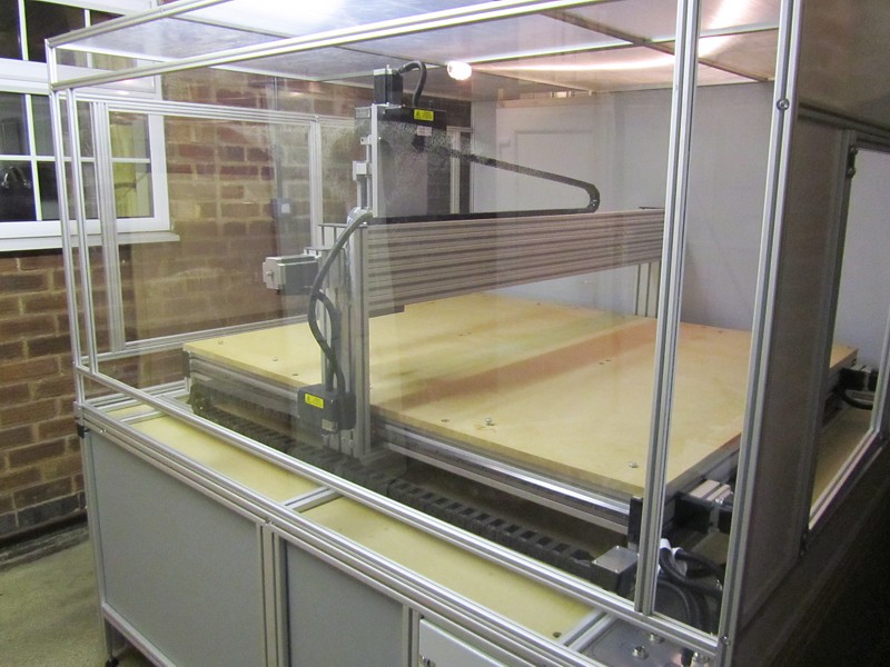

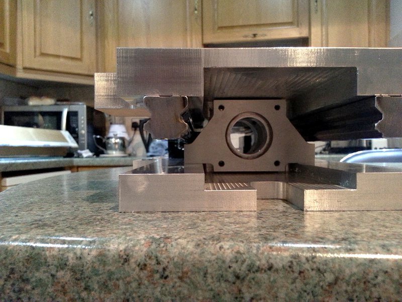

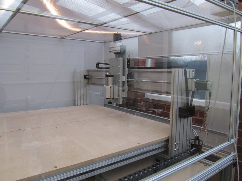

		Thanks guys.
Regarding the bed. There's plenty more support going in there along with a 10mm thick alu plate covering the 1480 x 1410 area.
