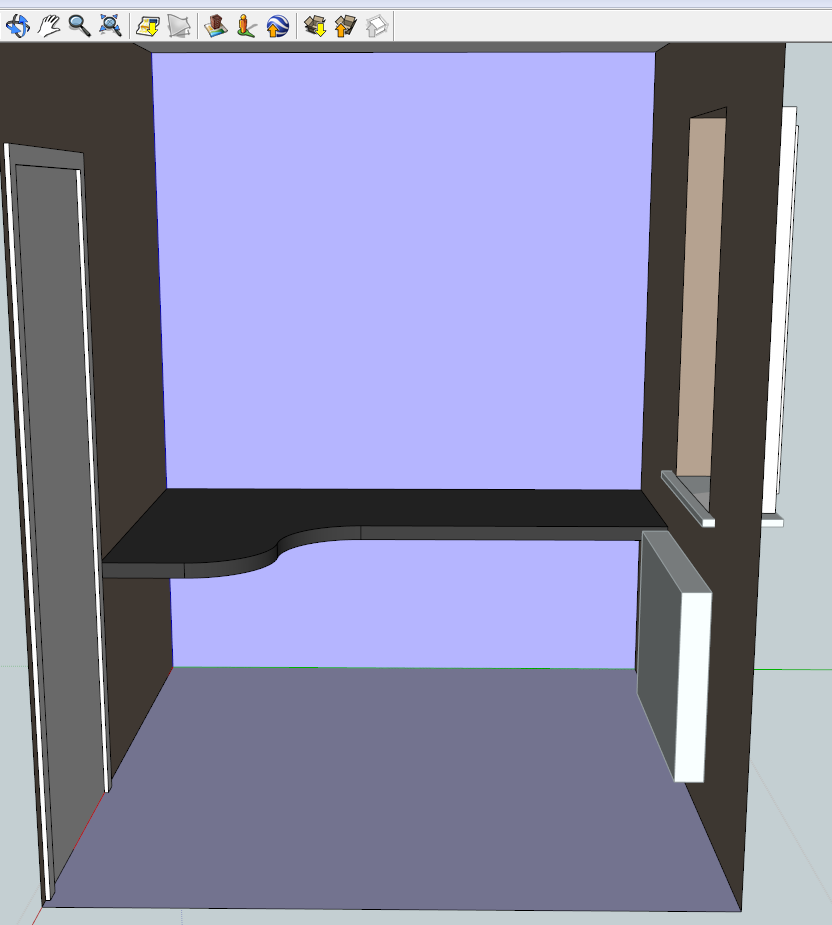

since joining this site i feel the need to plan everything out in google sketchup so i started out with this
Attachment 7733
i'd had that curved shape in my head for ages and i'll be honest without sketchup i'd have likely done it free hand with a jigsaw. but through figuring out how to acctually draw the desk with the rounded shape i realised that it's basicly 2 circles of the same radius side by side.

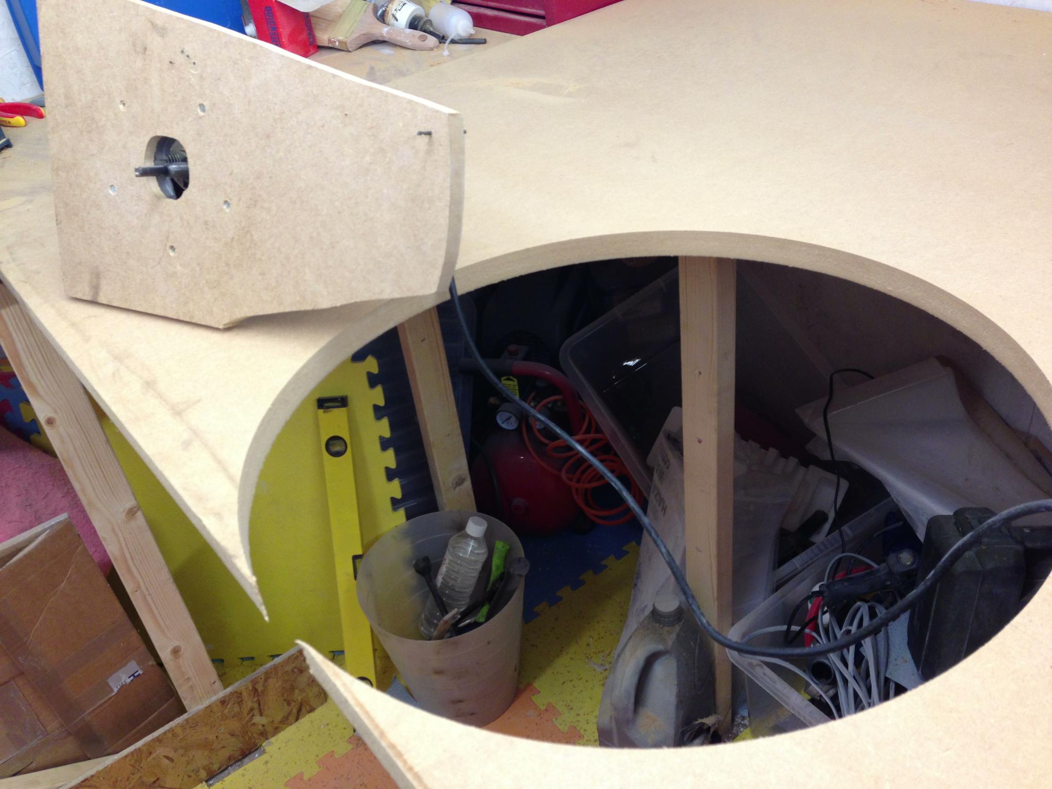

so with all measurements in hand i got out to the garage and proceed to cut the desk using my really shoddy circle jig
Attachment 7734
Attachment 7735
yes thats a piece of mdf with a router stuck to the top of it, rotating around a 3mm drill bit

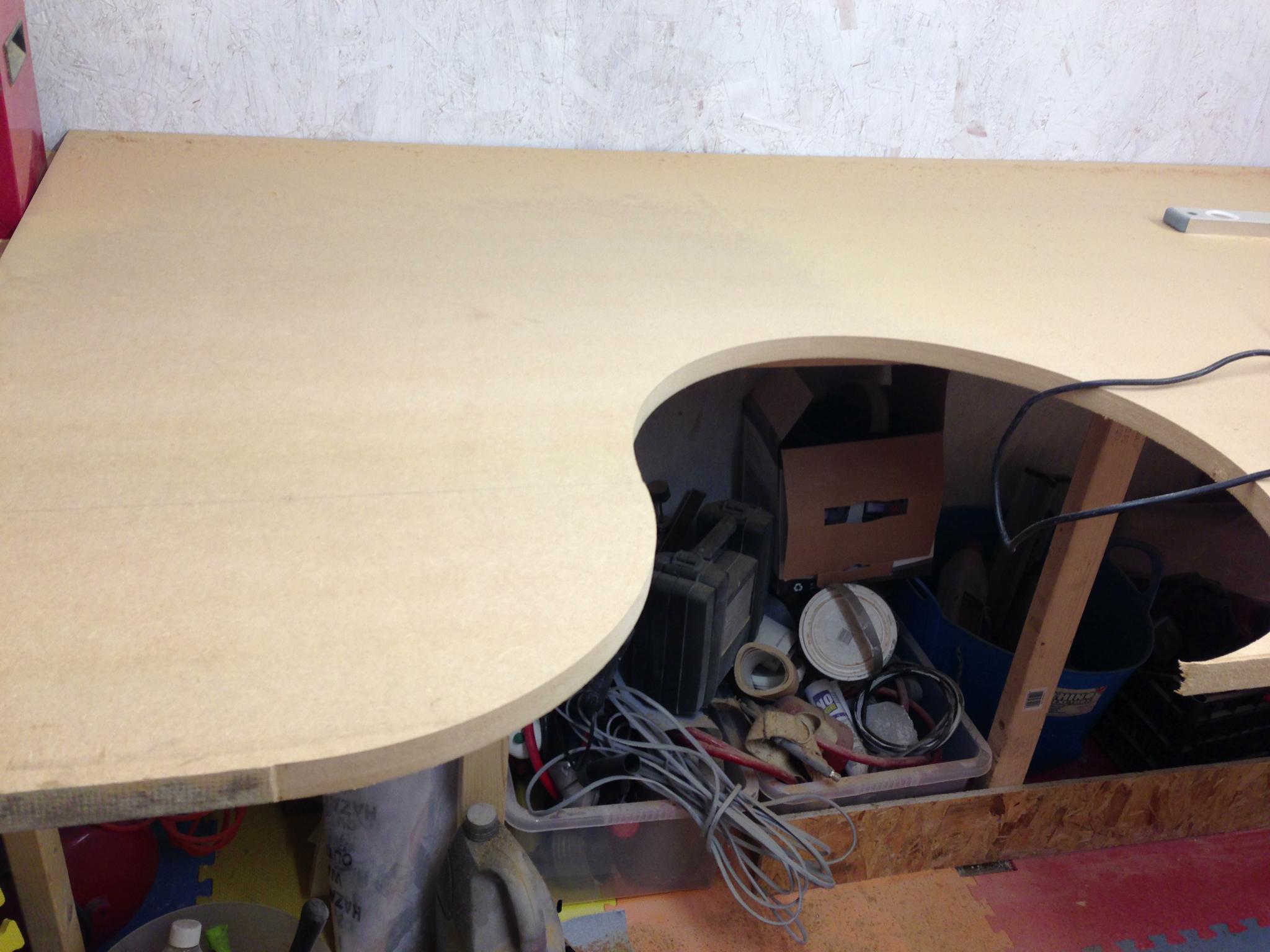

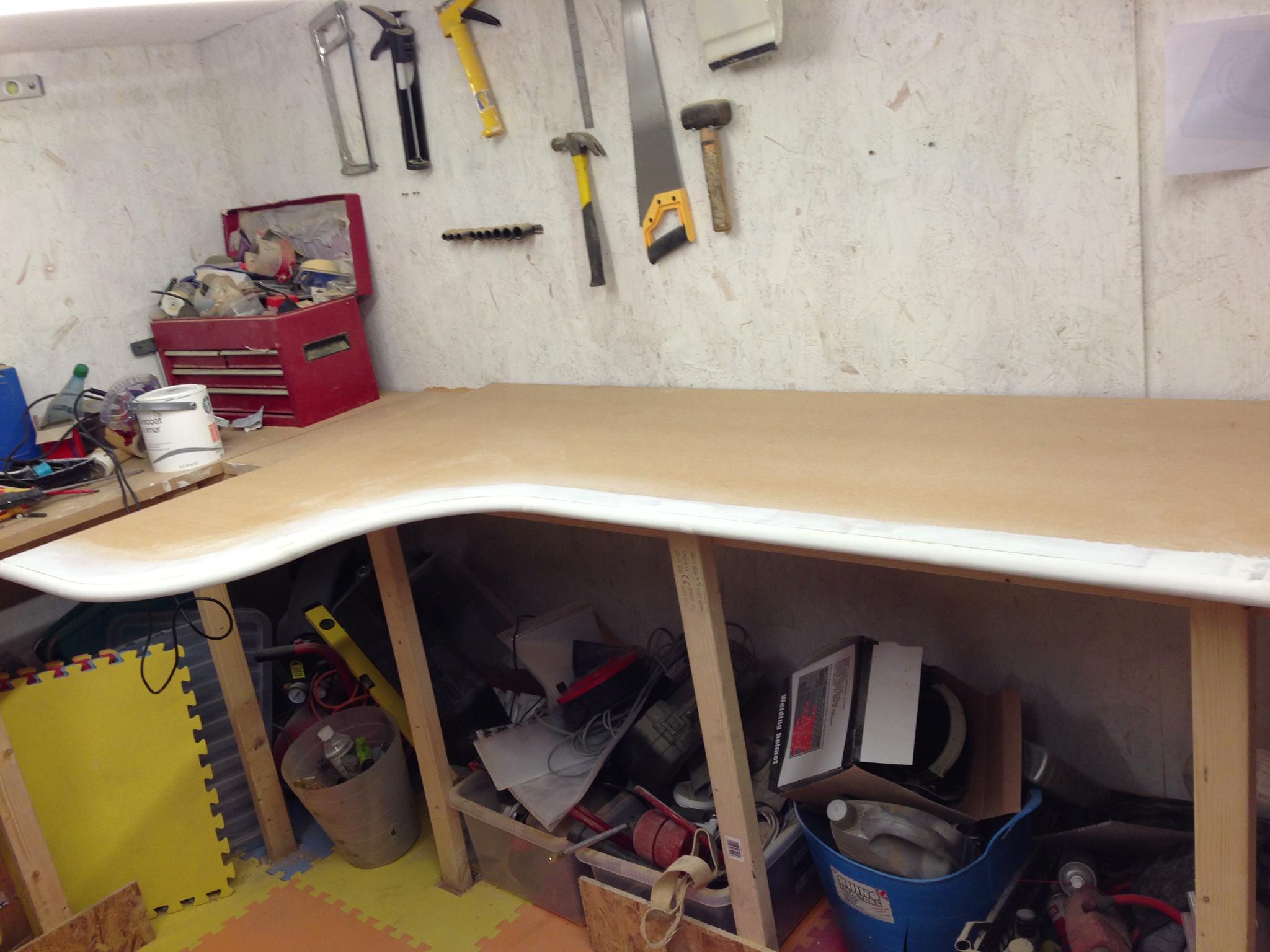

second circle to cut is only acctually a quarter of the circle and i get left with this
Attachment 7736
next i stick a straight edge under the desk connecting the circle to where the edge of the desk finnishes and run my router with a trim bearing bit all the way along and end up with this
Attachment 7737

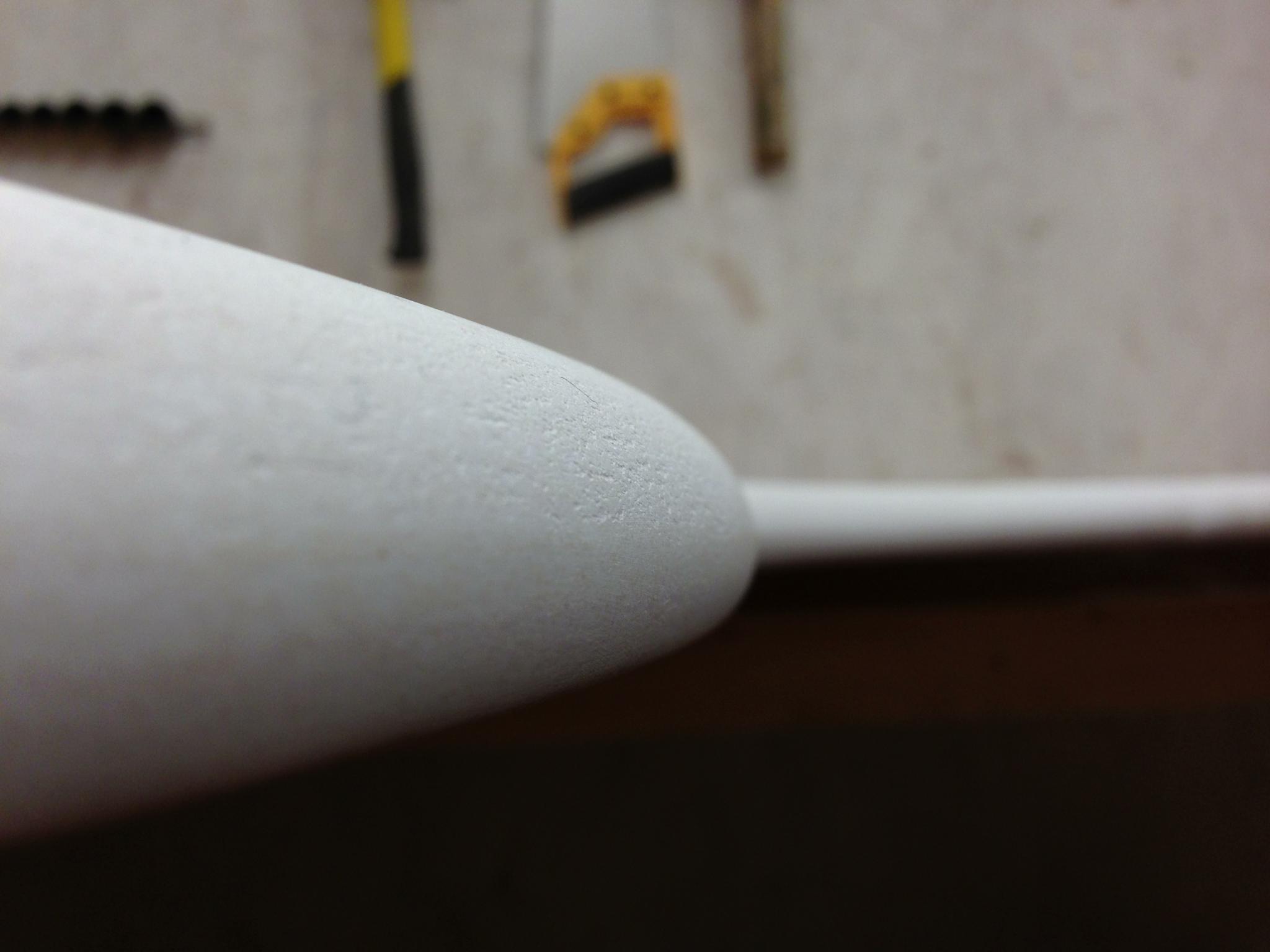

and on the edge of the desk to get a nice smooth finish all i have used is an 18mm round over on the top of the desk and a small 6mm i think round over on the bottom of the desk, the result is something i'm very proud of as i've never achieved something like this before
Attachment 7738

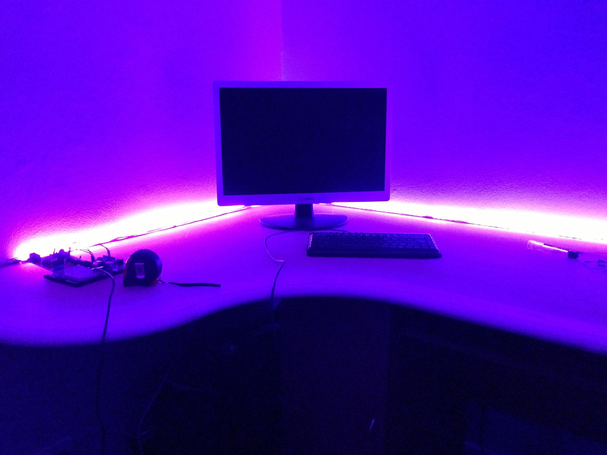

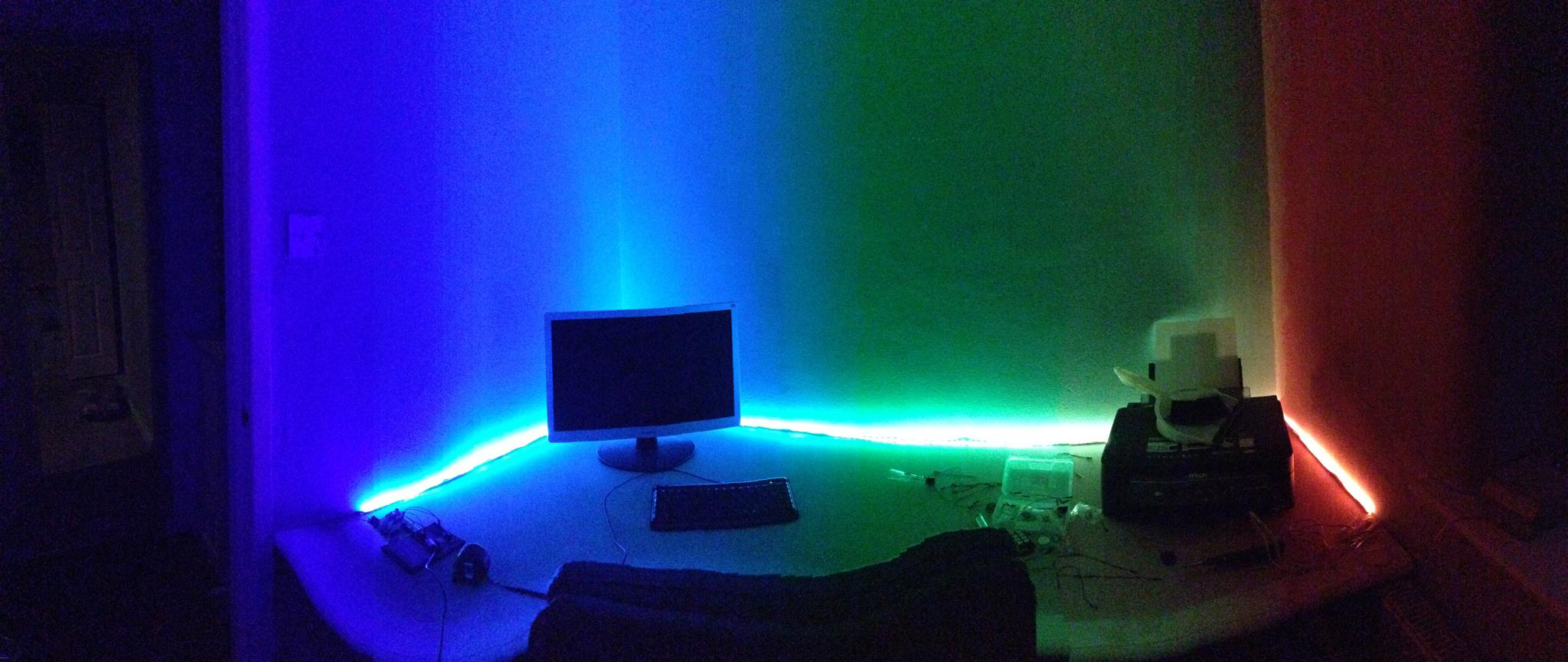

test fit the desk on top of the previous desk before i attempt to paint it.. lucky i did as the wall was out and the desk didnt fit, back outside, trim an edge down and bam fitted.. one very happy wilfy. so wanting to always better myself i've decided that i want some kind of cool lighting for this room. i've always been a fan of RGB LEDS and the effects you can achieve. so robbed a friends run of LED's to see how bright they are and more than anything to see if they will provide enough light for me to see the keyboard and other things if i need to.
Attachment 7739
Attachment 7740
on the left is an arduino we have used to rig up the rgb controls as a temp thing untill i can order my lights. my plan is to run a 45 degree router bit with bearing on it all the way round the back of the desk, this should hide the LED's from view and have no glare and we have already tested the angle and i'm happy with the amount of light produced, infact i have the lights on now whilst i'm typing this and i'm more than happy with them.
i'm going to finish the desk in black spray paint and lacquer it so i can cut and polish it back flat so i get a nice glass smooth finish.
