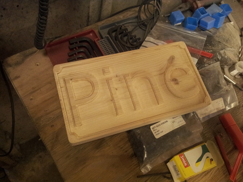

Ive presently had a lot of success with vcarve... well im pleased anyway...
Attachment 8361

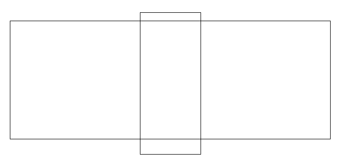

Im trying to move to the next step, and draw something in a cad package. then import it into vcarve so that I can set toolpaths. Im presently using google sketchup free with the free dxf plugin
in sketchup i draw a rectangle
Attachment 8362
i then draw a rectangle on top. (I wish to pocket this area out)
Attachment 8363

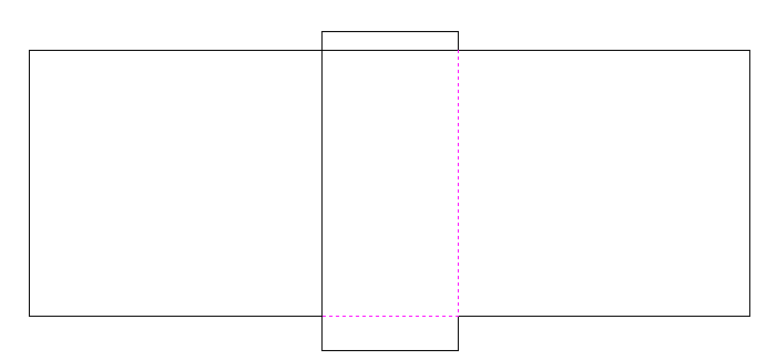

I then save it as a dxf >> milimeters >> lines
and open it in vcarve
Attachment 8364
lovely.
but when I select a rectangle it doesnt quite understand!
Attachment 8365
Ive found the 'Node Edit' options, but the only option that seems to help is to delete a point. but then i have to re-draw the line (which just isnt ideal or accurate)
Its as-if each of the rectangles dont remain vectors? Ive tried ungrouping but thats greyed out.
At the moment, it appears the only real option ive got it to attempt to draw accurately directly in vcarve. but as its missing standard tools like snap to line, center point, the ability to type in a value when using the tape measure. its a bit awkard Which is a shame because short of this vcarve seems a great bit of kit
1.) Can anybody offer any miracle solutions? here is the vcarve file http://www.pensys.co.uk/sample.crv
2.) Or, perhaps recomend a different peace of software? for doing the 2d vectors... that imports nicely into vcarve?

Not looked at your vcarve file as I don't have vcarve but if you are deleting a node & then redrawing a line it might be that the shape is not closed which will cause you problems. It will still look like a rectangle despite having 2 points that aren't joined together. Is there a close shape option in vcarve or if it has node editing functions the option to join & break apart nodes.
If you are having trouble importing the file then you could try saving in a different format, I believe vcarve will import quite a few vector formats so try exporting the design from scetch up as an EPS or PDF file.
Re: Google Sketchup >> Vectric VCarve
In node edit mode put the mouse on the line between 2 points, right click, then delete span. This would leave you with the rectangle to pocket with no lines inside. You are left with several "line" vectors and you will need to rejoin these into 1 rectangle by selecting 2 lines (shift key and click) then right click "join / close vectors", I used "Move end points"
