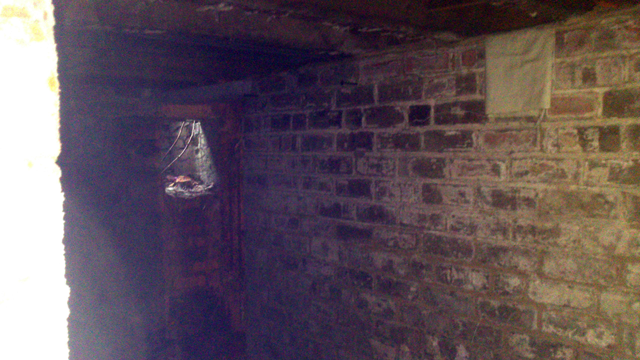

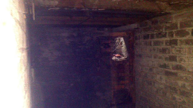

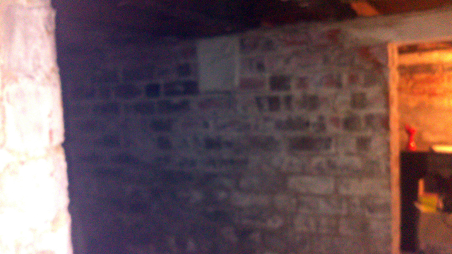

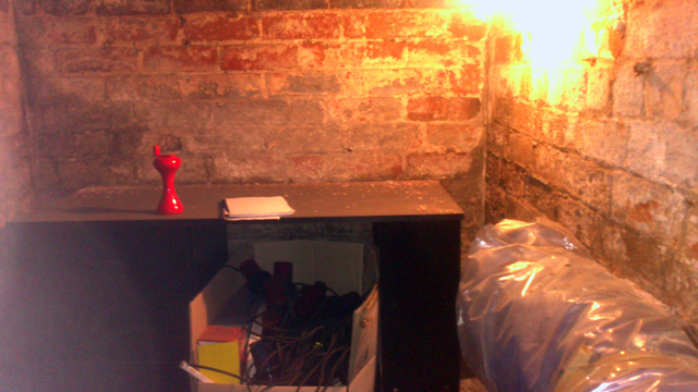

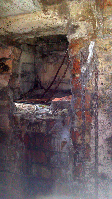

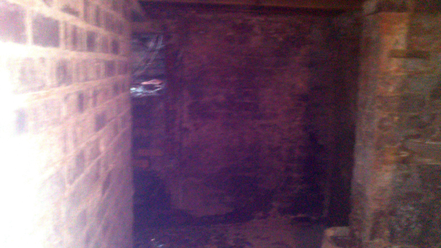

I've had to change plans for a number of reasons and I'm now working on the basement to make it usable. This solves a number of important problems in terms of access and weight (not really a problem for a basement, compared to the original attic location!)

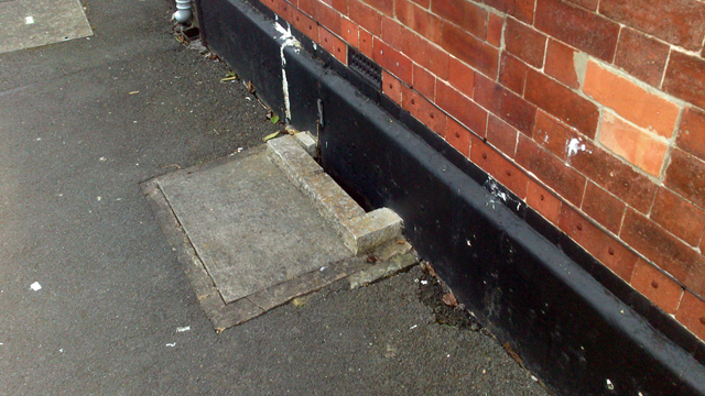

It's a standard Victorian-ish end terrace with the old coal chute partly open for ventilation, leading directly to the pavement outside the house. Some very minor water entry through the gap that I should be able to tackle, though as it provides ventilation under the floorboards I won't seek to block it. The basement, though neglected and cruddy, seems fairly dry and doesn't have any smell of damp that would concern me. The floor appears to be concrete and there is electrickery available.
My plans have always included a completely over-the-top enclosure to keep the noise levels down as far as possible while still shifting heat away safely. This will become more important now as the living room is directly above.

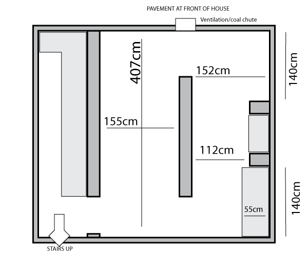

To my mind currently, the biggest (or smallest) problem is that the height from floor to the bottom of the joists is approx 170cm - while I'm approx 185cm tall :numbness: I'm planning on having everything at a good height for working seated!

Attachment 8466
The Chute

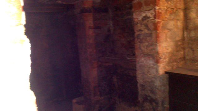

Attachment 8458Attachment 8457
The middle section taken from near the stairs

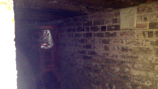

Attachment 8463Attachment 8464Attachment 8465
The far right section taken from near the bottom right corner
Attachment 8460Attachment 8461Attachment 8462

By the looks of your pics the walls have the white flakey stuff efflorescense so its probably best to go for a breathable paint.

I gave the whole thing a quick once-over with a stiff brush and cleared the detritus from the vent, even that little bit of work makes a heck of a difference! There is some very clear efflorescence on part of one wall (just the top part though, the bottom part looks very clean. A lot of the white stuff appears to be some kind of flaking paint, it's almost like it was given a very light wash of something.

I used to srt a lot of this stuff out in a past life. To save you a ton of hassle i tank the whole lot out. You have signs of moisture on those walls and they will bite you later. In terms of ventilation, i will assume you have modern central heating in the house. You can minimise that a bit and get away with a couple of air bricks either end of the house. The breathable membrane is this stuff
Tanking Membrane 20m | Twistfix
you can use silver sided plasterboard straight over the top in battens and some thin insulation behind it. As for the floor above i would go for some insulation in between the joists and plasterboard over the top of that. The floor could be quite expensive if you want a good job done where you will need an epoxy dpm once you key the surface which would allow you to use a waterproof latex based leveling compound which you can add any type of covering you like.
