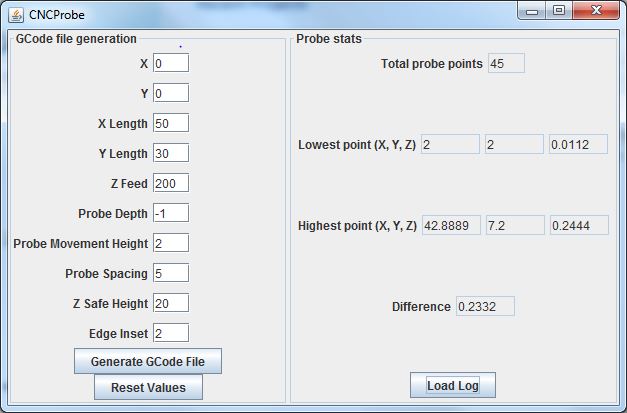

Here is a screenshot of said software after loading the log file:
Attachment 8571
This tells me that there is more than 0.2mm difference between the highest and lowest probed points.

The steps to use are:
1. Fill in the fields on the left with desired values for probing the area and click on "Generate GCode File". Save the file.
2. Load and run the GCode file in linuxCNC (Not sure if it works in Mach3 or anything else). Allow the file to finish probing (This generates a log file with the logged coordinates).
3. In the software click "Load Log" and select the newly generated log file. This will display useful information about the probed area.
