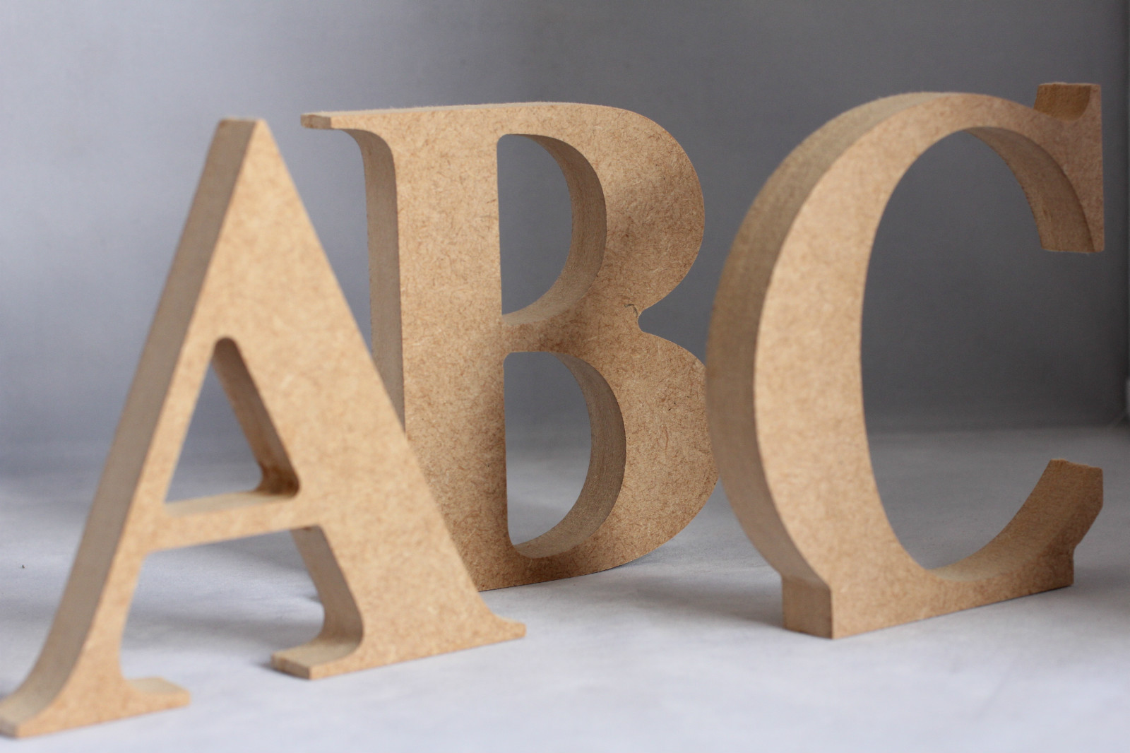

		Hi could some one please help me i am trying (but not doing very well) to find a font that i can cut out letters out of 18mm mfd so they can stand up on there own.is there a font out there? also i want to cut a name out again in mdf but i want all the letters to be together as one thanks very much if someone can help me or point me in the right direction

		Hi martin they are going to be 12" tall 18mm mdf i have seen a photo of letters that stand up but i cant find the font anywhere

		If you post a picture I can probably tell you what they have used, I'm guessing a square type font. At that size they aren't going to be very stable though if only 18mm deep. Certain letters like "F P T V" may not work unless modified. You sure they didn't have a support behind them or a peg pushed into the ground.

		Attachment 8601
hi here is what  i am looking for

		That's just times roman with a flat added at the bottom, you could do that to just about any font you want. You just need to modify it in the cad software you are using, simple enough to do.

		hi thanks for getting bk to me i know what you are saying but i am new to this not sure how to do this the letter are G and J i try ed to to add a bit to the letters in vcarve pro but it dont look right at all

		Why can't you use any suitable font and then just change the outlines to geometries and then modify the bottoms to make them freestanding. the same applies to linking letters together to make words. If necessary I can draw something for you to show what I mean. Martins point about centre pieces would of course still apply and you would have to include supports or styalise the font. G.
