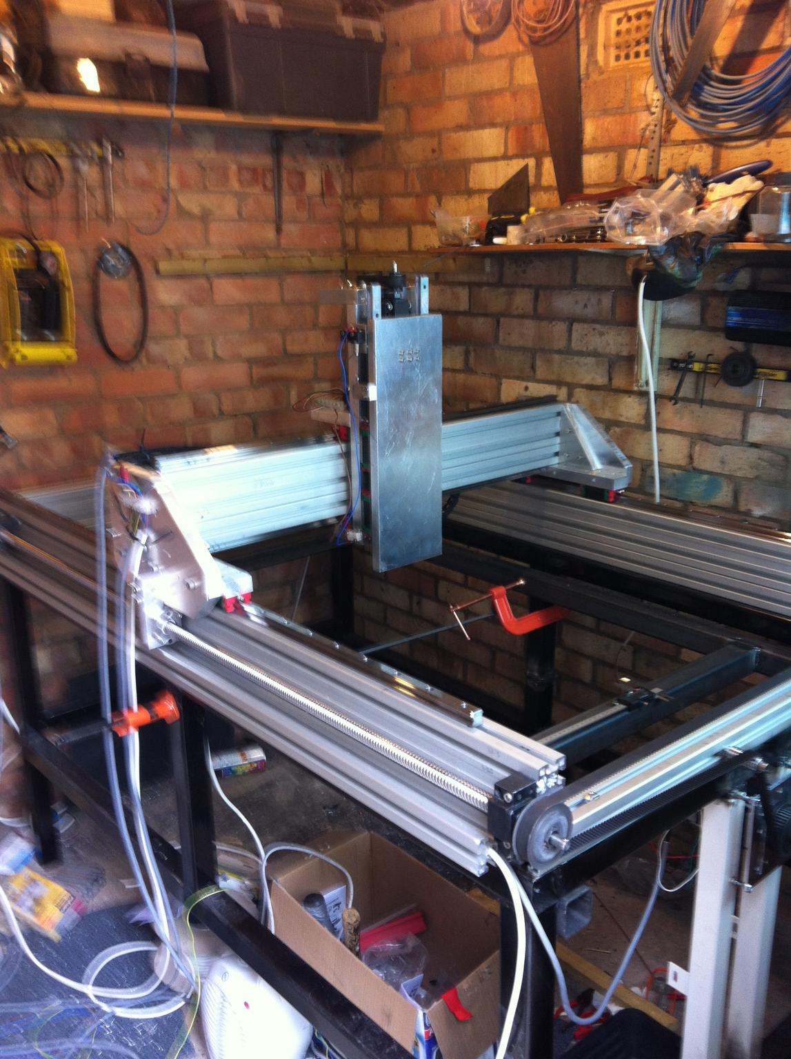

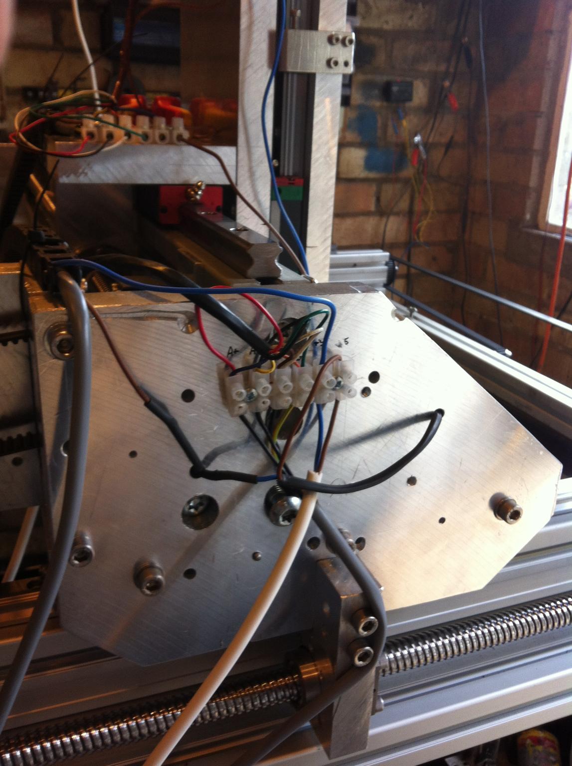

		Hi all

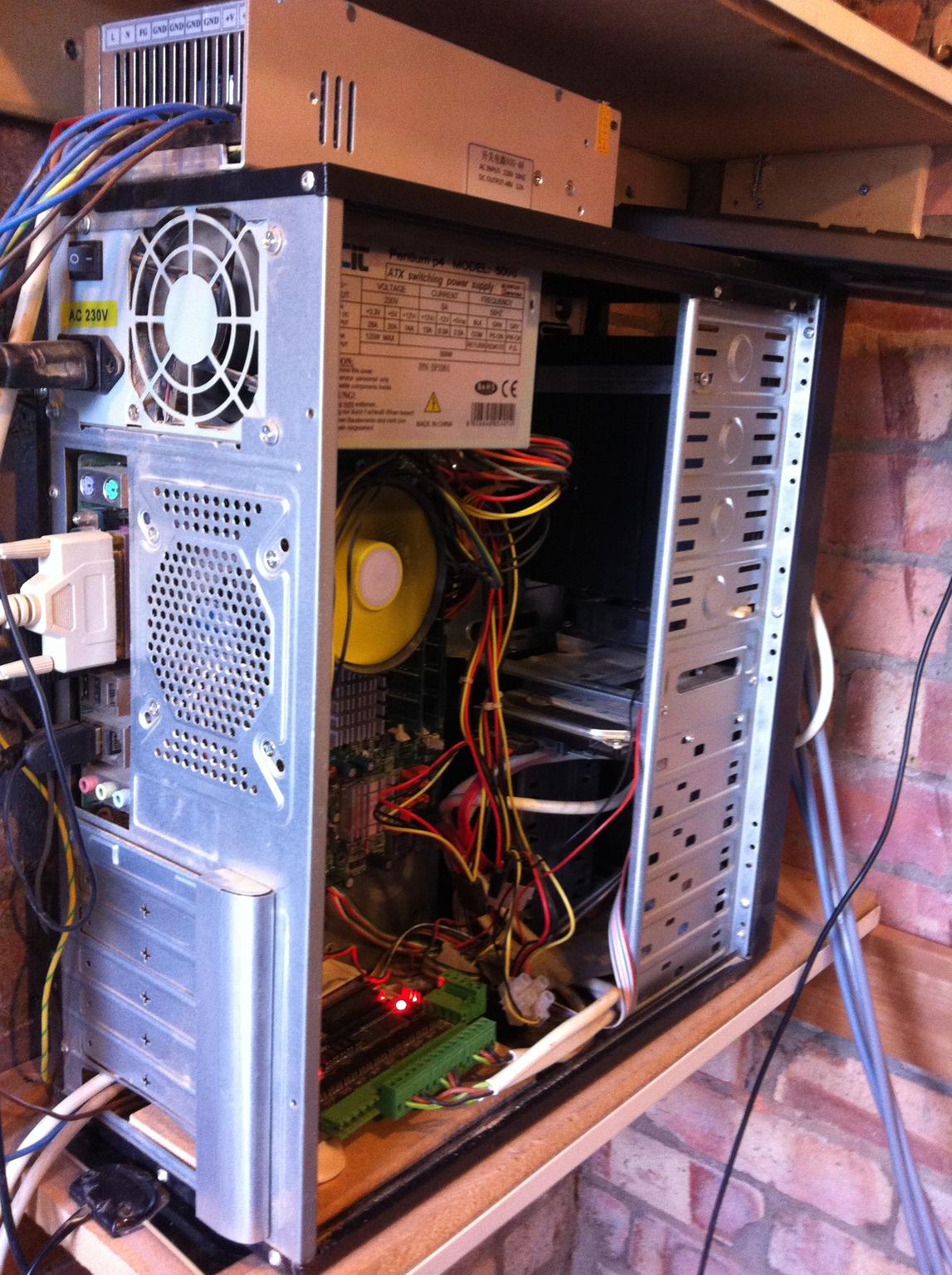

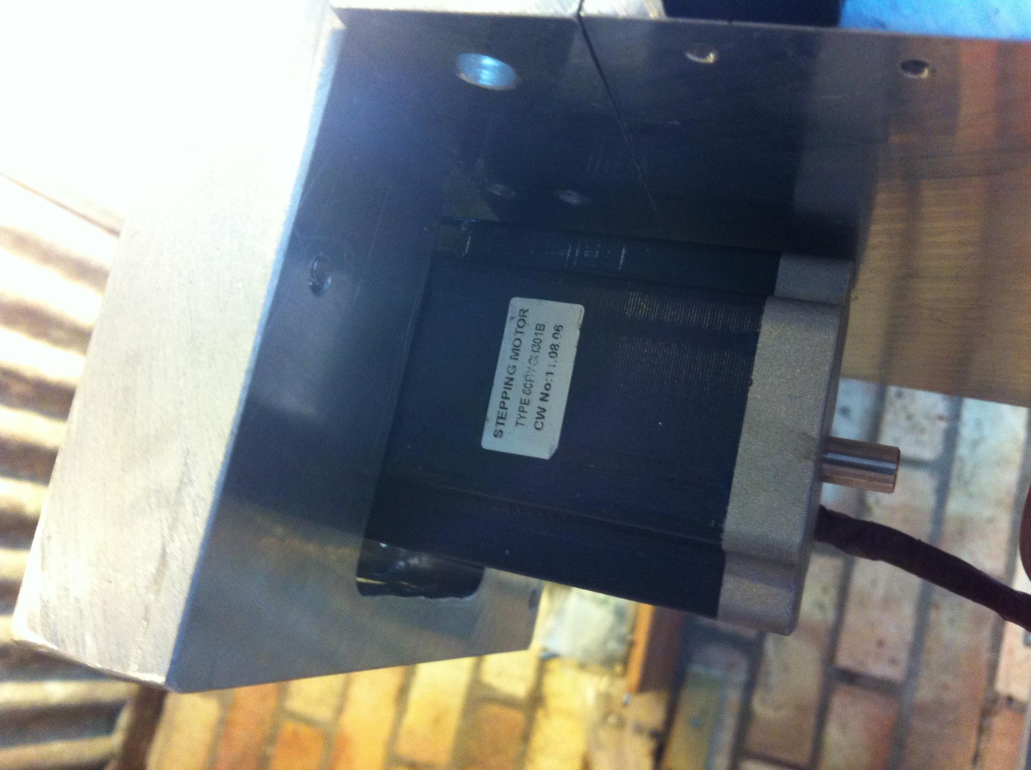

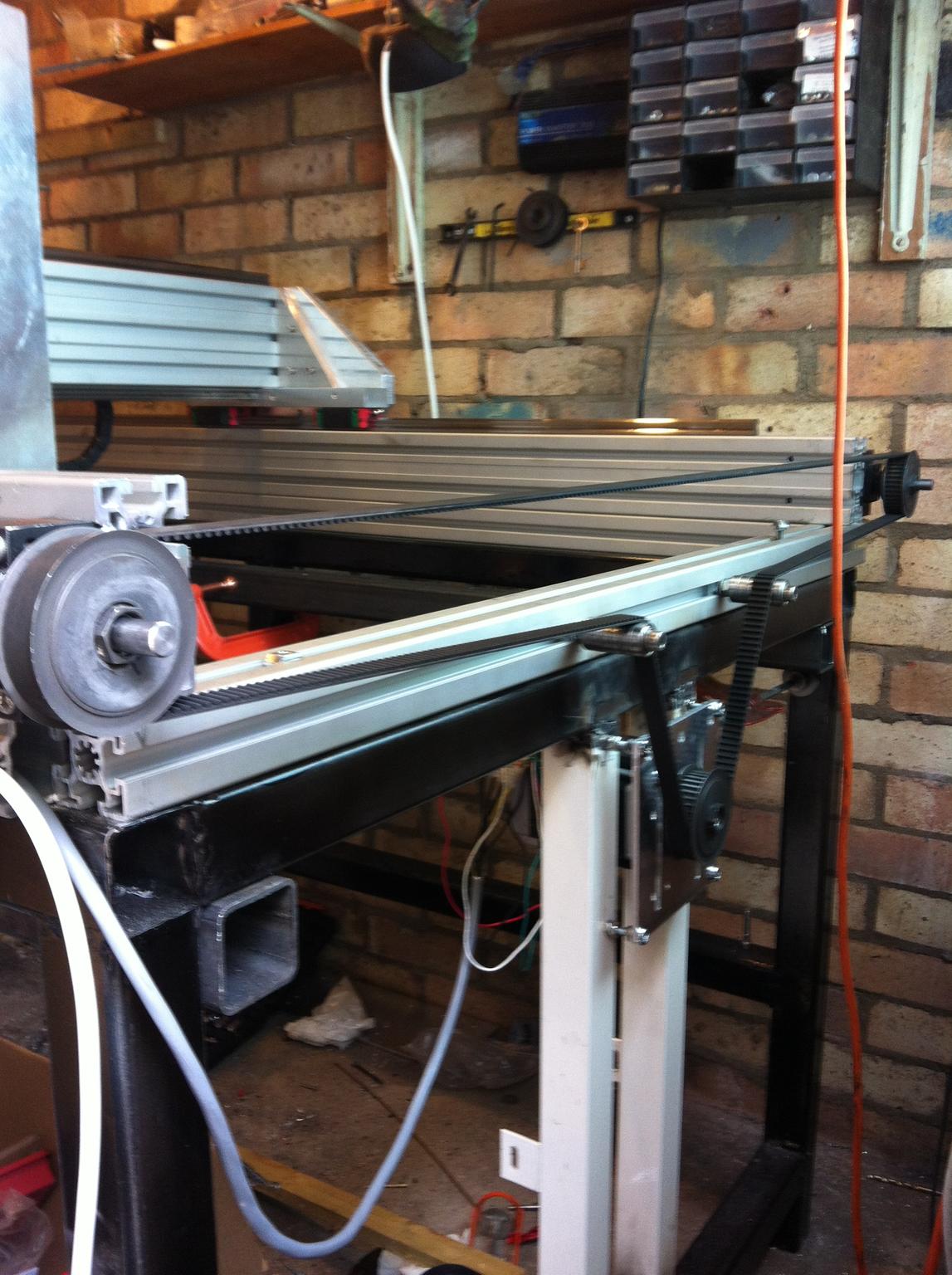

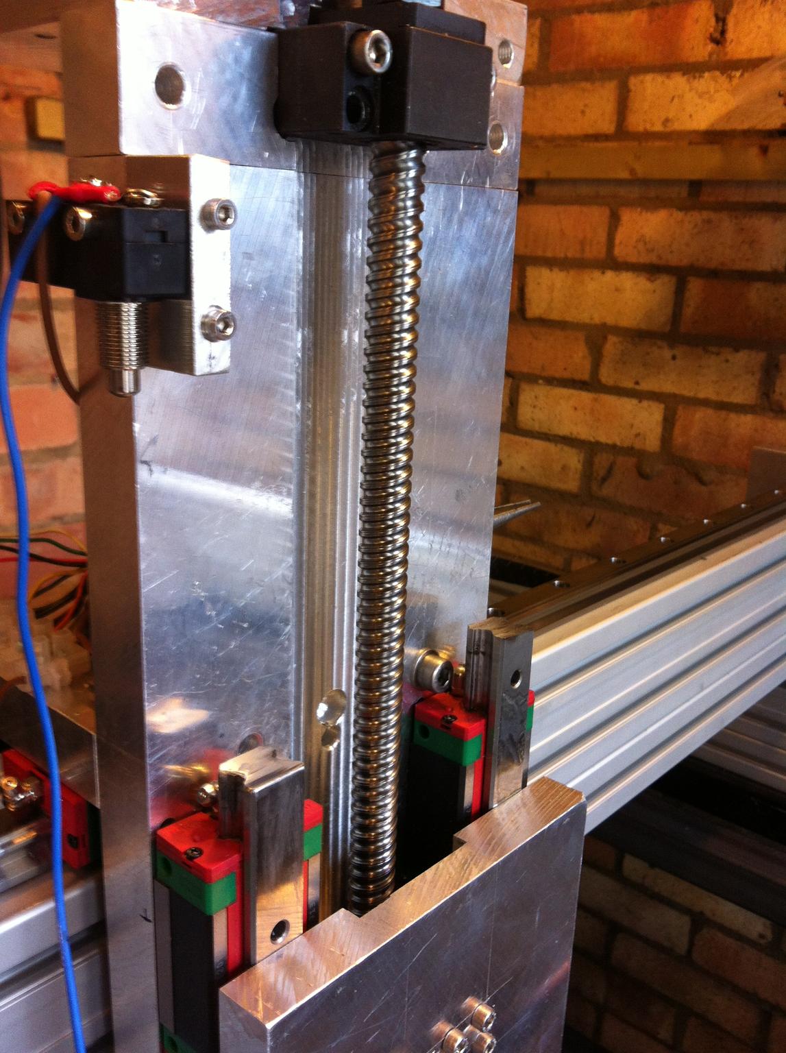

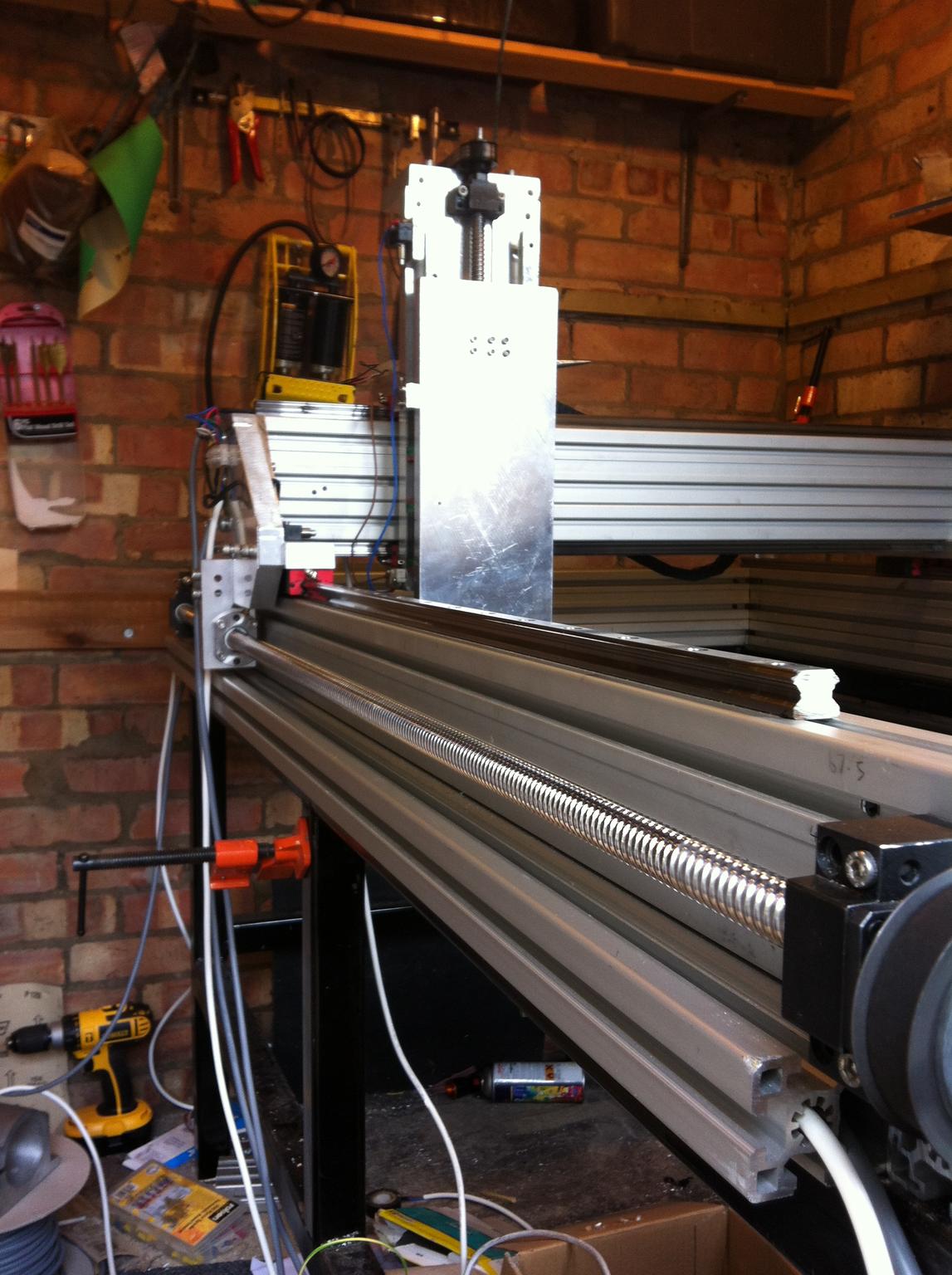

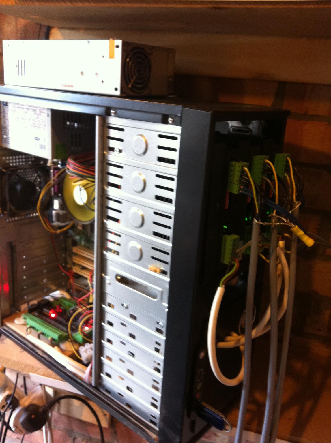

    i have a odd problem with my latest build.
i am having problems with traversing smoothly.
my system is as follows
X axis -two RM2010 ballscrews 1500mm long, belt driven (one to one ratio 40 tooth HDT pulleys)
from single 8.7nm nema34 stepper, hiwin 20mm profile rails, CW8060 stepper drivers, 50v 600w power supply.
 now from the  motorcalc spreadsheet my max rapid is 3800mm/min
i have set up all the various parameters pins/ports ect.
 now thw crunch.......

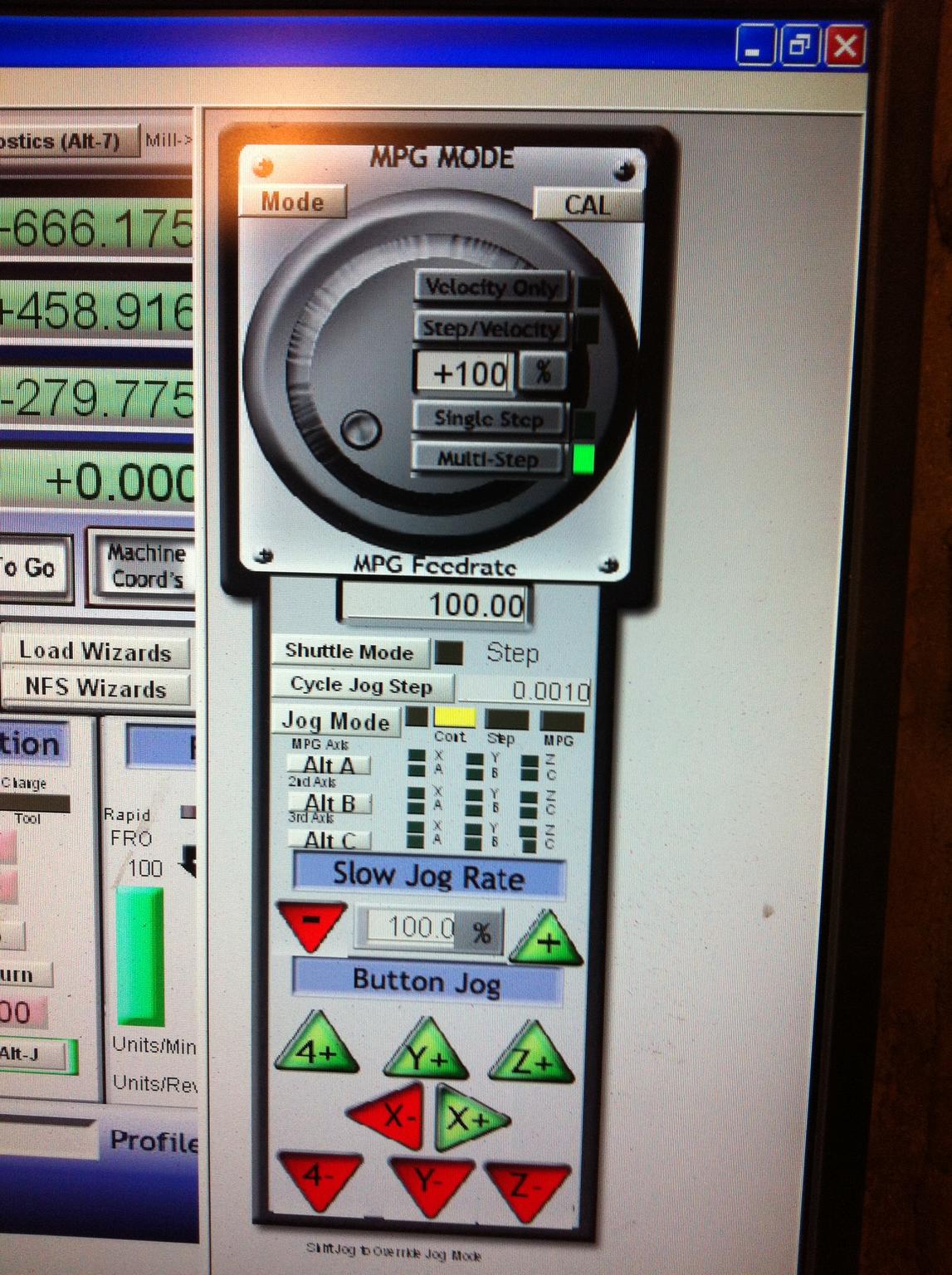

  in the motor tuning screen steps are set to 40 steps/unit
 at 3500mm/min the carrage moves smoothly with little noise  PERFECT........... BUT........
as soon as you save and go back to the main screen and try to traverse it stalls out and is very jerky with a lot of noise from the stepper motor.
it does this on all axis traversing from the keyboard or running gcode.
   go back into motor tuning and its smooth as smooth again.!!!!!!!!!!!!
iv been through the Mach3 manual searched the forums but have not found anyone else having ths problem.
   im hoping someone has had this problem and knows how to solve it.
heres a link to a shakey video i took(mobile phone) problem cnc - YouTube

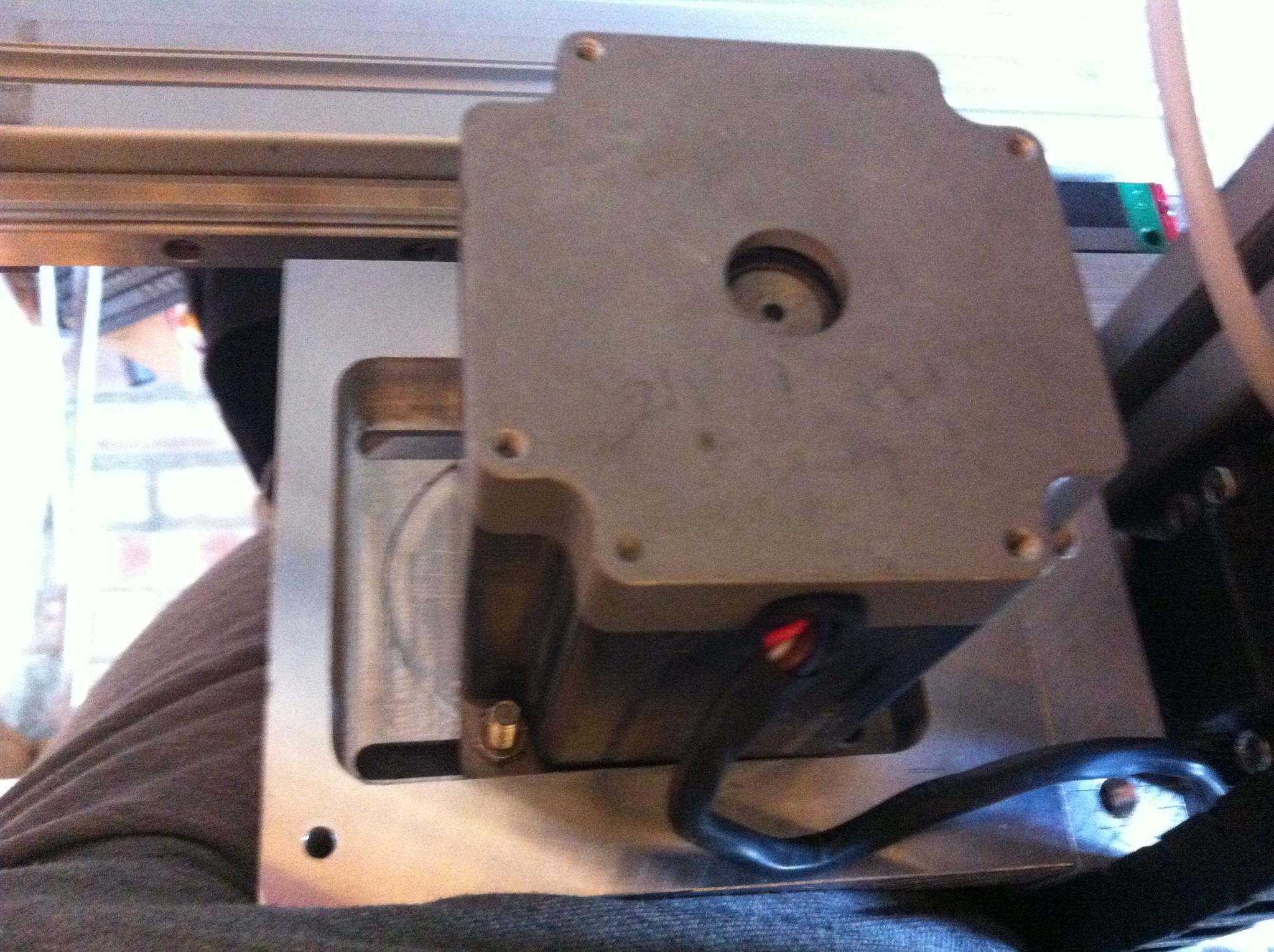

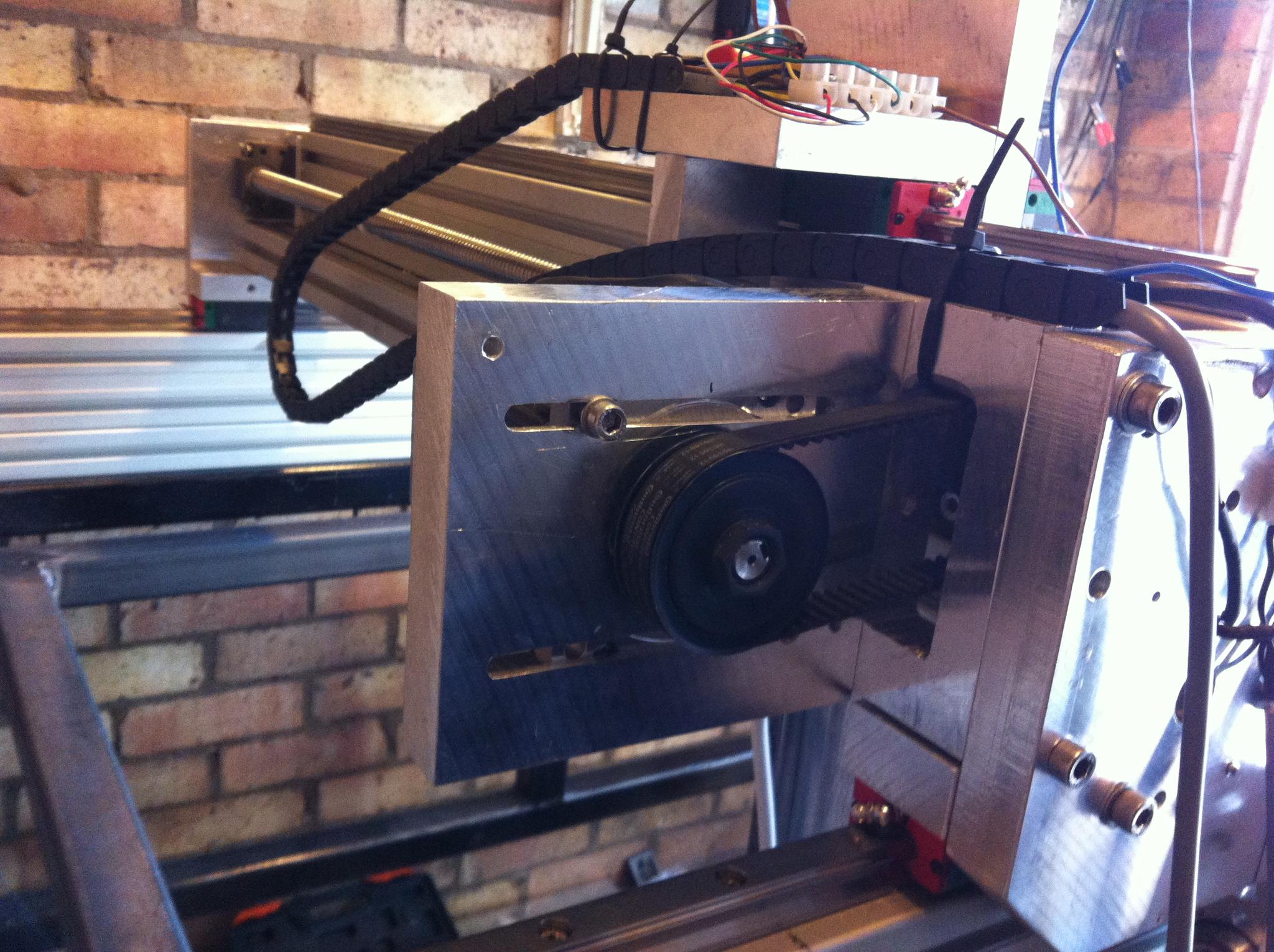

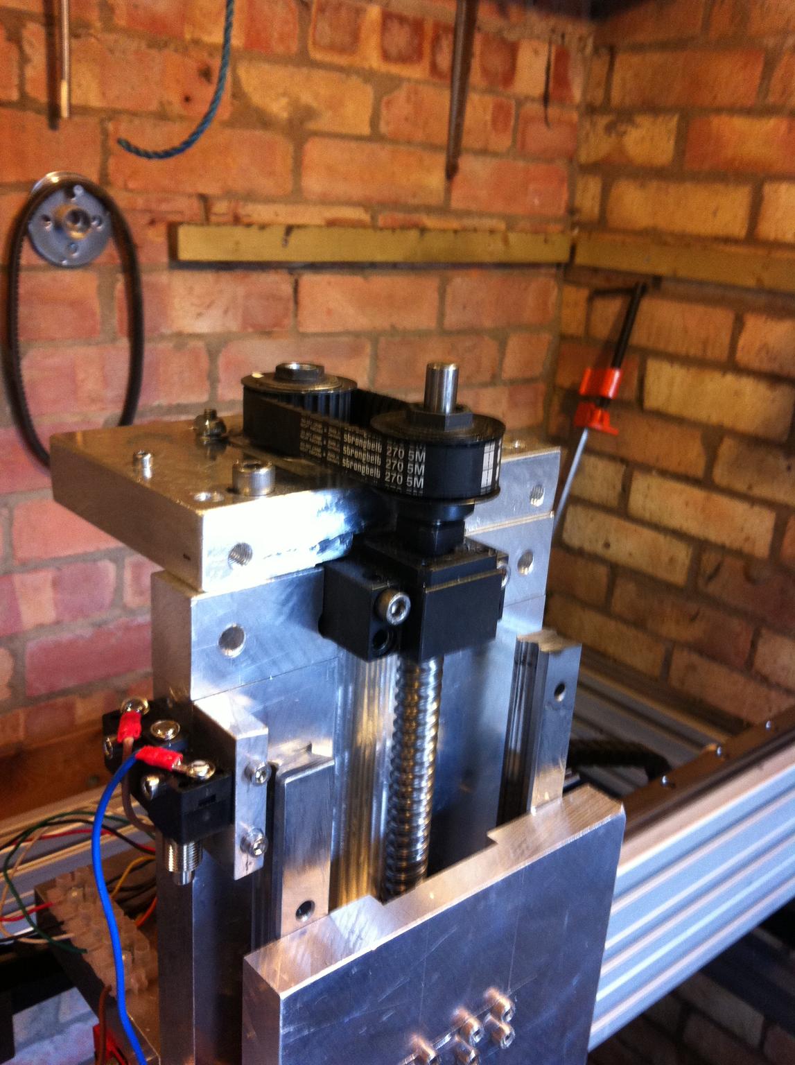

heres a few photos (i will get round to a build log soon)
Attachment 8894Attachment 8895
Attachment 8896Attachment 8897Attachment 8898Attachment 8899Attachment 8900Attachment 8901Attachment 8902Attachment 8903Attachment 8904Attachment 8905Attachment 8906
                                                         Thanks all

		Listening to that vid your velocity is too high. Post up your settings from Mach, do you have your feed over run set high? i don't use Mach3 myself

   Having tried everything i could think of including deleting and reinstalling mach3, running the pulse testing again (excelent) i decided to try a different PC and wow what a difference.
beautifully smooth traversing right up 9000mm/min
 it must have been a hardware fault or was being interupted by something else.

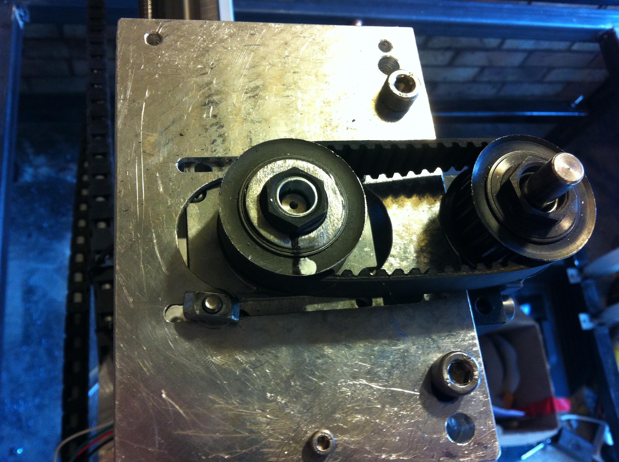

  the 40 tooth test gear i bought was made of alluminium so the weight was well dowm but when i went to order them i found that they were not available in ally in HTD.
 i have cut the boss off the back of them to suit the lenght of the Translock mini locking bushes im using to hold them to the shaft. (iv marked them up to see if they slip but they shouldent as they are rated at 39Nm wich is over 4 times the torque the motor can give out)
