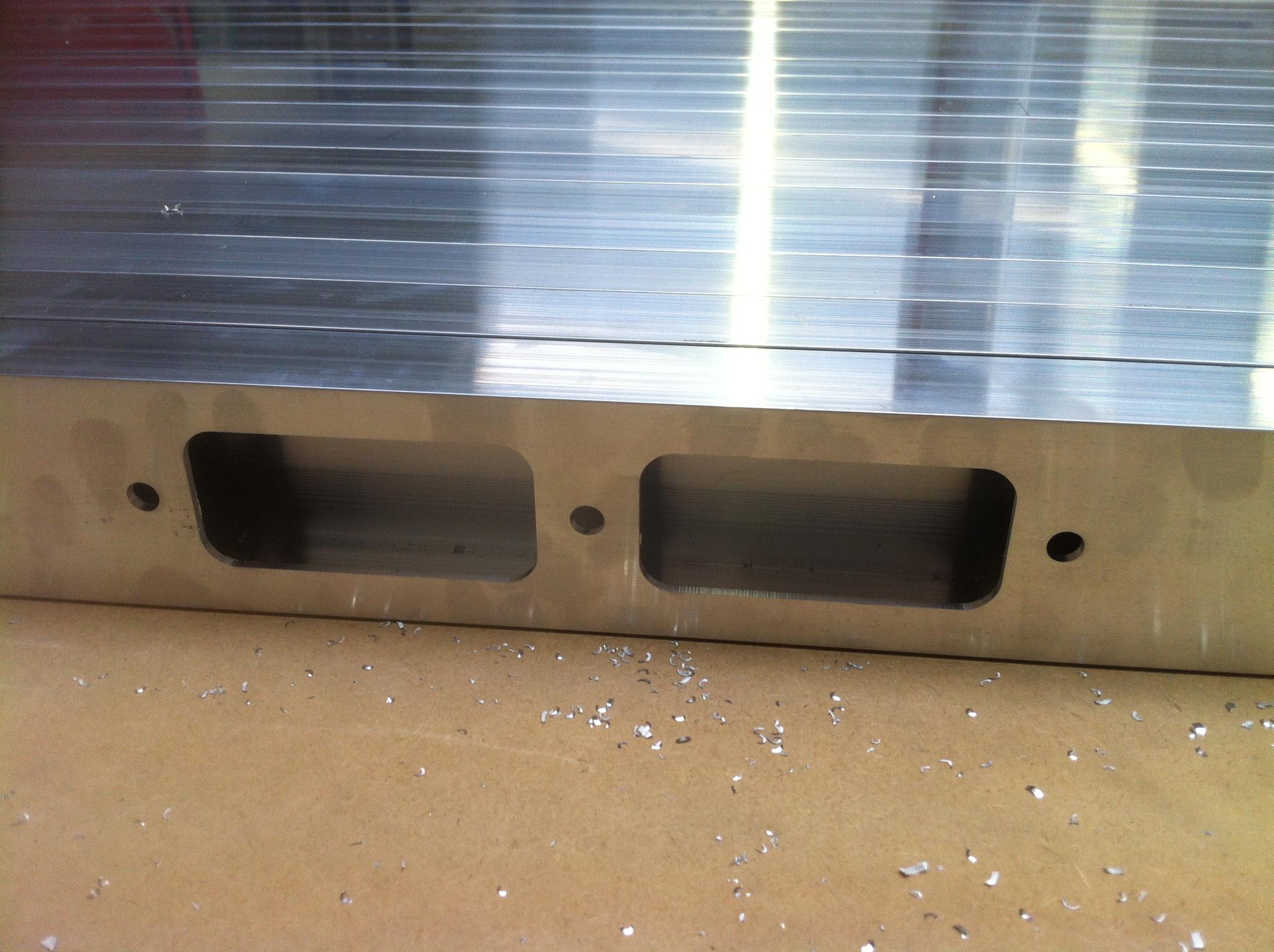

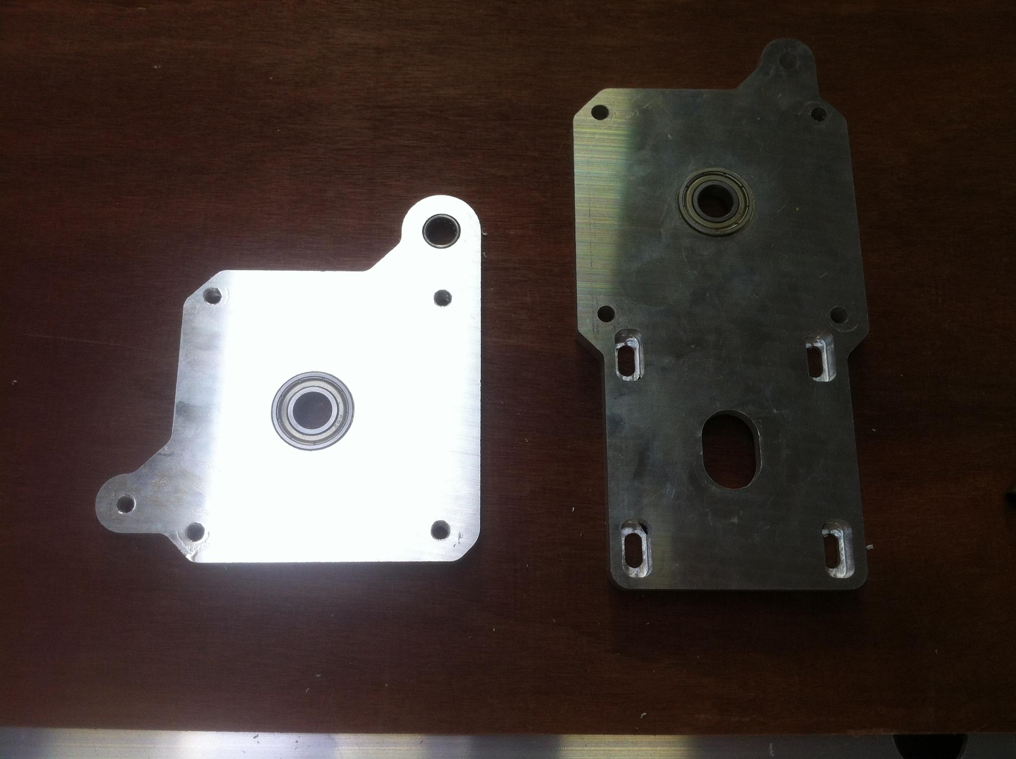

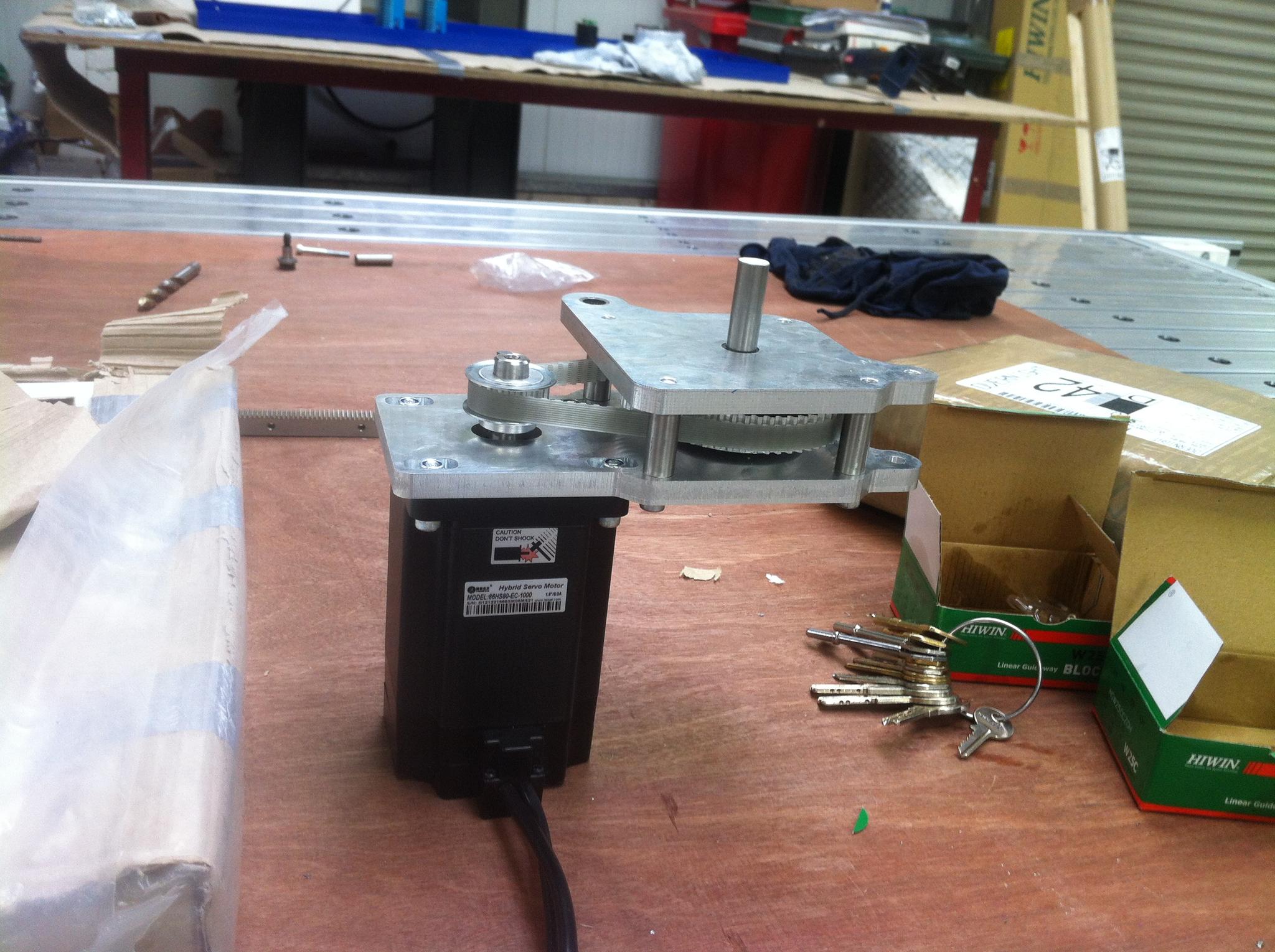

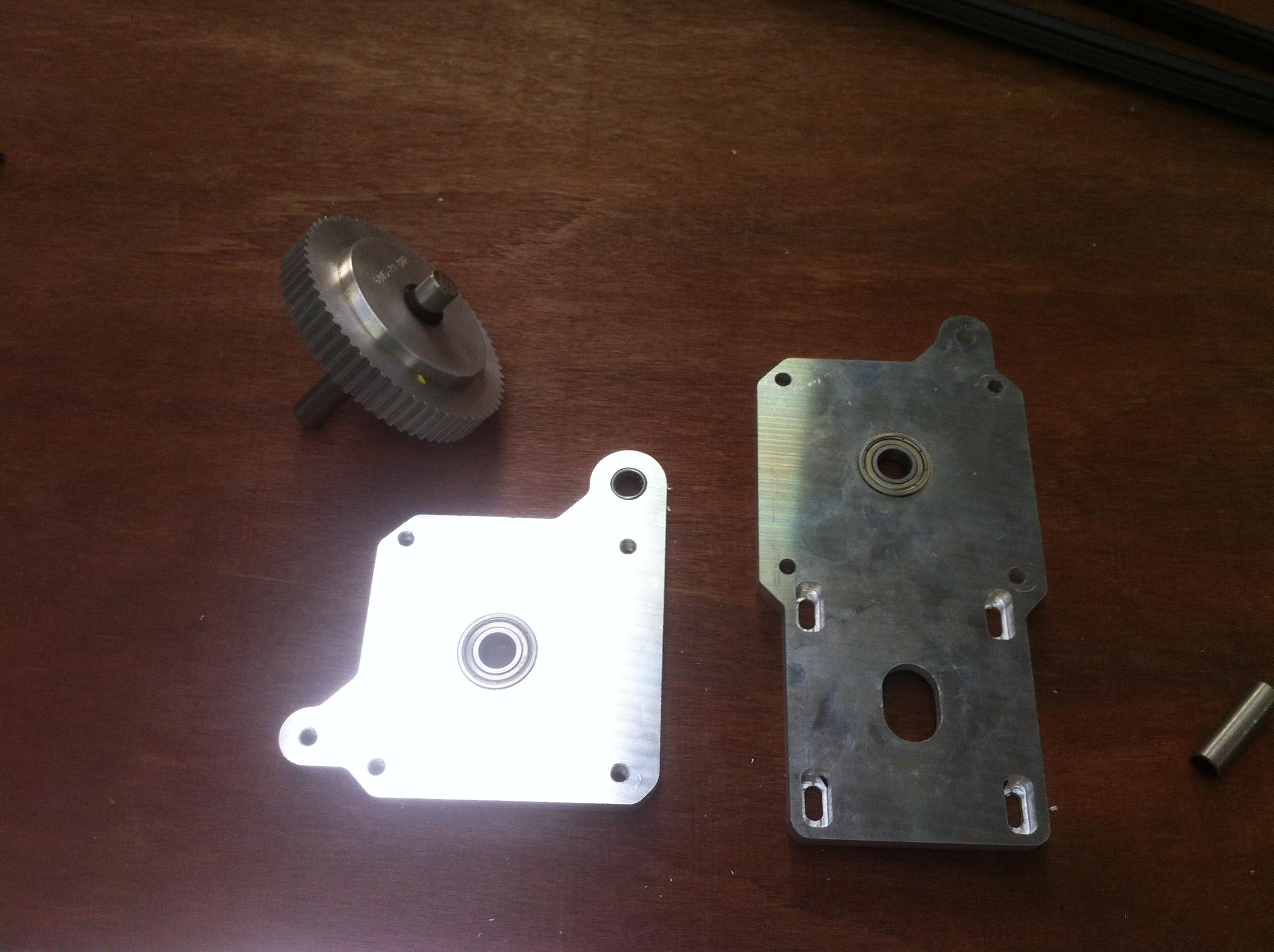

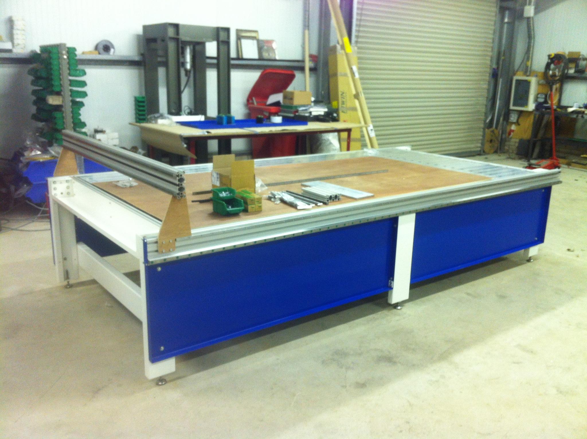

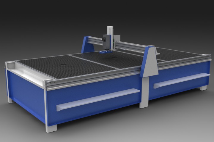

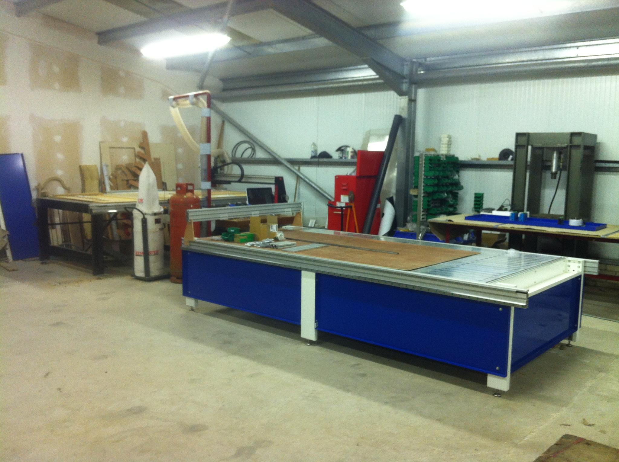

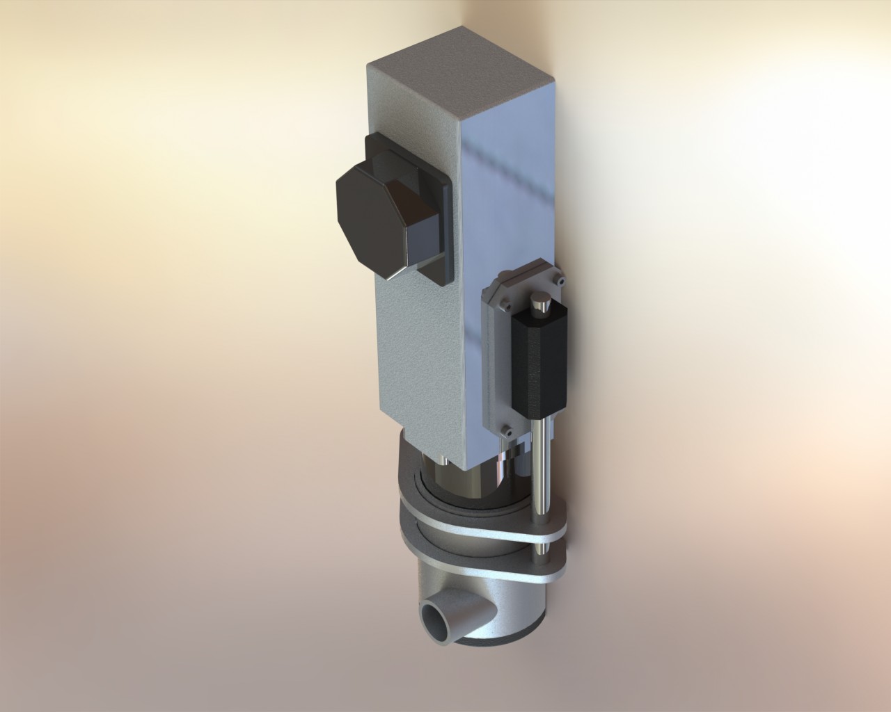

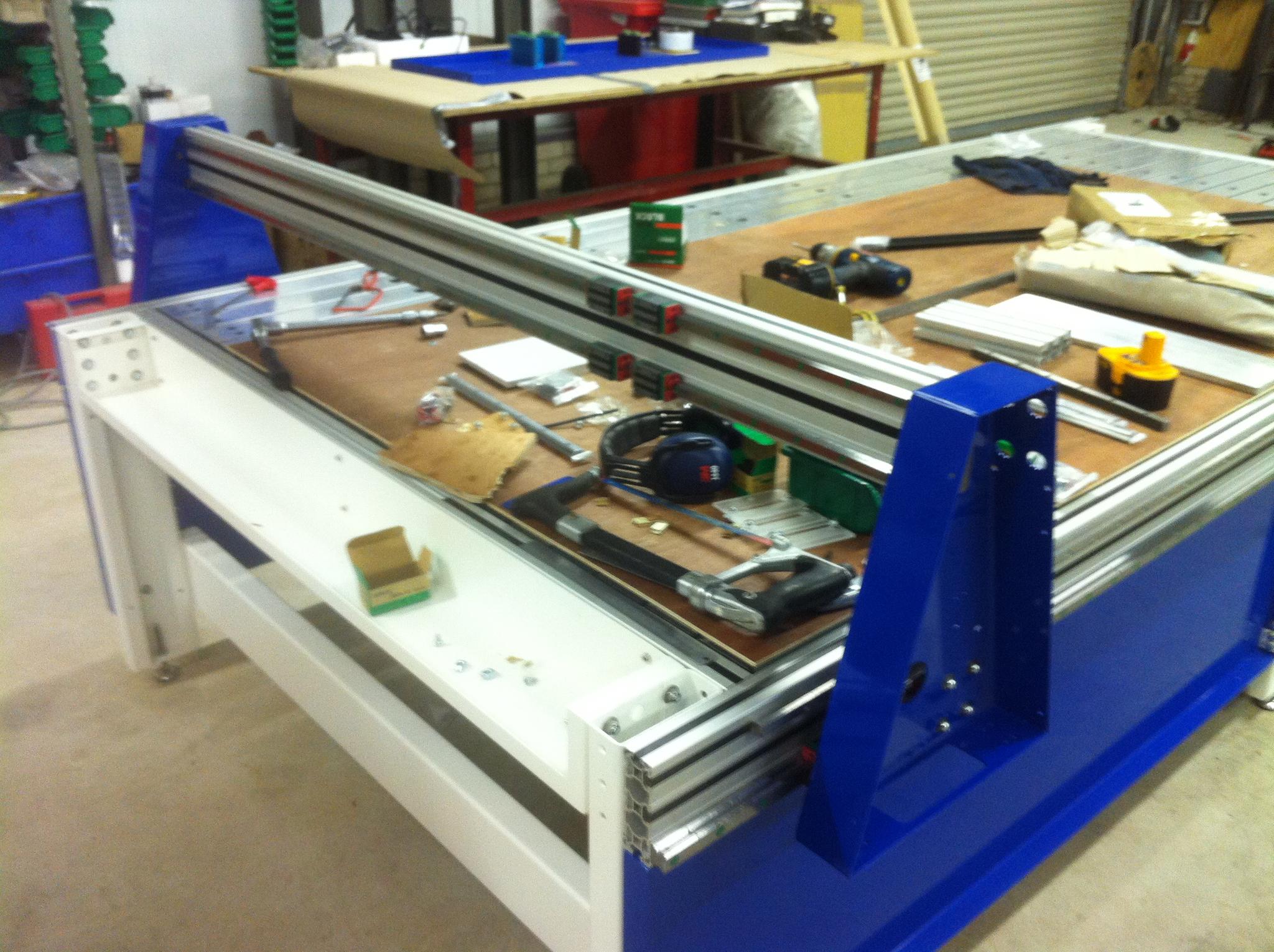

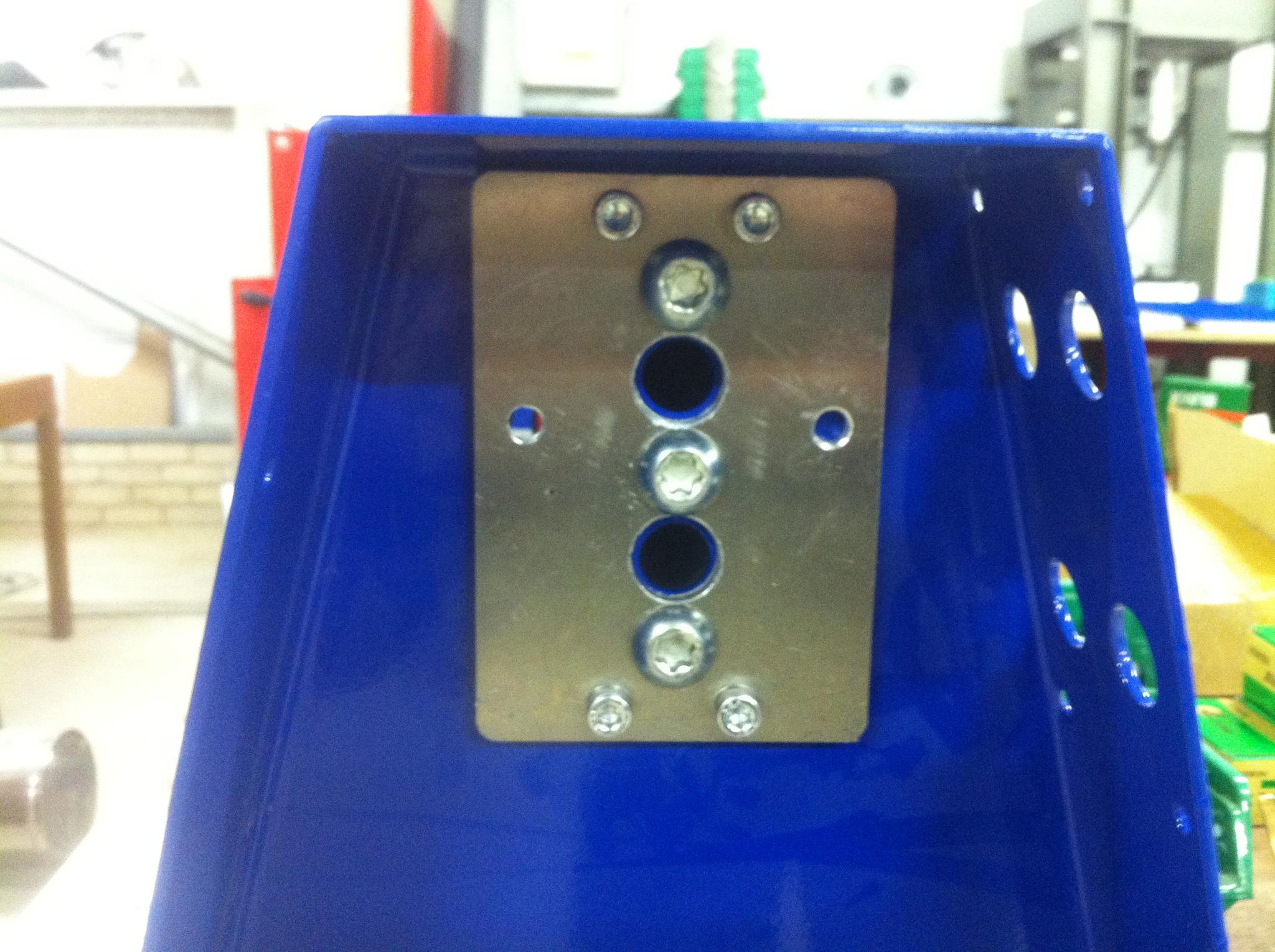

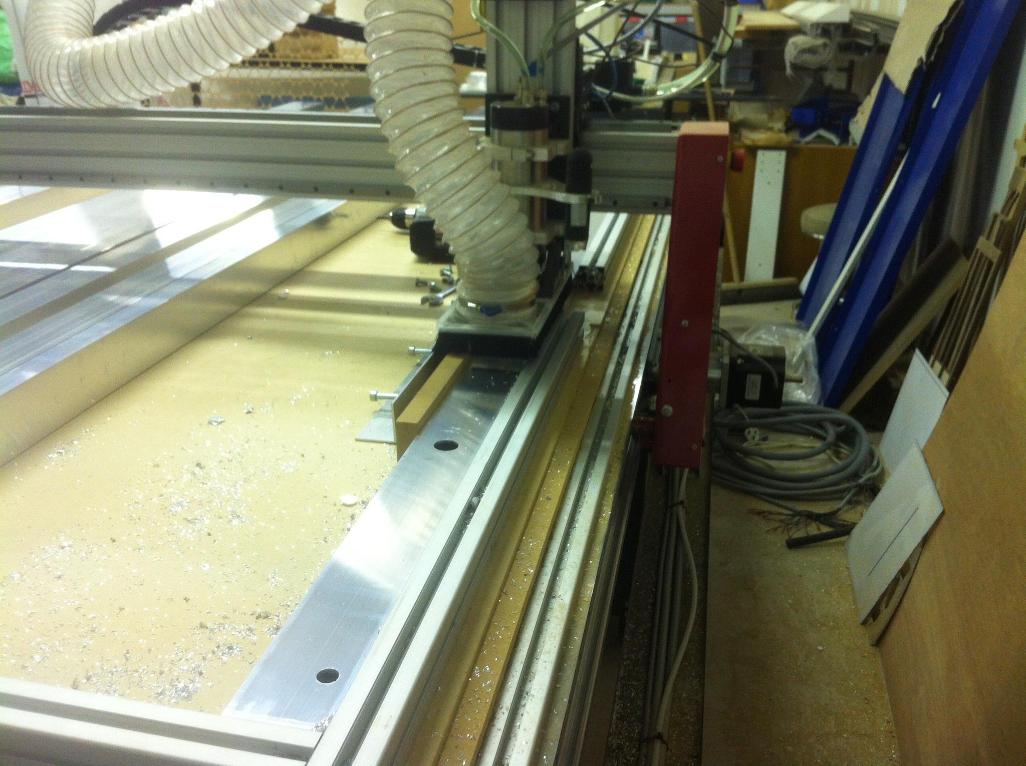

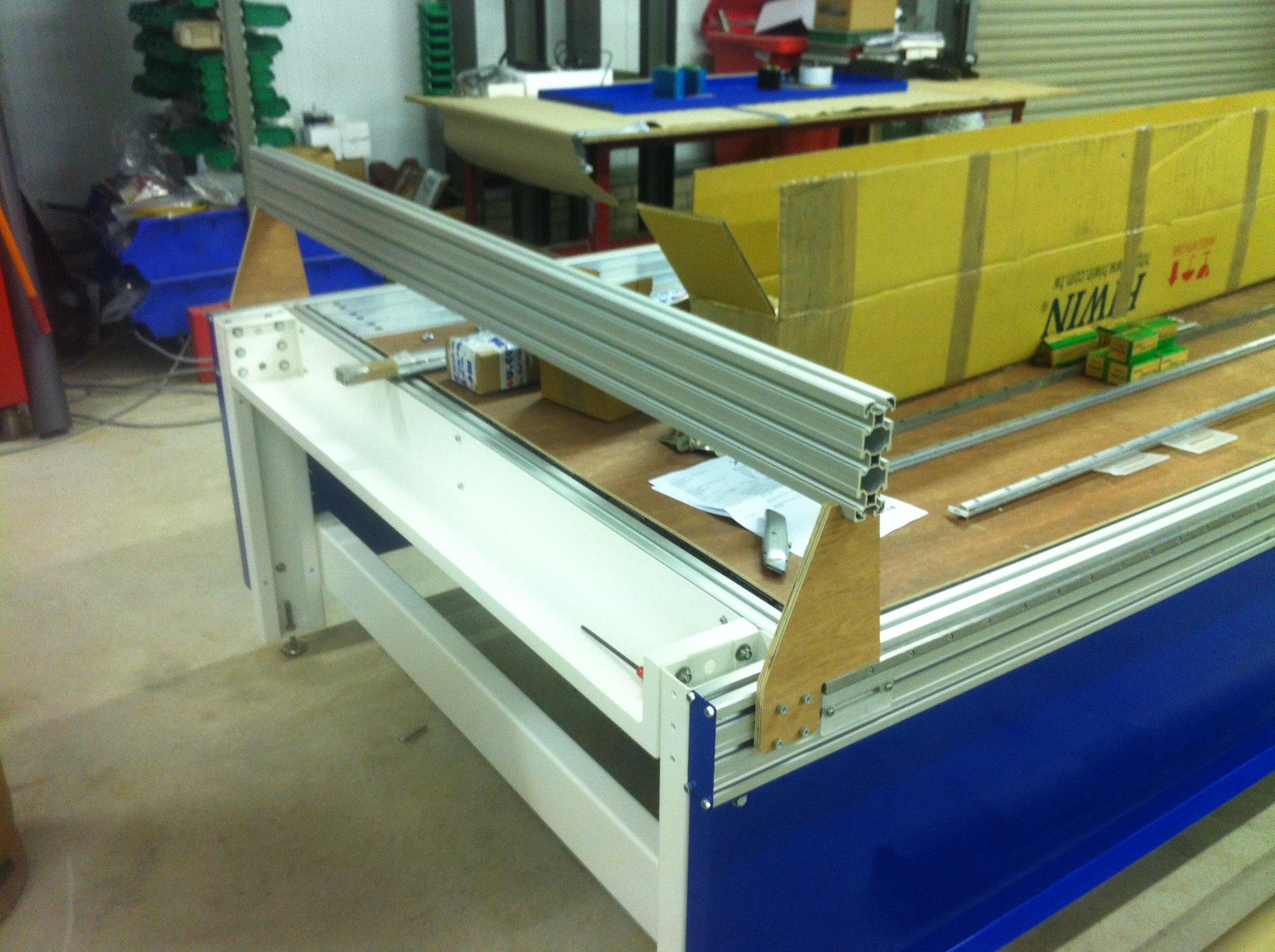

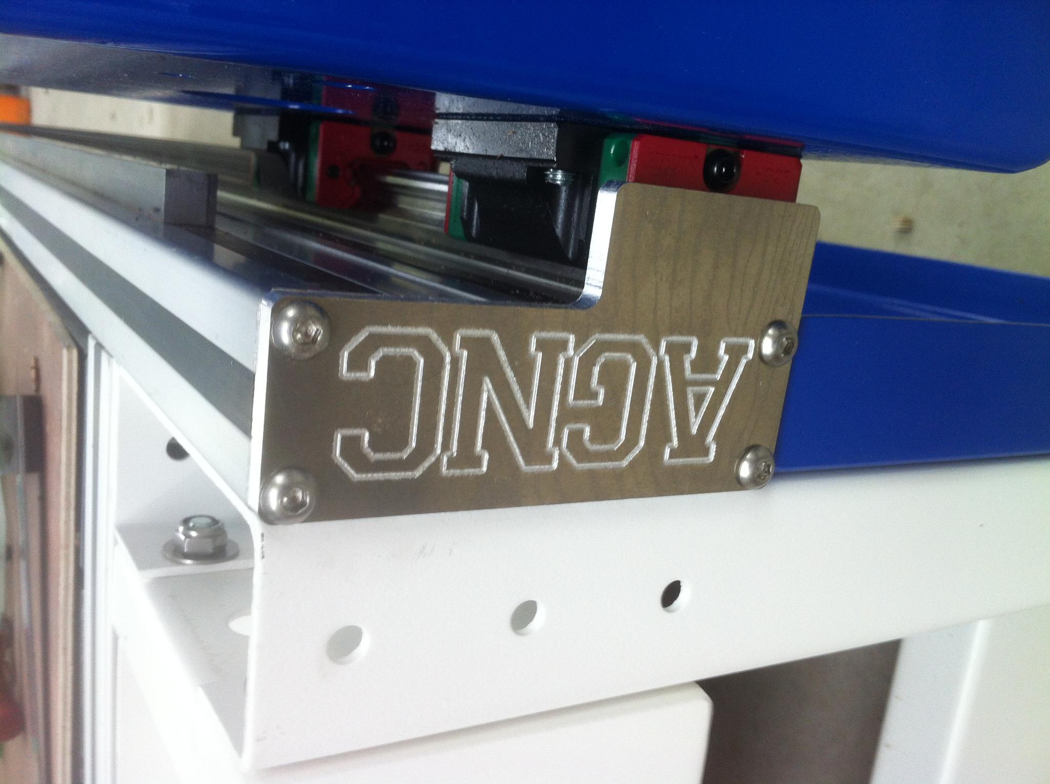

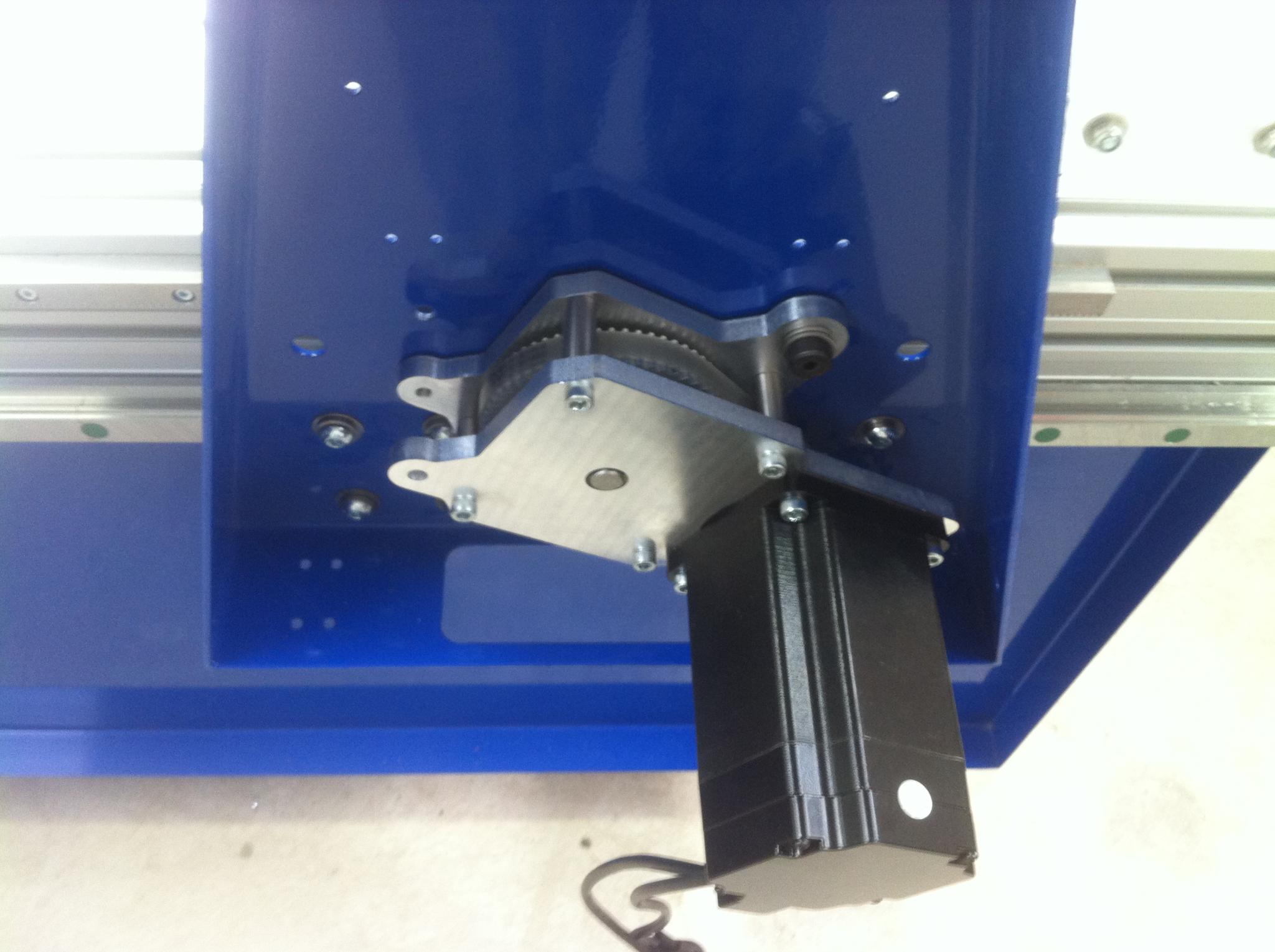

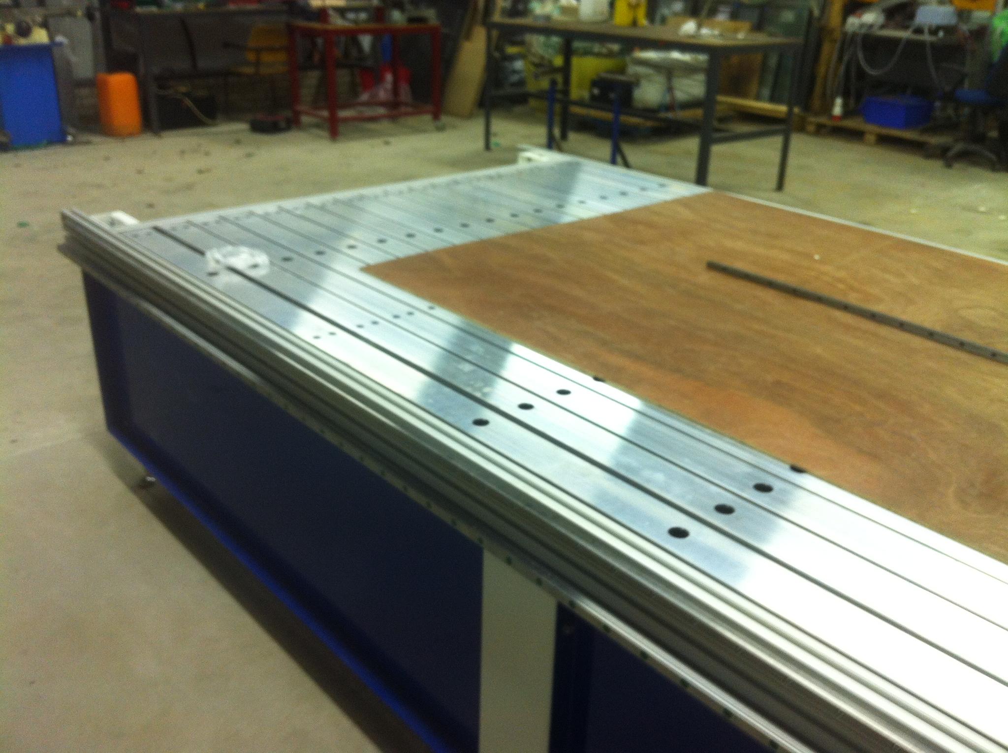

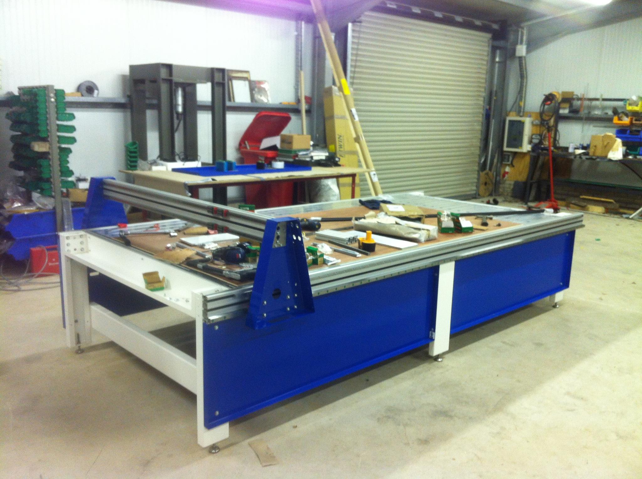

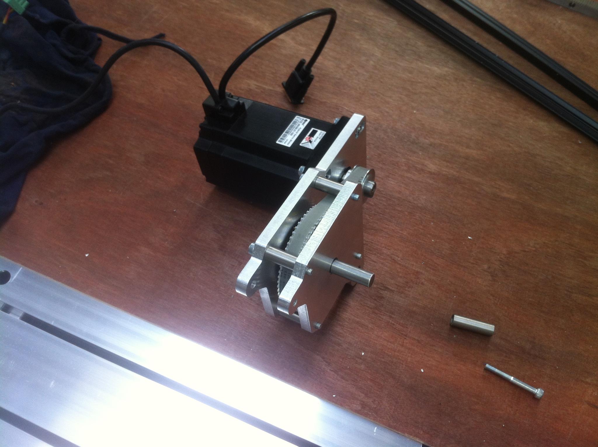

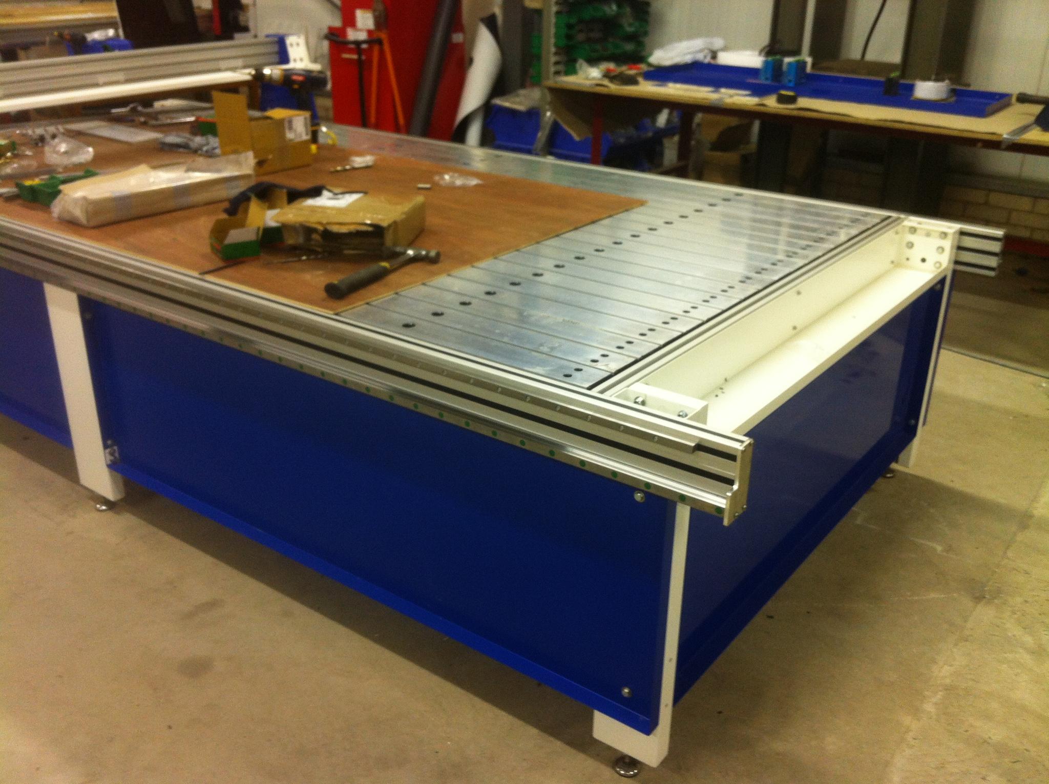

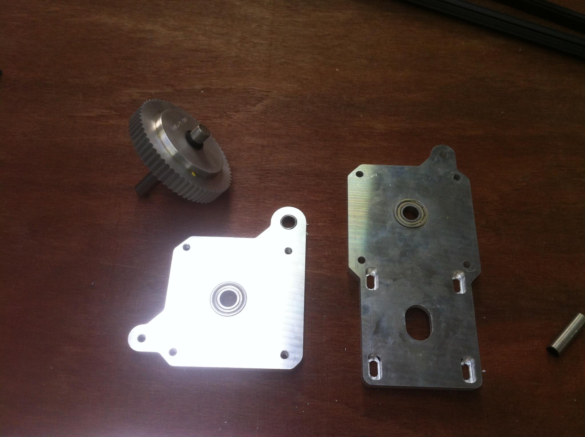

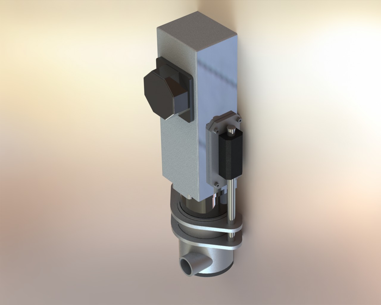

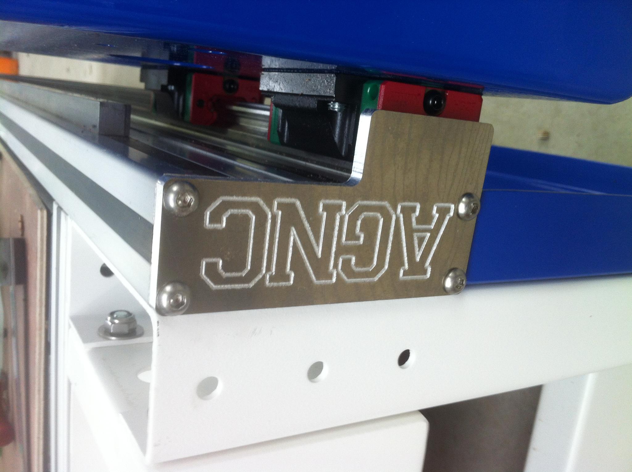

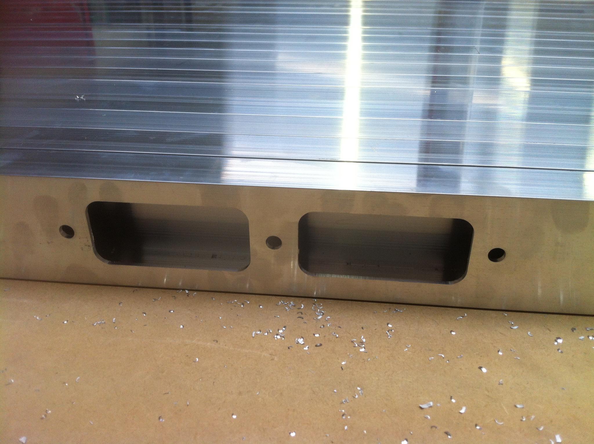

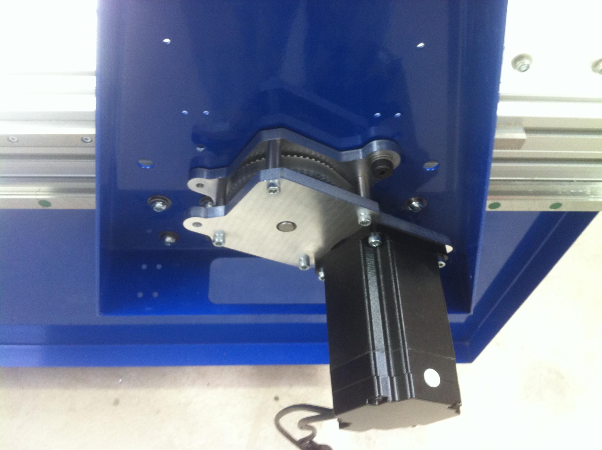

So finally I've got round to starting this build log (to help motivate me to finish the build!)
The specs -
Cutting area of 3050mm x 1525mm x 150mm
Aluminium/Steel Construction
Hiwin Linear Guides (25mm & 15mm)
Rack & Pinion all 3 axis
Closed loop steppers (through belt reduction 3:1)
1.2kw HF Spindle
Option for tangential cutting knife
USBCNC software CPU5B
Full Vacuum Bed made from aluminium box section.
So now you know where I'm going, this is what you all want, PICTURES! Attachment 8938Attachment 8939Attachment 8940Attachment 8941Attachment 8942Attachment 8943Attachment 8944Attachment 8945Attachment 8946Attachment 8947Attachment 8948Attachment 8949Attachment 8950Attachment 8951Attachment 8952Attachment 8953Attachment 8954Attachment 8955

WOW!! This is a monster! Looking really good mate, doesn't look like you are too far off. I have seen your other machine before on here I think? I'm getting there slowly with my router build, but this is inspiring me to take it up a gear and get it finished!
