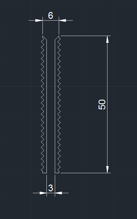

m6 threaded aluminium tube for 3d printer
		So, I'm making a 3d printer.
and I've bought most of the parts from around the world but I can't find this part.
so m6 thread on the outside, 3mm internal hole, about 50mm long and in Aluminium.
it's so I can pop one of these on the end.
I'm using 3mm filament so I'm hoping a 3mm aperture will be fine.

		If you can get a drawing of what you'd like, I should be able to knock a few out with minimal hassle.
One thing I wonder is if a reamed finish would be better than a drilled?
		Re: m6 threaded aluminium tube for 3d printer
		Attachment 9100
A reamed finish would be great, I think brass may be a better material as it may hold the heat a bit more then Aluminium.
I don't want the heat to travel up into the cold end too quickly.
