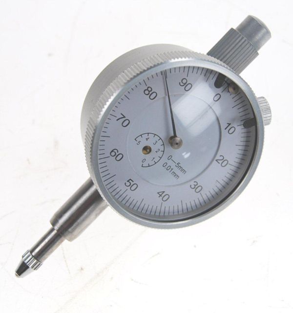

there are however two types, a plunger type e.g.
Attachment 9105

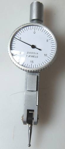

and a lever type e.g.
Attachment 9106
Each has pros and cons. Generally I find the lever type more useful [discuss]
