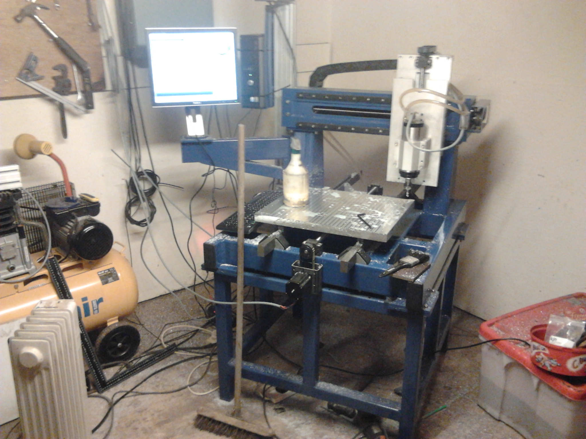

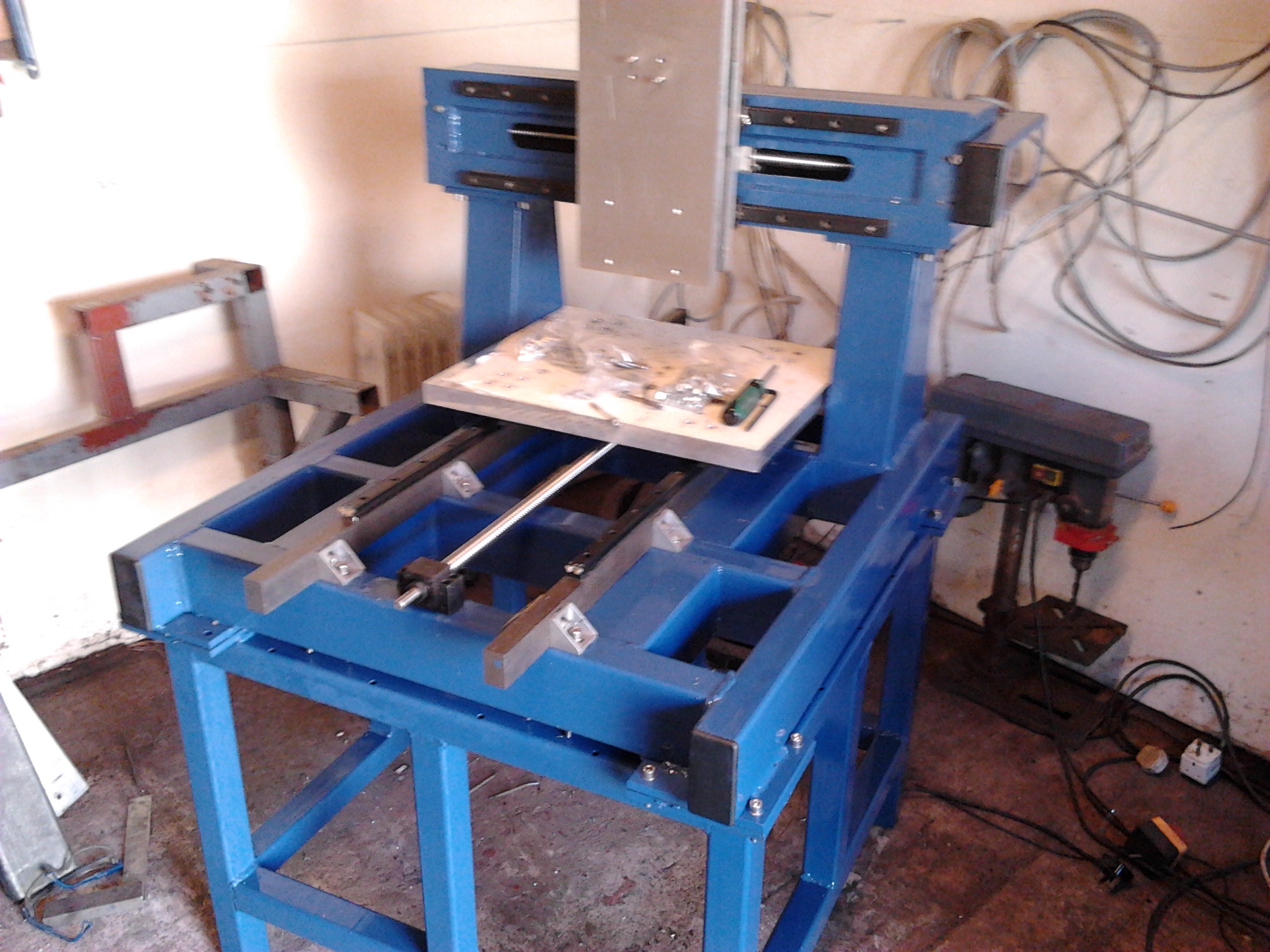

2 Attachment(s)
Re: Eager to Learn and grow
hello,welcome to the site.
i was in the same boat for a time,i liked the idea of building a vertical mill but settled on knocking up a fixed gantry mill,see image ,im fairly happy with it, its sole jobs for plastics and aluminium and it does what i want.
if i were fixed on a vertical mill now id be inclined to just convert one to cnc
Attachment 9173
Attachment 9174

I like that design :-) - you say you are "fairly happy" with it - what problems do you have and what changes would you make if you were doing it again?
FatFreddie
i shouldnt have said fairly i am happy with it, but there are things id do slightly different,things like having slots ground into the face of the y axis for the rail for easier alignment same with the bed id probably have put a slab of tooling plate down with slots ground in for the x rail.
and i really wish id made provisions for collecting all the coolant fluid and chips rather than worry about it after the build,

Thank you deisel. I considered a vertical mill configuration because of space constraints and the material I already have available to me. I really like the simplicity of your setup and may adopt a similar setup after reading your build thread (if there is one) and seeing what I would need. Thanks for sharing and I look forward to hearing alot more feedback and advice from you and others in this forum. :-)
