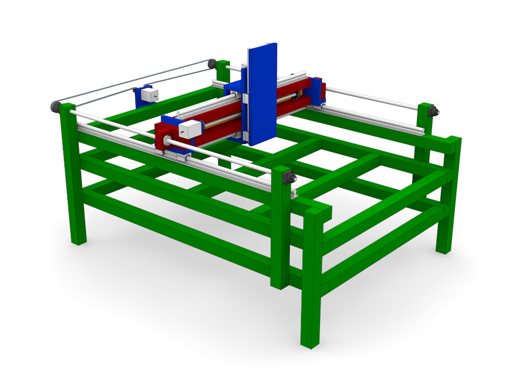

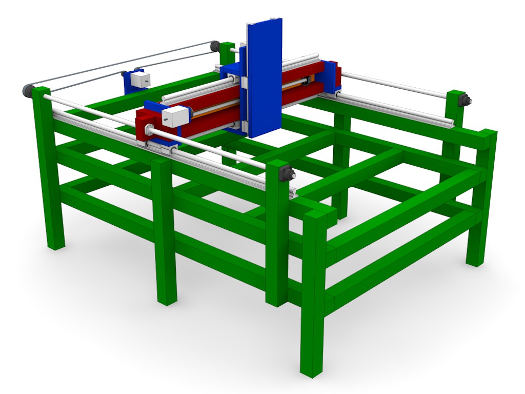

Frame :
60mm x 60mm x 4mm steel box section, welded. Am thinking I'll use self levelling Epoxy on top before mounting the rails. I was considering making some 'bridges' across the structure which will be removed afterwards in order to level both sides up in the same pour. There will be a movable bed, as I doubt I'll make use of the full z travel very often - most of the time it'll be less than 100mm.

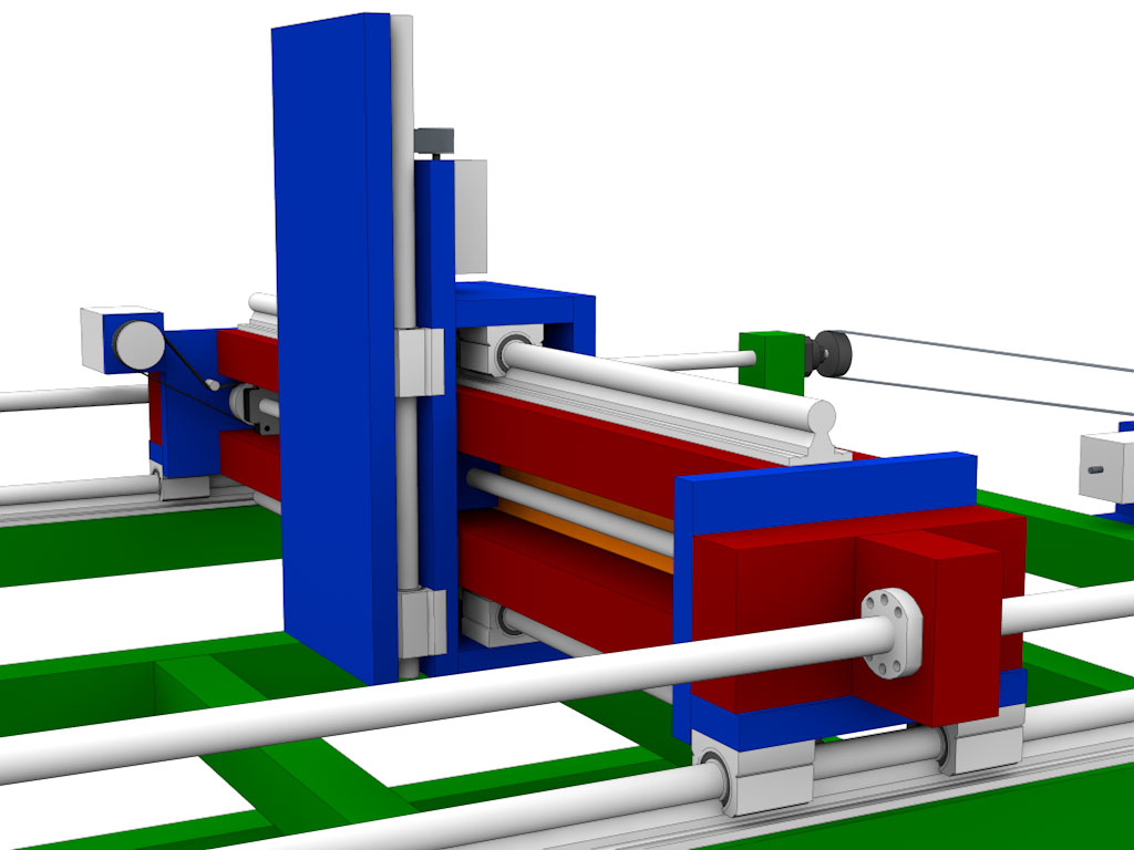

Gantry :

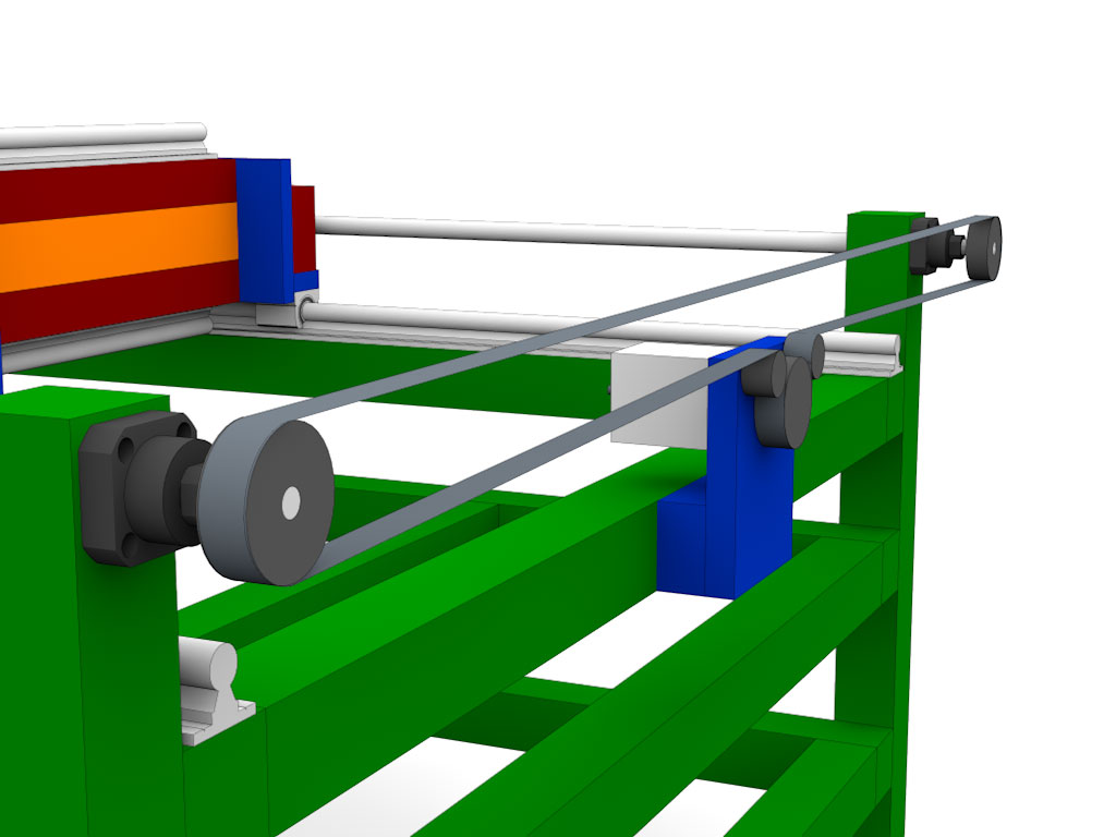

I've tried to take on board the comments people have made about getting the distances between the axis, linear bearings, ballscrews etc. as close as possible. For the Y, I'm thinking of a C shape made from extrusion, with the screw the 'right' side (I'll use bellows to keep the chips out).

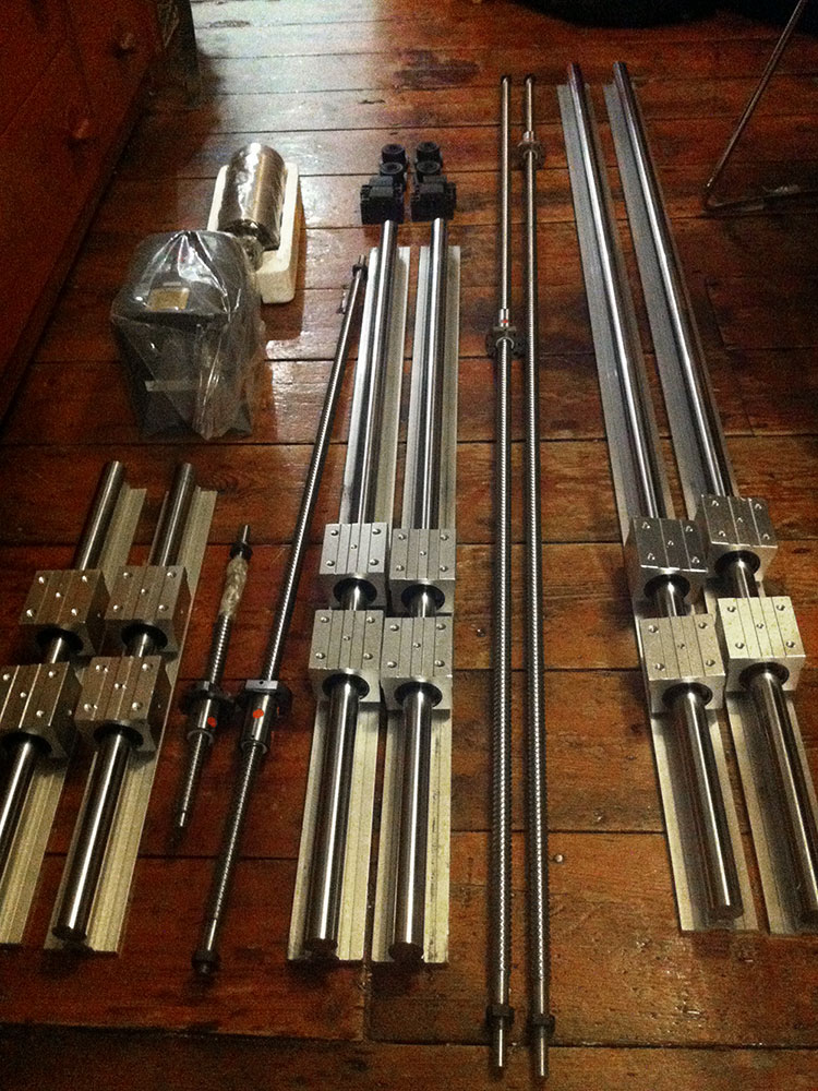

Linear gear :
SBR20 supported round rail on all axis. RM1610 ballscrews driven by belts all round. X will be two screws driven by a single stepper. I'm thinking the Nema 23 3.1NM motors that everyone seems to recommend.
In my attached pics, green is 60mmx60mmx4mm box section steel, red is 90mmx45mm alu extrusion, orange is 60mmx30mm alu extrusion, blue is 20mm alu plate.
