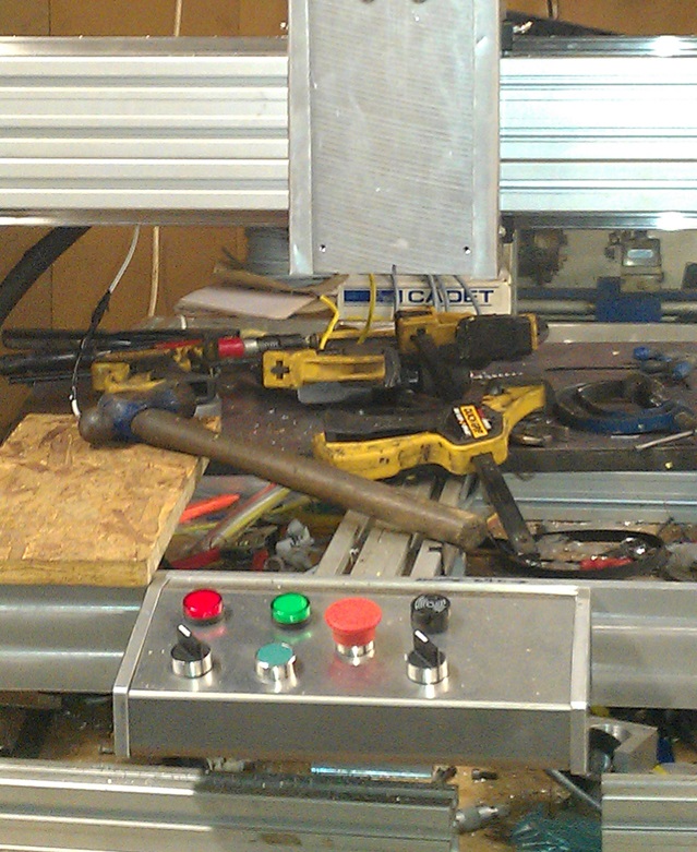

These are what I use on machine. . . Left to right.
Control power ON/OFF 240Vac switch and Led light.
Momentary Start/Reset button with 24Vdc Led
OH SHITE BUTTON
Limit over ride switch with 24Vdc Buzzer.
Also on the Main box there's a master power contactor switch which controls main power to everything, VFD, vaccum etc.
Attachment 9955
