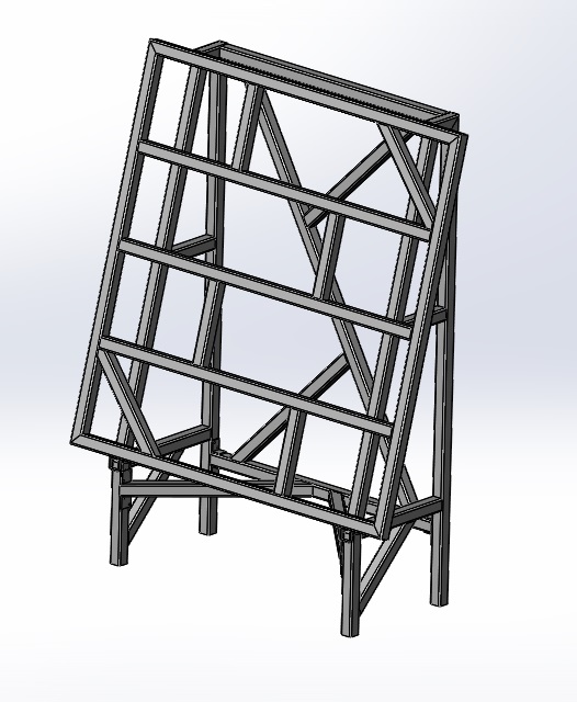

Re: Frank from manchester
here is an itial render of a frame without gantry yet but am i heading in the right direction? Rails are on top and bottom to aliviate chip build up.
any views are welcome
cheers frank

2 Attachment(s)
frankkilleen
cheers frank

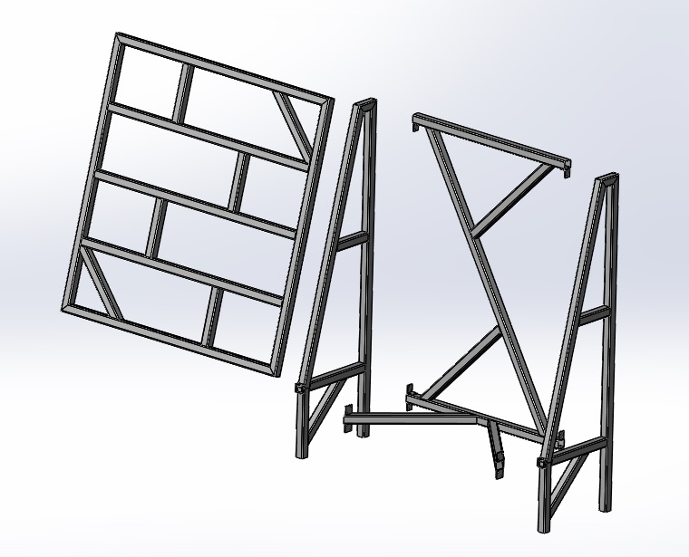

Hi Frank,
Well see few things that may cause you hassle but they are connected so could be easily sorted.!
The rails positioned like you have them will be quite hard to get on the same plane and parallel to each other.
Also the bed frame design with those 3 inner pieces going to the same point will cause stress in that area and would be hard to weld up and keep frame square and flat without heat distortion. It would also need more corner bracing
So I'd look to build the Bed frame off the machine has a separate straight forward bed design IE: Rectangle with perpendicular supports and diagonal corner braces to hold sqaure that bolts onto angled frame.
Then depending on how much clearance and cutting height you require I'd mount the rails directly on the bed or have them raised putting the raising material mounted on the bed. This will easily allow you to make sure the rails are on the same plane by either careful measuring or using Epoxy method, I'd suggest Epoxy.!
I'd then just have a shield to protect the bottom rail/bearings and ballscrews.
Regards the supporting frame then I'd build that in sections has well, something like these pics show. Bolting it together like this will help making it simpler with welding up but more importantly to setup and remove twist etc by shimming or adjusting bolts etc.
Attachment 10339Attachment 10338
Hope this makes sense and helps.!
