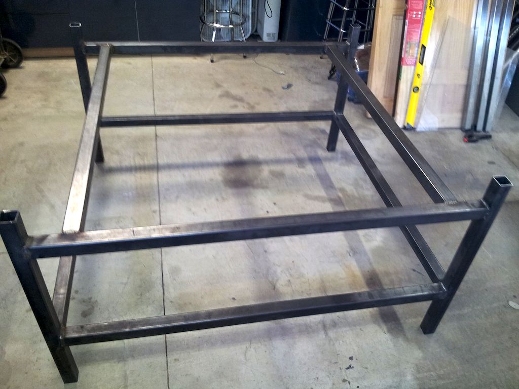

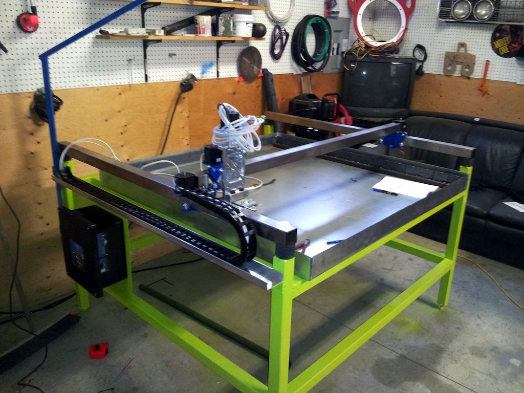

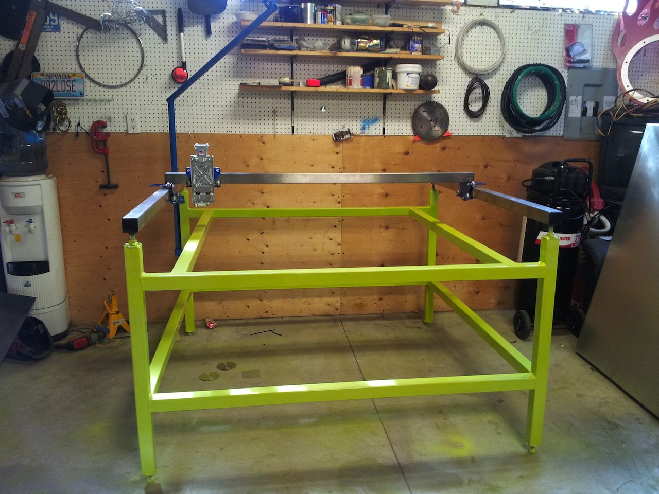

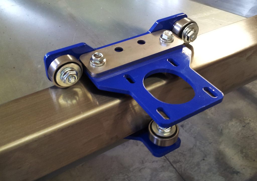

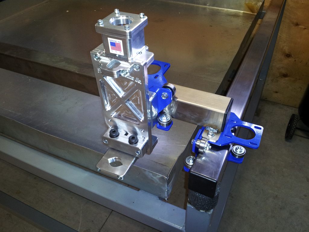

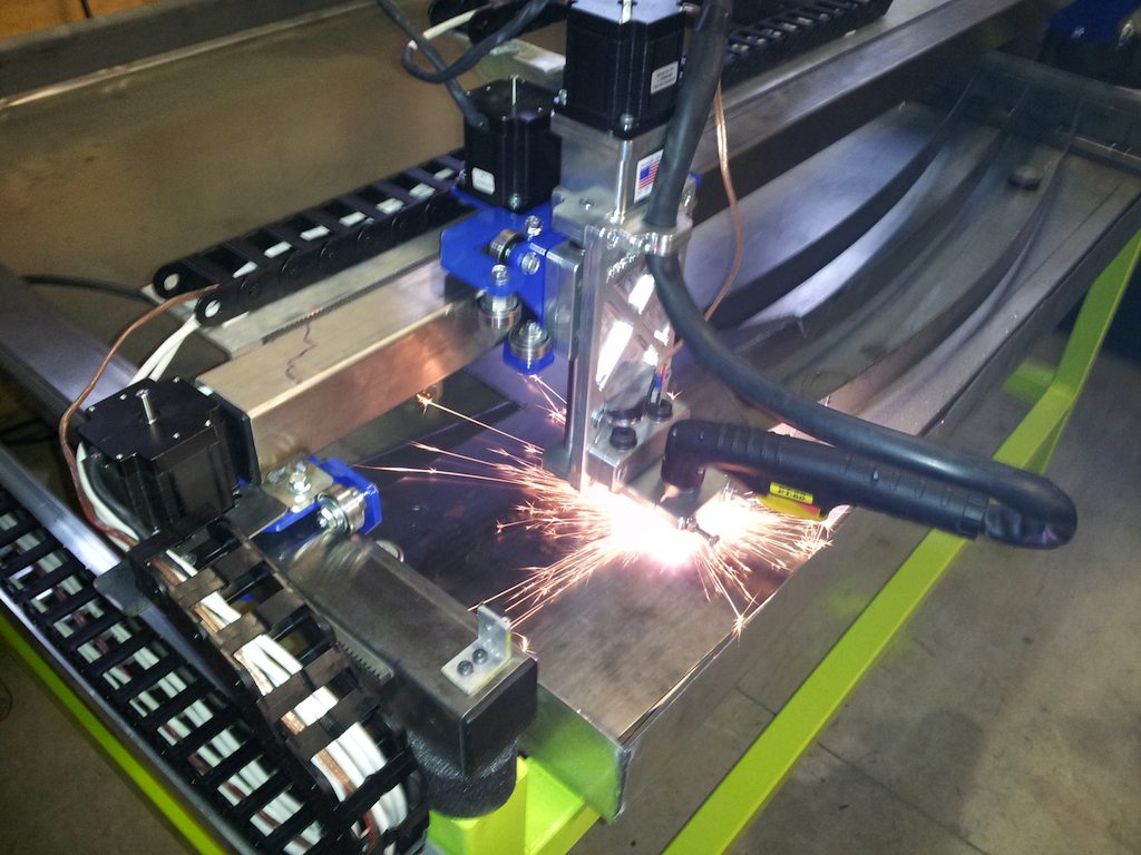

		Been a bit of a lurker for a while but I thought it was time to share - I  recently built a 4x4 table using carriages and a z axis from Precision  Plasma out of the US. Ron is a great guy - I would highly recommend him and his products.

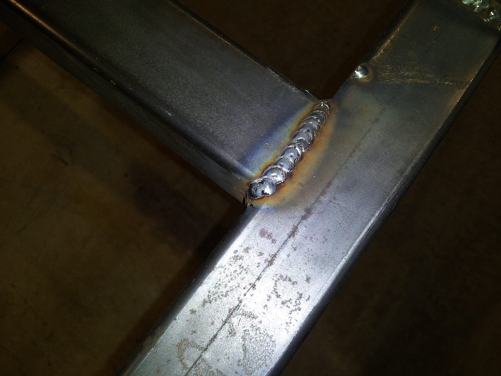

I welded up a table and built a water tray to match the requirements of the "iplasma" carriages.

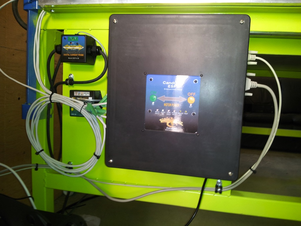

I used the Bladerunner mach3 based control system from CandCNC automation and it was pretty easy to hook-up and get going.

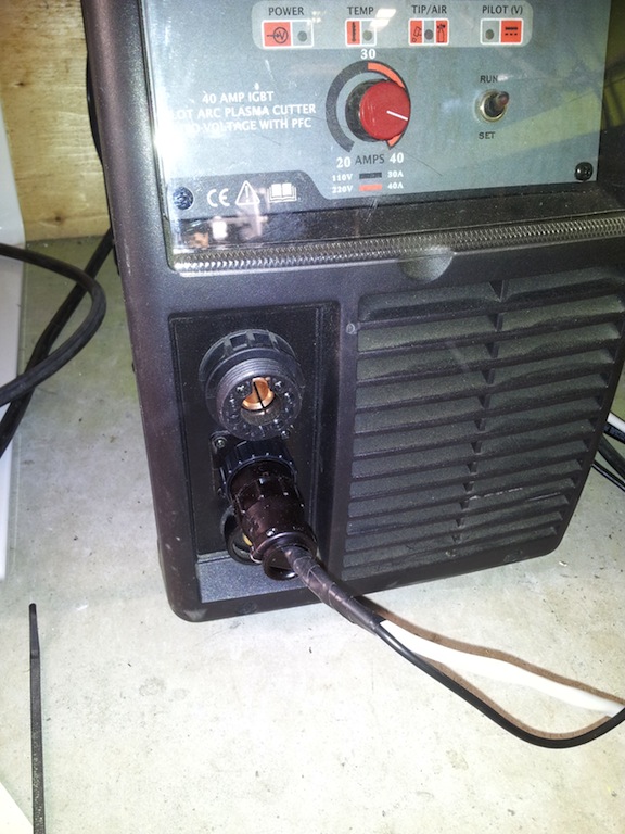

I am running a Longevity Forcecut 42i plasma on the table. I am getting  excellent cut results and the consumables seem to be holding up pretty  well. The CNC port on the front of the machine  allowed for a pretty painless connection to the Bladerunner system. It  is pinned with a slightly different pattern than the Hypertherm units  but it is well labelled and easy to figure out. For the $ this is an  excellent value cnc plasma source.

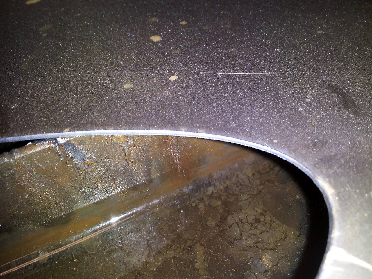

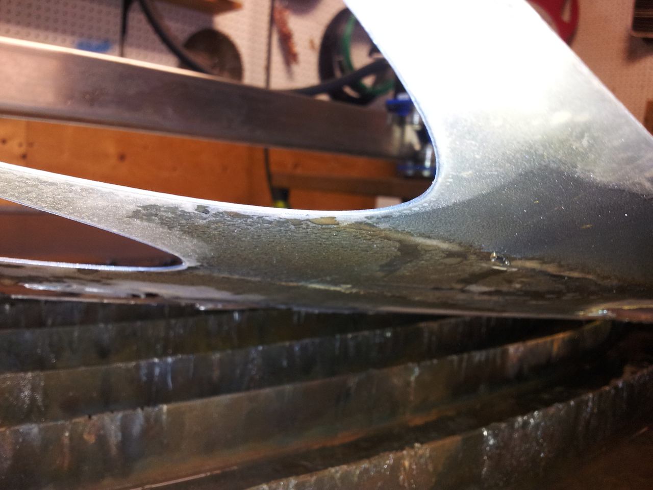

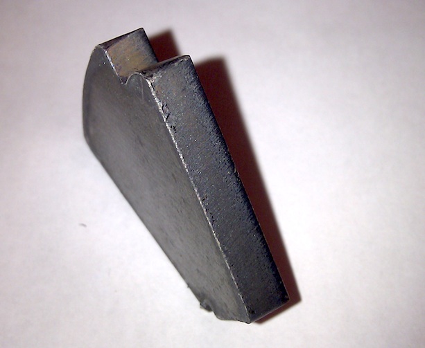

There are a couple pics of 20g cuts - top and bottom of cut straight off the table. Also a couple 1/4" steel results.

All in all the table works great and I am now working on table #2
