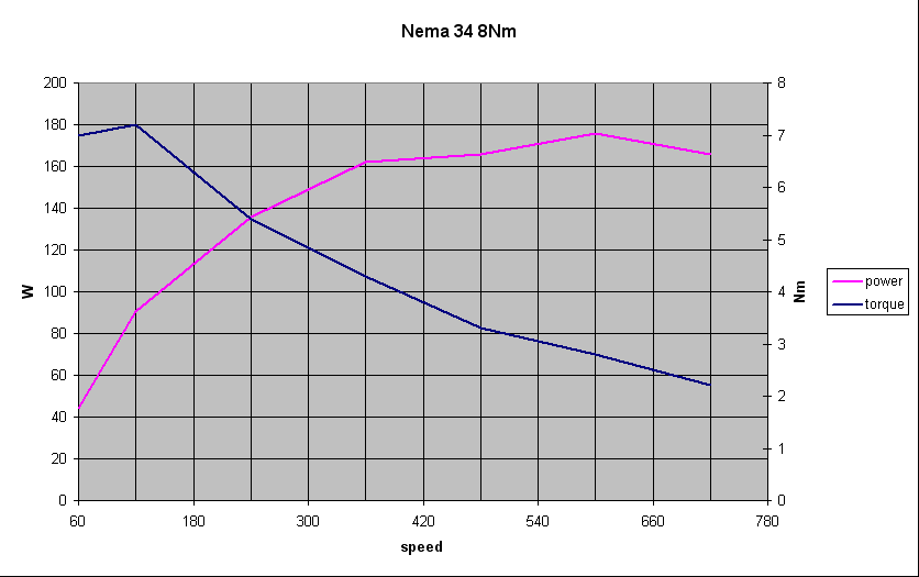

Thanks for the reply Jonathan. I'm actually quite happy with less speed on the output, which is why I'm currently running the motor at 240RPM and the shaft (output) at 90RPM. At 240RPM there's plenty of torque, around 5.5Nm at 68VDC, this over 2.66:1 ration gives around 15Nm on the output (at 90RPM). This is on the verge of stalling, sometimes it runs fine, sometimes stalls. Max voltage both the HBS86 or the AM882 can handle is 80VDC, would that give enough bump to the torque? Here's the power / torque vs. speed data from Excel:
Attachment 11500

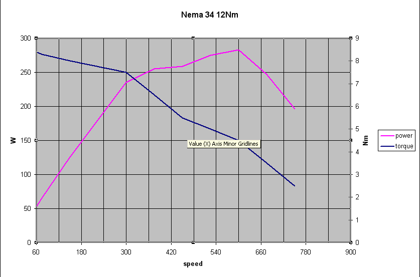

With a Nema 34 12Nm, which is only 25mm longer than the HBS 8Nm I'm using now (it's got an encoder fitted which I don't need at all), I'm planning to run that at the same speed of 240RPM. This gives around 7.5Nm, which over 2.66:1 ration gives 20Nm on the output (at 90RPM). Hopefully that's enough to get past stalling. Similar data to the 8Nm motor:

Based on your new graphs, the peak power is at about 600rpm, yet you're currently running at 240rpm. So for the 8Nm motor you're currently getting 130W (@240rpm), but if you changed the ratio to 600/90=6.66, then you would have about 175W (@600rpm) available - so 35% more. That corresponds to 18.6Nm on the output shaft, which is a much bigger difference than you're going to get from changing to 80V from 68V. Changing the motor to the 12Nm version and leaving the ratio the same gains about the same percentage, but presumably at much greater expense...

Ok, I can see where the max power calculation kicks in, the only issue is that running at 600RPM, the ratio stepdown would be massive, with 6.66 you are looking at huge pulleys or simply a 6.67:1 planetary gearbox, which wouldn't fit due to the size of the motor. I will try and look at less powereful motors, maybe some Nema 23s or shorter Nema 34 and match a gearbox to those.
Where did the 37.1Nm figure come from? at 600RPM, you only have 2.7Nm torque delivered by the motor, so over a 6.66:1 ratio, there's 18Nm on the output. Or am I missing something?

Yes, the optimum ratio is a bit unwieldy. Not difficult with two belt reduction, if you've got the space. You imply that the requirement is 188W, plus a bit to account for the inefficiency of the gearing. If that's a planetry gearbox then you'll need to add quite a lot, but if it's timing belts then 200W is probably sufficient. You're probably not going to get that much power from a smaller stepper motor, but by all means check.
dsc
No, you're correct. I made silly mistake and corrected it but you were too quick!
