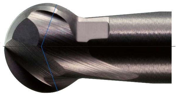

i get round this problem in cut3d by using a ball end cutter instead of a ball nose cutter
Attachment 12599
hope this helps
