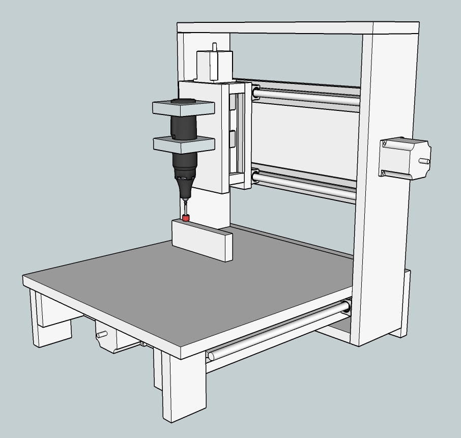

What's the construction going to be, aluminium extrusion or aluminium flat plate ? How are you going to fit tooling into the, erm, 'spindle' ?
Neither at the moment cause I am not 100% sure if my measurements are correct so going to use MDF, a lot cheaper to experiment with. If it's all ok then I'll consider getting alu flat plates.
I have salvaged the chuck off a dremel that burned out on me a few months ago and want to connect that on to the electro motor, somehow. Like I said, no idea if it's going to be any use but gonna give it a try.

Cheapest I found on EBAY was £7-800, takes the fun out of building it.
I did build one a couple of years ago so still have the steppers and the controller so want to build my second now. Like you said, it's great fun seeing it come to life and do what it's supposed to.
The original idea was to build one with a fixed gantry but I have changed that now to give me double the cutting/engraving size. I have very limited space so need to make the best, or near as damn it, that I can. And if I convert it to cut as well later on it'll be more useful with a moving gantry, can cut larger pieces.

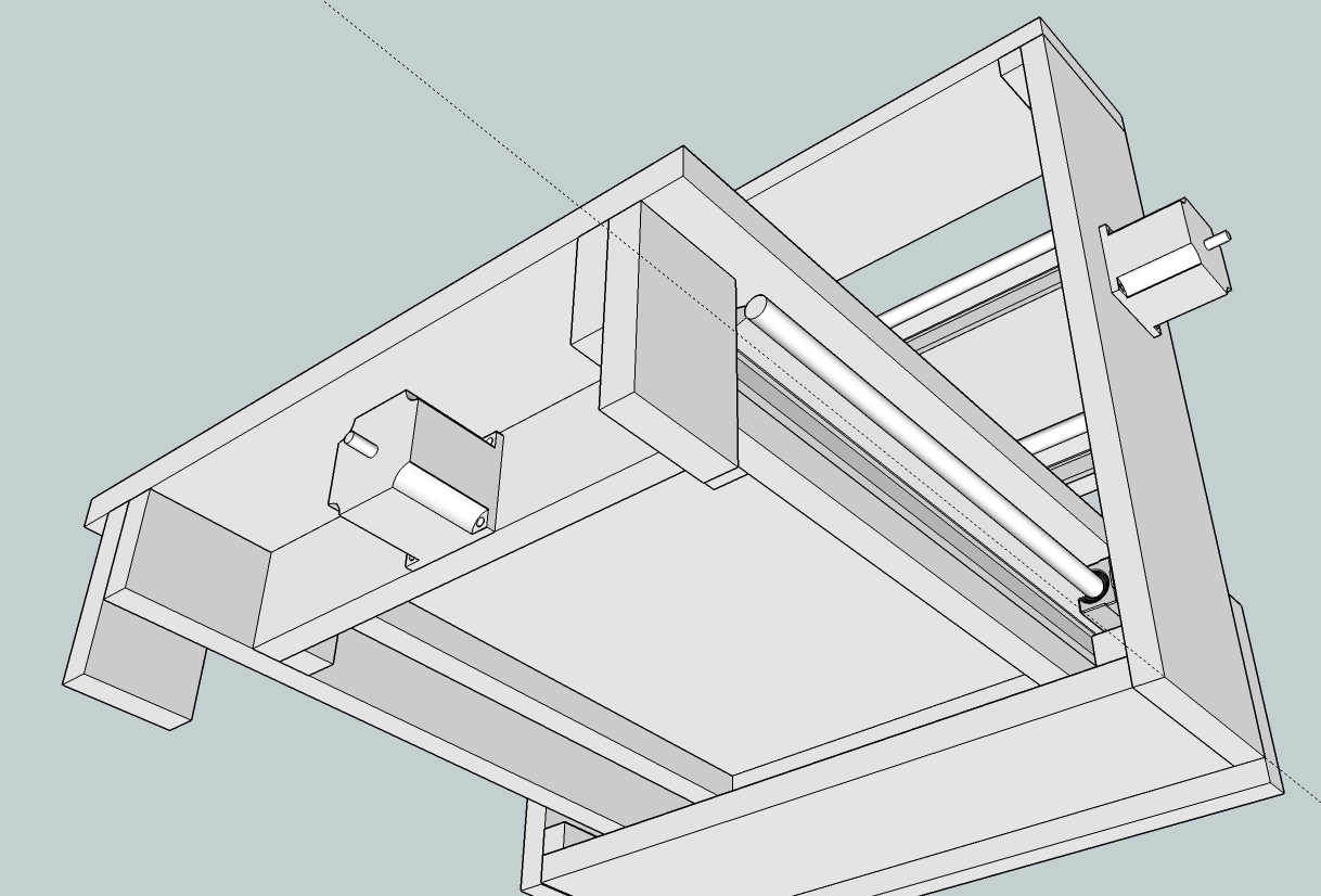

get yourself a good countersink bit, like countersink bit for aluminium they are awesome in MDF and ply. Also, B&Q are the worst place to have MDF or any material cut. The people who operate the saw, are only taught how it works and how to be safe on it, not how to cut things properly. Most of them are just sent on a course to learn it to cover peoples shifts, and so they have no experience. You should have asked a local joiners or cabinet makers to cut the wood, you would have had it done right first time. Other than that, great material to experiment with, especially if you can take it apart again and use it for patterns for aluminium later on.
PSG
Re: Start of a new built.
I've got one of them countersinks, they are good.
The thing is that I've got all the tools and machinery but no garage/shed or garden, otherwise I would have cut it all myself. I did have a look around but haven't found a local joinery or cabinet maker so had no choice but to go to B&Q's.
What I have in mind is to use 18x18mm wood to join the pieces together, as in the sketchup drawing below, would be a lot stronger and will be a lot easier to pull apart and use as patterns as you mentioned.
