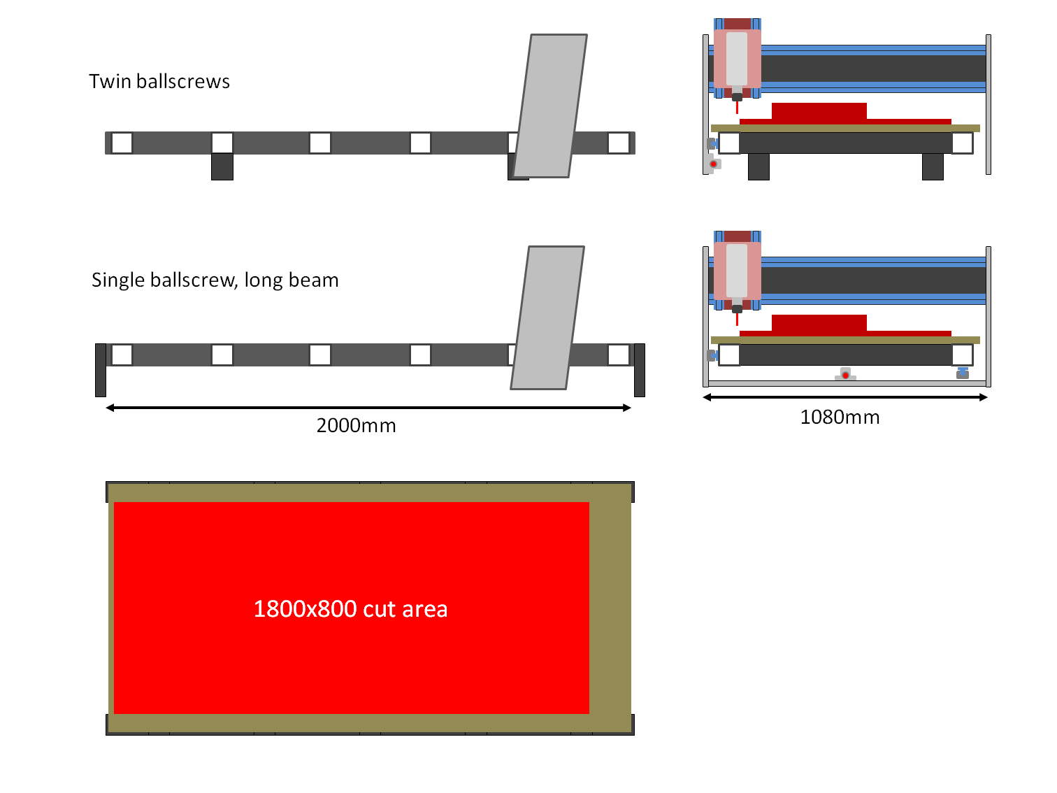

Having got a rough quote for the CNC routing I will need on a repeat basis (hopefully) I want to work up a design to build my own machine when demand is established.
First thing is to get the basic layout sorted, and I want to get an idea of what components I will be using and how much they will cost.
This is for 2.5D routing of almost exclusively 18mm melamine faced chipboard.
I've started with a simple ladder frame, from 80x80x3 steel tube. Then I've used that for the gantry too. Laser cutting of steel and welding I can get done locally.
I've gone for a small 80mm travel, just because I don't foresee the need for any more.
I've put SBR16 rails on just because I saw them in a thread today.
I'm interested to hear what ballscrews and motors I should be using. This router isn't going to be used non-stop so linear speed and power is only needed for cutting performance rather than to churn the job out fast. 50m of full depth profile cutting is the most it will do in a day, so even a cutting speed of 1m/min would be sufficient, but a bit boring.
I've drawn a couple of X rail layout for comment.
sketches are from powerpoint I'm embarrassed to say.

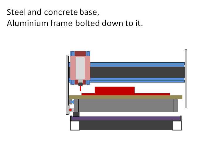

The concrete base idea would be something like this.
It looks like a lot of work and materials now, but if it would work, it does require much skill.

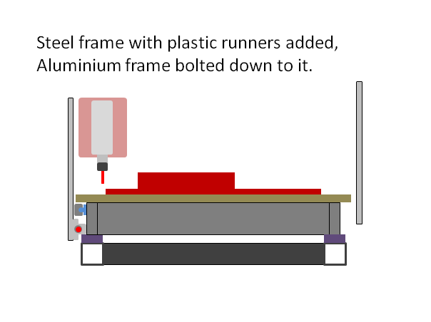

Has anyone done this?
Weld up a steel ladder frame, bolt strips of acetal to every member, and take it to a friendly wood cnc place and get them to skim it flat. Also drill some locator hole where you will tap and thread later.
If you had a flat surface, would that be enough to ensure a straight linear rail? ie can the rail be reliably attached to the aluminium profile and be straight, using countersink washers and screws or something like that?
http://www.mycncuk.com/attachment.ph...id=14748&stc=1
Re: Design for 1800x800x80 wood router
Nope not done anything like that....
IMO the best thing to build a frame out of would be Sq section steel. There's no advantage to making a steel and concrete base, or steel and acetal frame so they're accurate and then bolting an aluminium frame to it that's probably not as accurate. Make the whole frame from steel, build in lots of adjustability and shim/file/fill the top rail (or go the self leveling epoxy route) so it's flat and fit the rails (which if supported round will not be level/flat) to that? Round rails are best mounted upright as the bearings aren't as strong on their side. At 1800 or 2000mm long you're into 20 to 25mm ballscrews to stop whipping at high rpm and Nema 34 motors...or rotating ballnut on 16mm ballscrews. Have a look at Kingcreaky's builds for inspiration (I'm sure there are others like Jonathan's first build to look at too but his spring to mind first as large wood routers, especially the last one!!)
If you want to do any concreting, name a nice flat base for the frame to be bolted to.
Ah I forgot to change the sketch, I'd use profile rail now given all the comments I've read on this forum.
I've just looked at some more posts, looks like building the frame and then bolting on 2 main beams with shims is the way to go.
When you shim a linear rail, is that putting a washer under the rail at each screw position? And do you file it to thickness or just use shim washers?

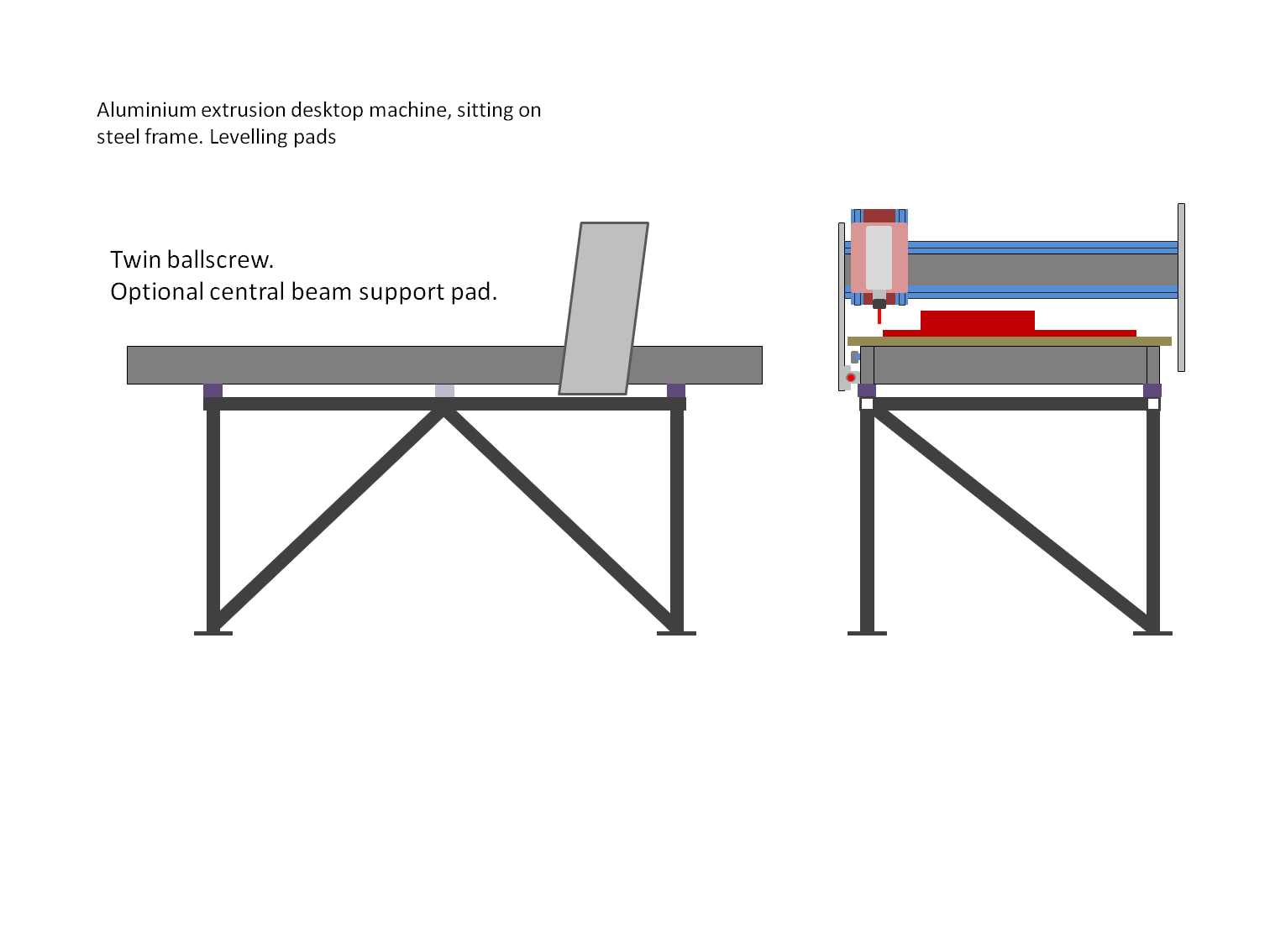

You shim the main beams not the linear rail, either using proper shim material or this forums favourite method...metal from an aluminium can (Guinness being a favourite) and then using a straight edge and feeler gauges find the high spots and file/scrape them and fill any low spots. Then the linear rails can be mounted straight on the beams.

I'm thinking now that a welded steel frame is making life hard for me. This is for wood mostly so an aluminium extrusion design might be more suitable. I quite like this design. It looks easy to move/install elsewhere which also makes it more re-sellable than a great big welded frame.
The question I need answering is: Can you just bolt a hiwin rail to an aluminium extrusion, and the result will be straight enough for wood panel cutting ?
http://www.mycncuk.com/attachment.ph...id=14750&stc=1

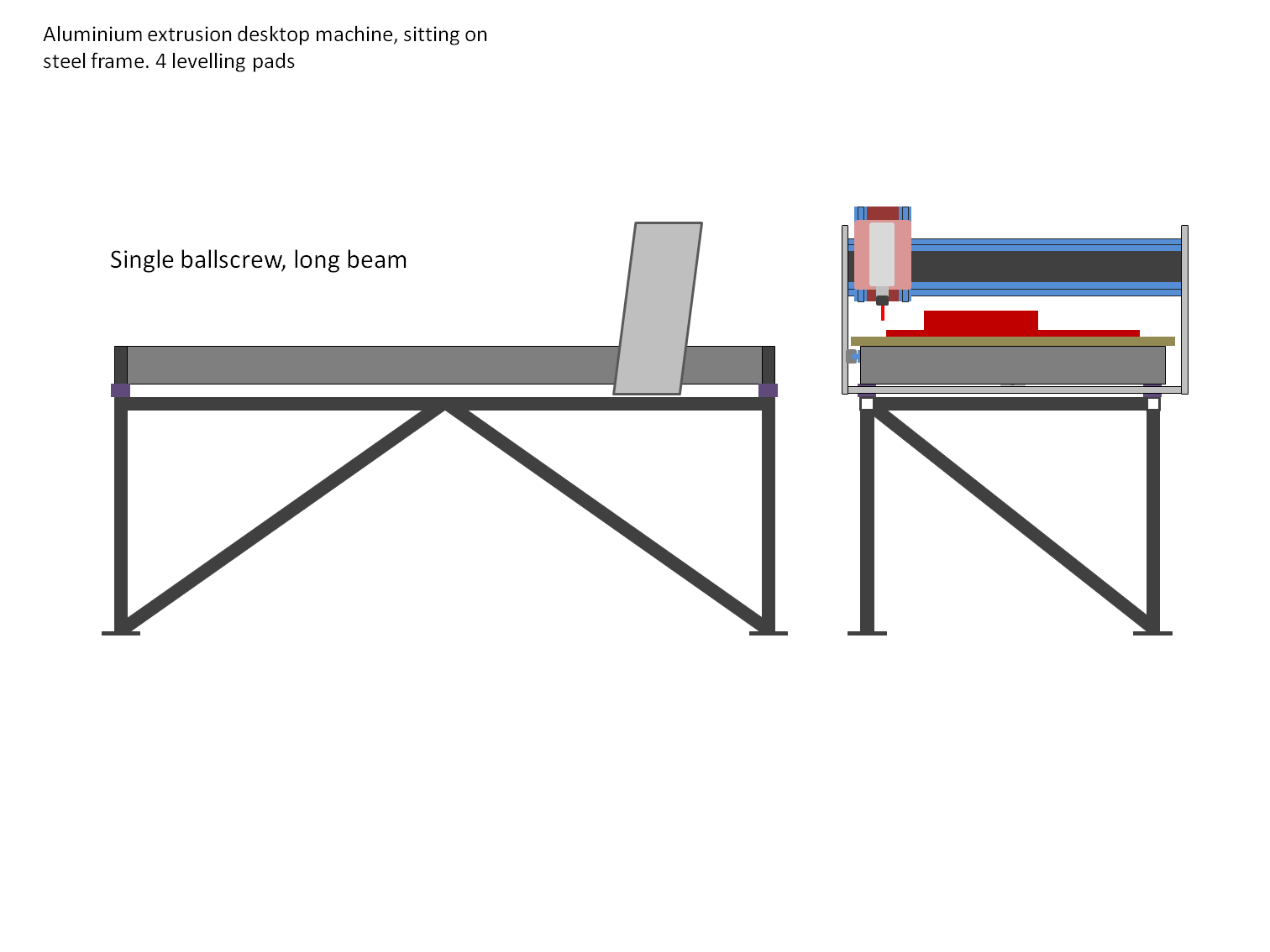

You mentioned a larger screw being needed, I guess that depends on feed rate as well.
The other structural option is single screw with a long beam.
Can someone help out with rough estimate of the cost comparison. I need the cost of a twin ballscrew set-up versus a single screw for 1800mm travel. That includes the screw assembly, and the motors and motor drives. I realise there's a lot of calcs in that, and it will take me some time to track them all down on the forum.
Here's the single screw layout, I'm not sure I even like it. If the beam is going to need to be deeper then that's already counteracting the single screw cost saving.
If someone was to say forget single screw, you need 2 screws, I wouldn't be upset.
http://www.mycncuk.com/attachment.ph...id=14752&stc=1

Have a look through some of the build threads and all your questions will (OK not quite all) be answered.
Here's a good starting point http://www.mycncuk.com/threads/8242-...ght-ply-cutter
Then there's Jonathan's first build: http://www.mycncuk.com/threads/2288-...outer-building
Another couple of Matt's builds...
http://www.mycncuk.com/threads/5174-operation-cnc
http://www.mycncuk.com/threads/6530-...ine-in-a-month
Read the above build logs as a minimum, download yourself the free version of Sketchup and have a play drawing up frames with dimensions on etc and then post them up for critique. I'm not saying that the way they've built their routers is the correct but it's a proven route so can't be bad....
