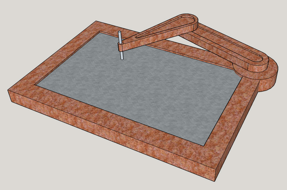

So I was thinking about the reverse, two motors, one attached to the base driving a 'shoulder' the other driving an 'elbow' all moving in the horizontal plane over an A3 drawing area.
Re: New Machine Design Advice
yes! that's the kind of thing - Thanks!
I think the two motor arm idea would work very well - Also could look very nice/interesting. Also the entire arm could be positioned so that the view of the drawing area is clear.
Material wise, I will be looking at using brass (or aluminium) with wood for a kind of retro/steampunk look. Would be great to use something like servos but not sure they would be up to the job? Maybe small steppers might be better.....?

So after thinking about it, the delta type robot may be on the back burner. I think the resulting machine will be just too big and I cant see how it would make so the machine does not obstruct the view of the resulting image.
The robot arm idea has legs though!:hysterical:
Something like this....
Attachment 13262
