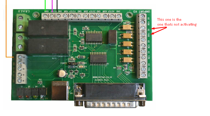

What do you mean by "Input 1"? You don't assign home switches to inputs?
Go to General Config and uncheck "Home Slave with Master".

Really? are the ones in the picture only for Limit switches?
I have unchecked "Home slave with master"

I thought you were referring to input 1 in Mach3, not on your board.
Does it work with "Home Slave with Master" unchecked?

Are the home switches normally open (NO) or normally closed (NC) ?
If NC you wire the X,Y,Z in series then into one input of the bob, then A (the slaved X) into another input of the bob
If NO you wire them in parrallel then into one input of the bob, then A (the slaved X) into another input of the bob
You can see how my NO inductive proximity switches are connected here (bottom left corner);
http://www.mycncuk.com/threads/6565-...7622#post57622

Yeah the motors all work as they should. its only when it comes to homing and that home switch not being active or whatever reason
Re: Auto Square the gantry
oh i didnt go that far buddy... i just put each one on their own input in the bob.
i dont understand it every other switch works bar this one on the A axis
