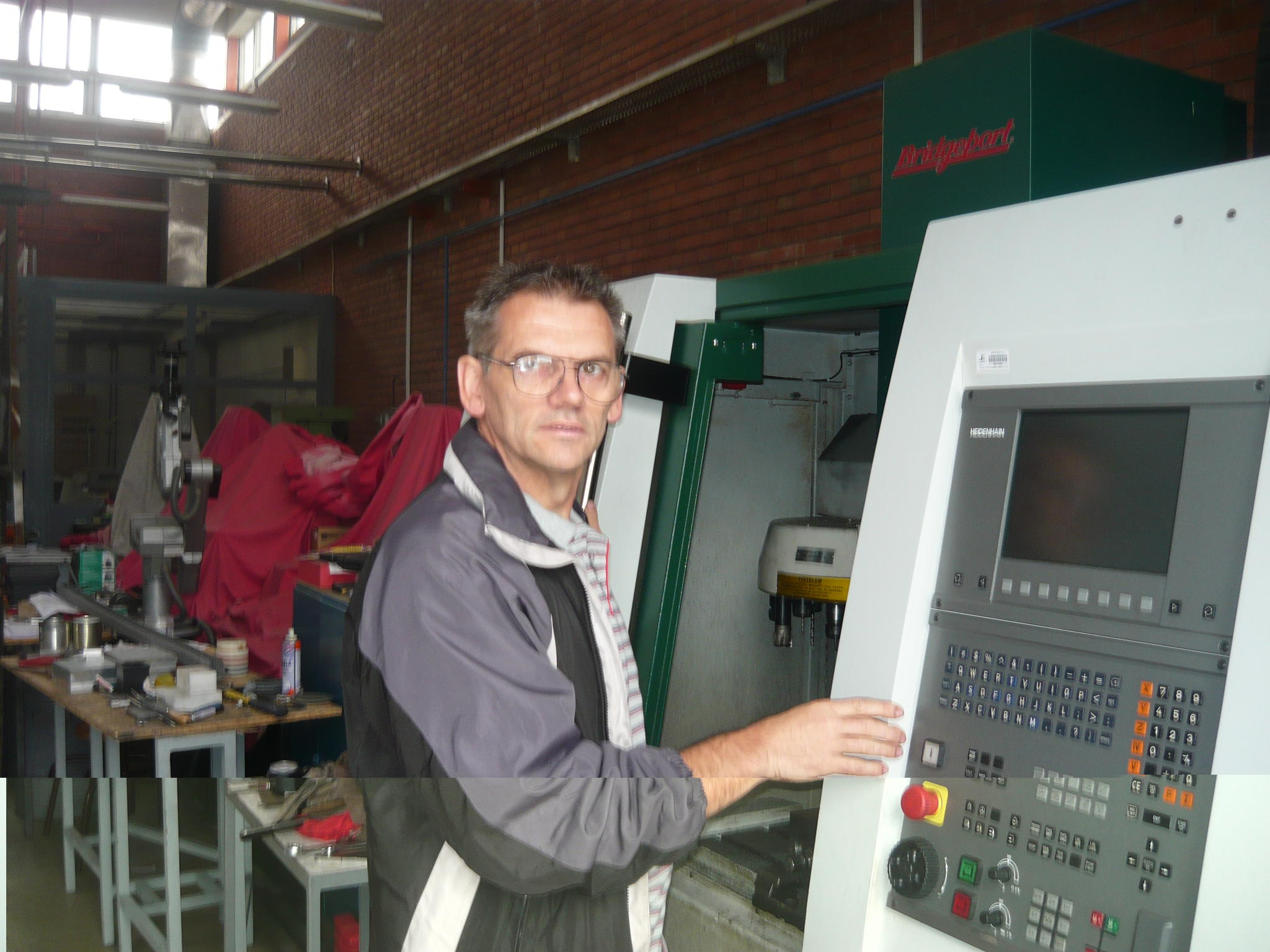

Hi Guys,
A friend of mine rents a machine shop with a Bridgeport VMC.
At a very short temporary main power failure the main power supply unit went wrong.
At the moment I do not have picture of it only the machine I can show.
Heidenhain in Germany would repair it on a cost of 4000 EUR.
Have one of you experienced with this issue?
http://www.mycncuk.com/attachment.ph...id=14159&stc=1

How do they know what's wrong with it, so that they are able to quote a repair cost ?
It looks like a 3 phase machine, maybe one or two of the fuses have blown, which is a common fault with some power failures.
