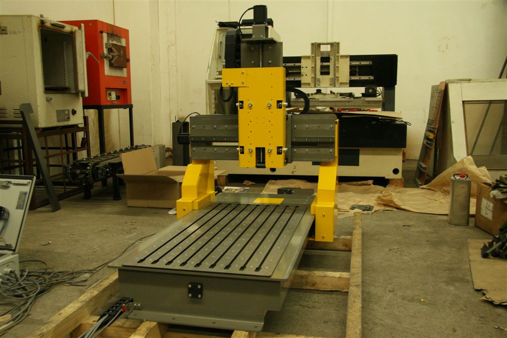

For milling, even DIY costs ca 3000 (without spindle)
Mine can do also steel (not very good). It is good for Al and wood. 800 x 1000 x 200
Attachment 20842
