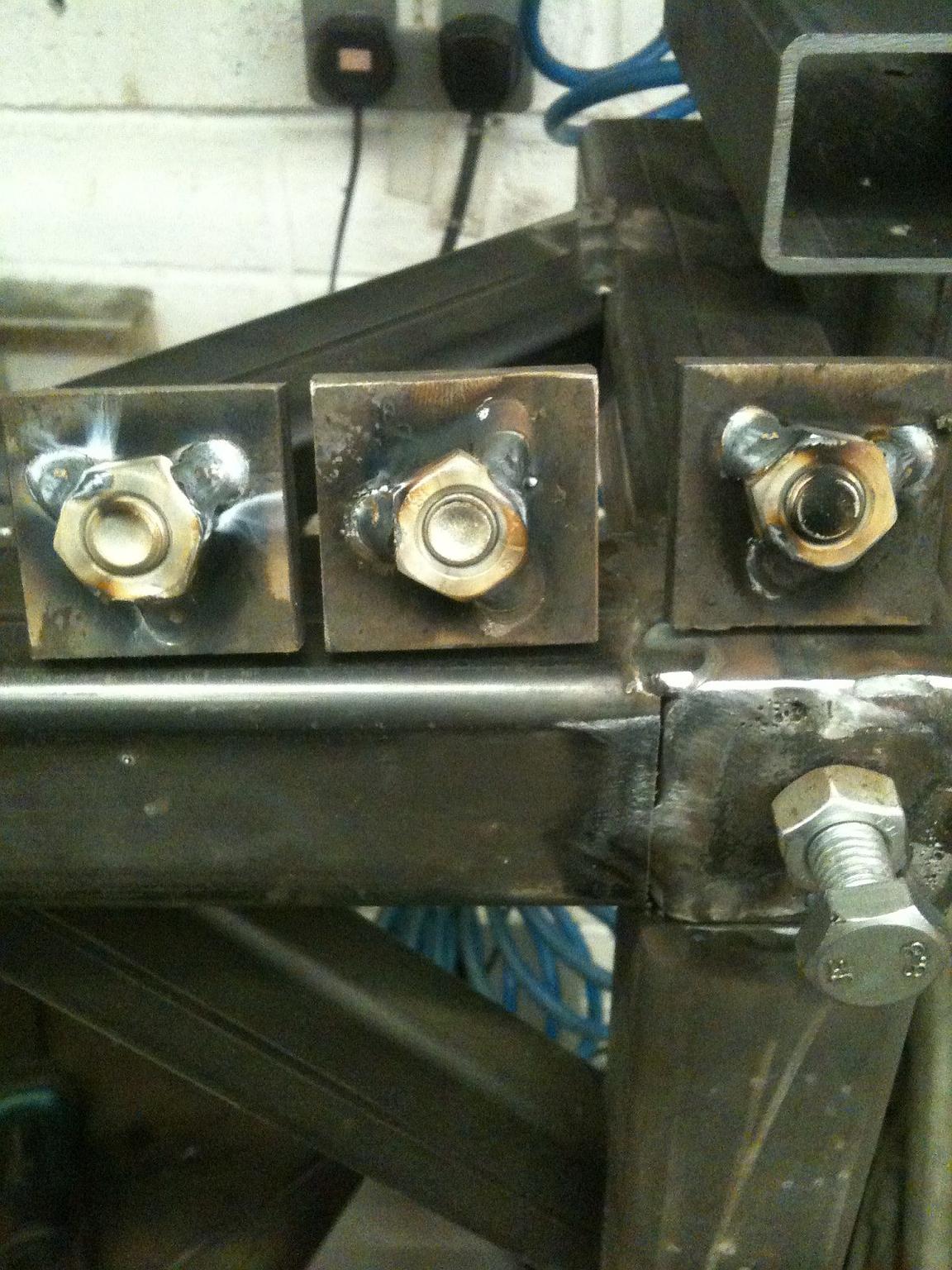

I did a similar thing but mine rely on the weld to support the weight. Pic below shows the nuts tacked in, I welded on all sides of the nut in the end.
Attachment 16226
At the moment they've got machine feet in them but ultimately will be used to secure the machine to the inclined frame...
