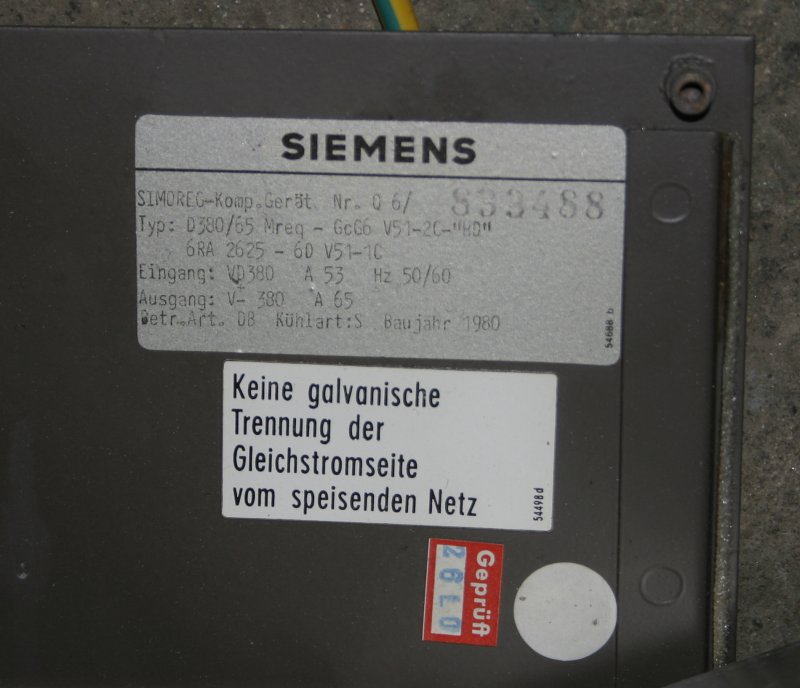

Unfortunately, I can't open the pdf. Eventually I have a big DC-Motor for you, but before I can see, what machine you use, I don't know if its to big. the little Motor have some 22kw and the electronic part is also here. But I have no clue, how you must it wire, to the other machine parts.

How long is the motor running, because its a brushed motor you must regularly
change the brushes and remove the dust from them. can you tst the motor, if its running, I have tested my big motor, it runs really slow with a simple battery loader from a car. Or better, you need 2 times a tension 1 to the stator, the other to the anchor, or whats the name for the rotor in englisch.
I have the electronic part from Siemens.Attachment 16474
But how is the harness from this part, it has feeled 1000s of cables go to and from.

The different offers in the net say from 15 to 19kg, also not to heavy to ship it with DHL or other parcel services.
Or you come next pentecoste to the Siebenbürger Treffen here.
