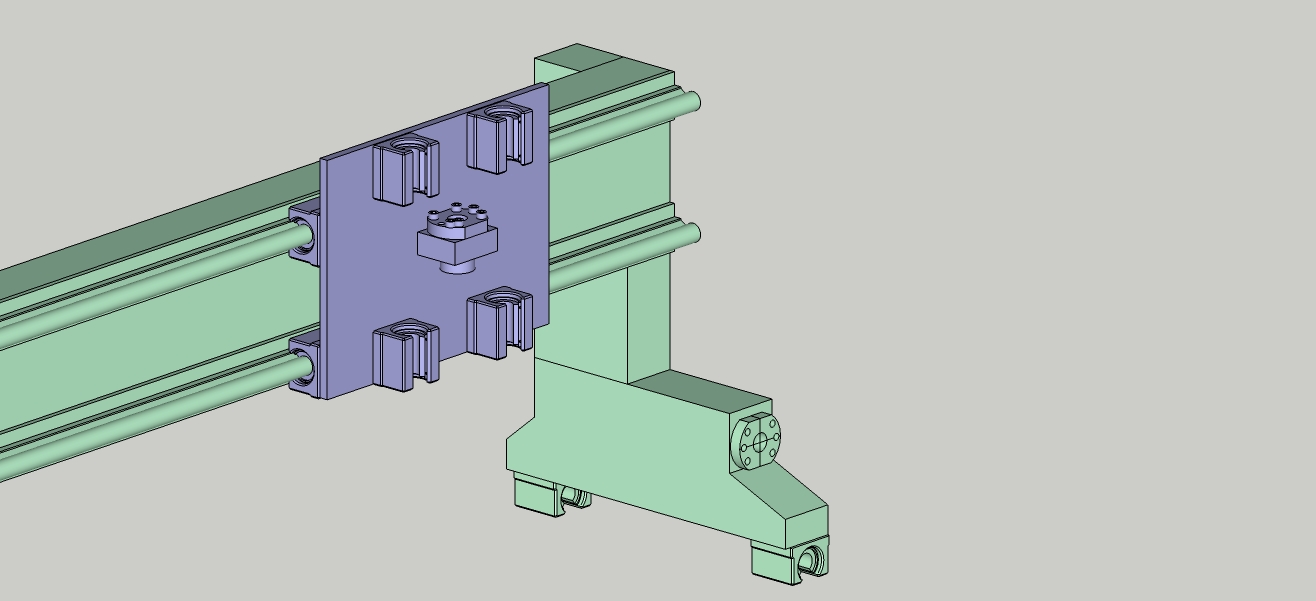

hi , a bit off topic but can these rails be used on their side? Attachment 16618
Re: Supported rail running "unsmooth"...
outtastep
Attachment 16618
Yes
