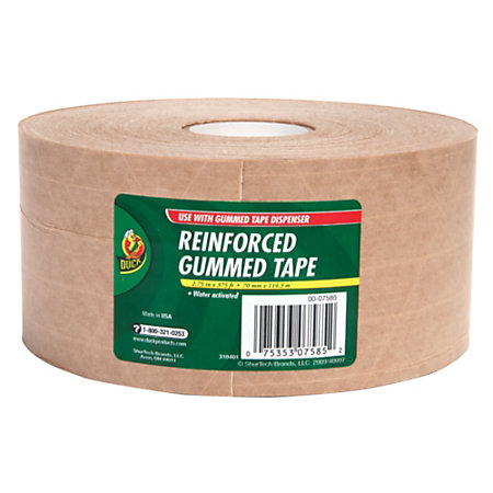

Any packing shop online will sell you a paper packing tape which is fiber reinforced. You can not break the damn thing even if you want to. Typically comes 50mm wide/ ~2 inch/
Its called shipping tape, reinforced kraft tape, packing paper tape, ...
Attachment 17575
