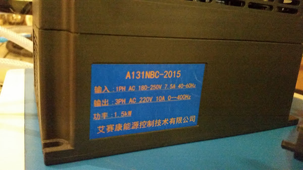

I'm just at the the first turn on of the 1.5kW VFD and am unsure of what I need to set up before I click run for the first time.. The "instructions" that cam with the 6040 just say to turn on and ramp up up the knob (mine doesn't have a knob)..
There are some videos on youtube walking you through what to setup but with very little information about what they're actually doing. So I'm a little hesistant to walk into something blind.. Also I don't see my specific unit.. 1.5kW 220V spindle A131NBC-2015 (edit: name)
Obviosuly there's certain settings like ramp up time etc. that I can tweak at a later date but for first turn on to test everything, is there something in particular I should be setting up before I click run? Wouldn't want to break something..
At the moment it is flashing 400.00

No manufacturer name.. just says: a131nbc-2015
Attachment 17576

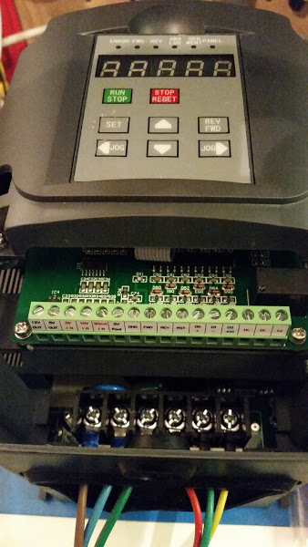

Show the front please.
Re: Checks before first run of VFD
Attachment 17577
Another pic. I can open it up too if needed... I can't seem to find any info on this particular model.

Ok well I've had one of these before and it's already setup ready to go. Thou it looks like Huanyang VFD it's actually a copy so don't use any of the Huanyang info you see.

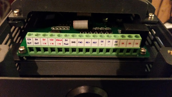

By GND I mean the terminal block labelled GND.. (My picture was horrendous so no labels could be seen, apologies.. here's another) That is isolated from the mains earth yes..
Attachment 17578
Is that what you are saying too or are you saying not to use that GND?
I was going to use that GND as reference for both the speed control and the relay to turn the spindle off and on (run)..
Is there anything else that is useful to wire into these terminal blocks? Or just speed and run?
(Actually, just spotted it's a 12V OUT that's available.. will I need to put a dropping resistor in or is it ok with 12V?)
