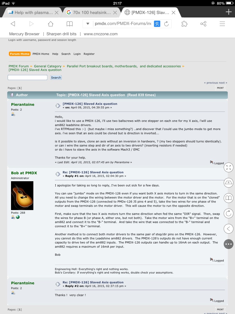

Re: Help with plasma controller build
An axis can be cloned but the direction of the clone is the opposite directionso phases need switching Attachment 18510
Lewywri89
Attachment 18510
Ok if you are happy BUT can you home them individually to square the gantry!!!
