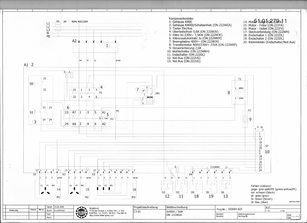

This is an electrical drawing of my C3-31 Hammer (Felder) combination machine.
A few days ago it started tripping the MCB32A trip, which progressively got worse, on
any of the motors (Saw, planner, spindle moulder) until it would not work at all.

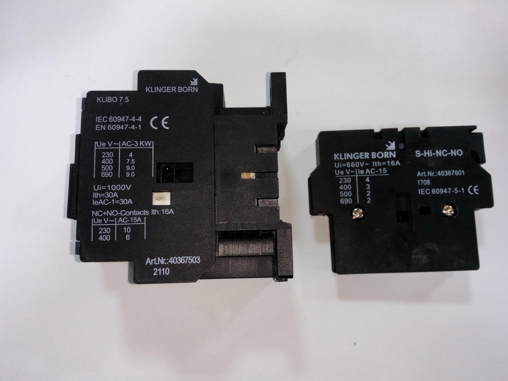

Suspected contactors, on enquiring with manufacturer was informed they only supply
complete enclosures A1 item 2 on drawing at £500.
So decided to purchase equivalent contactor and axillary contactor and fit.
Result was it would work if I unplugged the motor. (Contactor would pull in)
But if motors plunged in would sometimes work on Saw, but most of the time contactors "chattered"
some times holding in and sometimes tripping MCB332A trip.
The safety limits and stops are the same as a cnc machines so they should not be a problem.
I have tried bypassing the overload protection - no effect.
My suspicions are the braking circuit board, as I believe this works by injecting current back into
the motor to produce a magnetic field to stoop the motor quickly. Has this broken?
Causing some load to prevent the contactors working correctly?
Any help greatly appreciated before I fork out the £500.

		Break the connection of the braking circuit to the motor and test.
Fault finding is a process of logical elimination, not speculation, the fact that multiple motors suffer the same issue suggests it isn't the motors but it can still be any other common component.
Are the motors single or 3 phase?
I'm sure it's clear on the schematic and DC injection braking is a 3-phase technique but you should post the schematic the right way up and at good resolution if you expect anyone to examine it closely, if you can't be bothered......... ;-)
Regards,
Nick

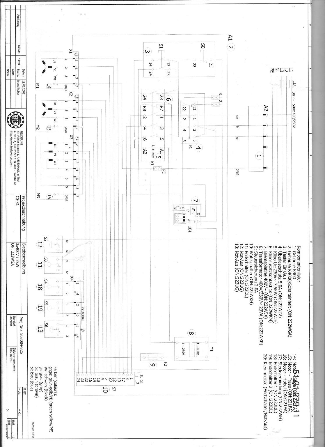

Drawing any better Nick?
Translation from German:
1 	Home
2	Switching Unit
3	On Off Switch
4	Overload Protection
5	Contactor
6	Auxiliary Contactor
7	Braking Circuit
8	Transformer
9	Fuse
10	Selector Switch
11	Limit Switch
12	Emergency Stop
13	Emergency Stop
14	Motor – Saw
15	Motor – Spindle Moulder
16	Motor – Planer
17	Plug
18	Limit Switch
19	Limit Switch
20	Terminal Strip

		Is the coil voltage correct on your replacement contactor ? it shows 230v AC on the drawing, have you checked the voltage at the coil with a meter while it's chattering ?
 Here is the replacement contactor details https://chaloncomponents.co.uk/produ...oltage=230v-ac
I will check while chattering.

The drawing is one of the worst I've seen and it's not easy, for me anyway, to determine exactly what's going on, and I've used some complex drawing in the past.
I've attached a copy of the single phase version if it helps sort this out, (not studied it yet though)

What I can't really make out from the wiring diagram, is are the top right wires, and lower left side wires on the braking module directly connected (I'm guessing each wire has a separate terminal, but are the terminals paired together? - A photo might help)
However, I think if you remove the link between R8 and 4 on the contactor, it'll be enough to break the circuit for the braking.

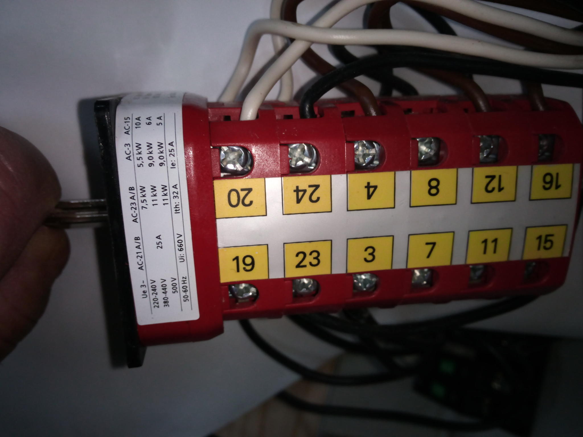

Do you have a diagram for the selector switch, as it would help understand exactly what's going on?
Assuming the selector switch is just a switch, with no relays/contactors to control things, then the key to the braking circuit is how the 3rd leg is handled. It is controlled via the auxiliary contact (other two legs go via the main contacts, with the third main contact used as the latch for the start button - the start button second contact also bypasses the aux. contact, which I assume also ensures the braking module remain inactive until the contactor is fully energised), but goes to the braking module, before heading to the selector switch, unlike the other two legs that go straight to the selector switch.
The braking module is also connected to the 2nd leg output from the contactor (terminal 4), via the NC contact (R8), so when the contactor is energised, the braking circuit is broken, but once the contactor is de-energised, the braking module is connected to the 2nd and 3rd legs on the motor side. By breaking the 4/R8 link, it should prevent the module from braking (which I'm assuming is done either via DC injection braking, or controlled shorting of the legs).

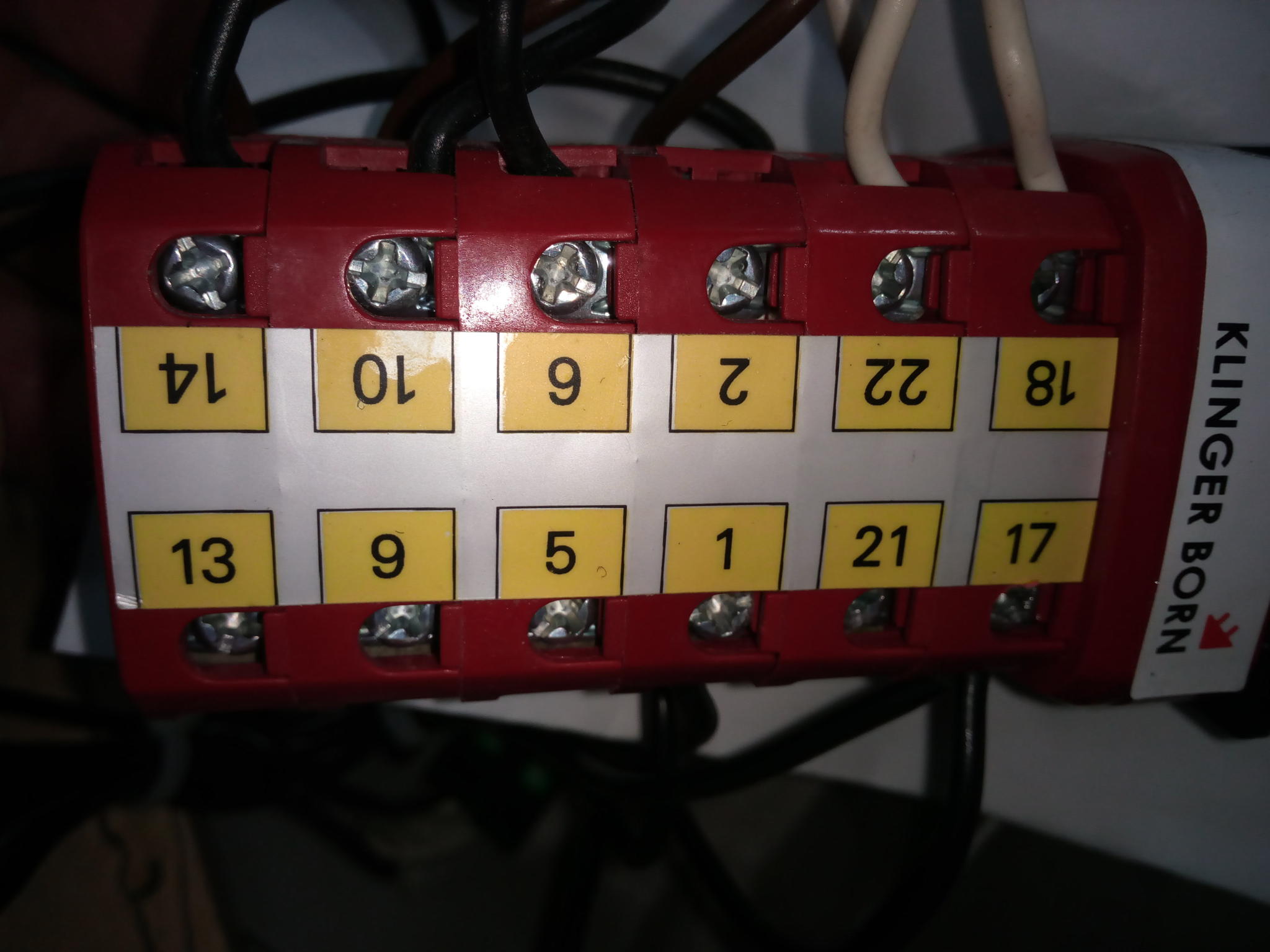

 No they do not.
(1 and 2) and (3 and 4) closed all the time (NO) even if you manually opperate contactor.
ONLY when Planer and Spindle Moulder selected.
When Saw selected all contacts operate as expected.
EddyCurrent
			Plug the machine in and press start and see if the contactor pulls in and holds
Now with a voltmeter I would test to see if we are getting 3 phases (full voltage) at the disconnected motor leads.
 Yes it pulls in and holds.
Yes 440v - 460v out of three wires at plug to motor.
Does this point to item 10 the selector switch?

Here is a picture of the original contacts and auxiliary, I've split them apart so you can see the information.
I can not see that they have a 1 second delay, can you? Attachment 23316
 See pictures - Yes the wires are connected on the PCB board, paired together as you thought, I checked them with "the tester"
Other red wire goes to 24 and brown to R7
Also see pictures of rotary switch, you may be able to work out how it works. It could be the issue if you see my other post to Mr EddycurrantAttachment 23317Attachment 23318Attachment 23319

Operation of the brake looks like this to me.
If there is voltage or has been voltage at terminal SP (even briefly) and there is a circuit from C1 through the motor winding back to L3 (i.e. contactor has just been de-energised) then brake.
If there is voltage at terminal SP (even briefly) and there is no circuit from C1 through the motor winding back to L3 (i.e. contactor energised) then do not brake.
If there is no voltage at terminal SP (or a brake operation has just completed) and there is a circuit from C1 through the motor winding back to L3 then do not brake.
This also explains why the brake will activate if 'start' is pressed while an e/stop is activated. Start button contact 23/24 apply voltage to SP briefly when pressed but the contactor is de-energised.

		The rotary switch (10) has 4 positions.
1. Saw
2. spindle moulder forward
3. spindle moulder reverse
4. planer
It's hard to see why there should be the difference in readings across the contactor as the assumption is that switch 10 just swaps motors.

		The rotary switch.
1 - L1
3 - L2
17 - L3
10 -  Saw Motor U1
12 -  Saw Motor V1
20 - Saw Motor W1
6 - Moulder Motor U1
4 - Moulder Motor V1
18 - Moulder Motor W1
14 - Planer Motor U1
16 - Planer Motor V1
22 - Planer Motor W1
23 - 230v control
24 - 230v control
This is how I would expect the switching to be.
in Saw position, L1,L2,L3 will be connected to the saw motor only
in Moulder Fwd position, L1,L2,L3 will be connected to the moulder motor only
in Moulder Rev position, L1,L2,L3 will be connected to the moulder motor only, but two phases will have been swapped over
in Planer position, L1,L2,L3 will be connected to the planer motor only
in all positions terminals 23 and 24 will be connected in order to complete the 230v control circuit.
It probably goes through the switch because the contact between 23 and 24 will go open circuit between positions
thus dropping the contactor out if the switch is moved while a motor is running.
That being the case it should be fairly easy, though laborious, to test it.
1. Mark up the wires securely, you don't want a label dropping off, masking tape works okay.
2. Also take however many photos it needs to be sure all the wires will go back in the same position (there may be links from one terminal to another, leave them in place)
3. remove the wires and test the switch arrangement using terminals 1,3,17 as the reference terminals, make good notes with pen and paper.
For each position of the switch make a note of;
a) which terminals are connected to terminal 1
b) which terminals are connected to terminal 3
c) which terminals are connected to terminal 17
d) state of terminals 23 to 24
4. do the results match what we think it should be ? (using the information above)
Sorry if my instructions seem childish, I've learned the hard way (many call outs through night) that leaving easy to follow unambiguous instructions is the best way to achieve success (and let me get a nights sleep, although all that is past me now)
