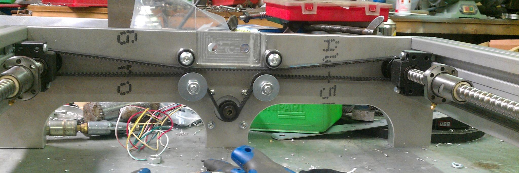

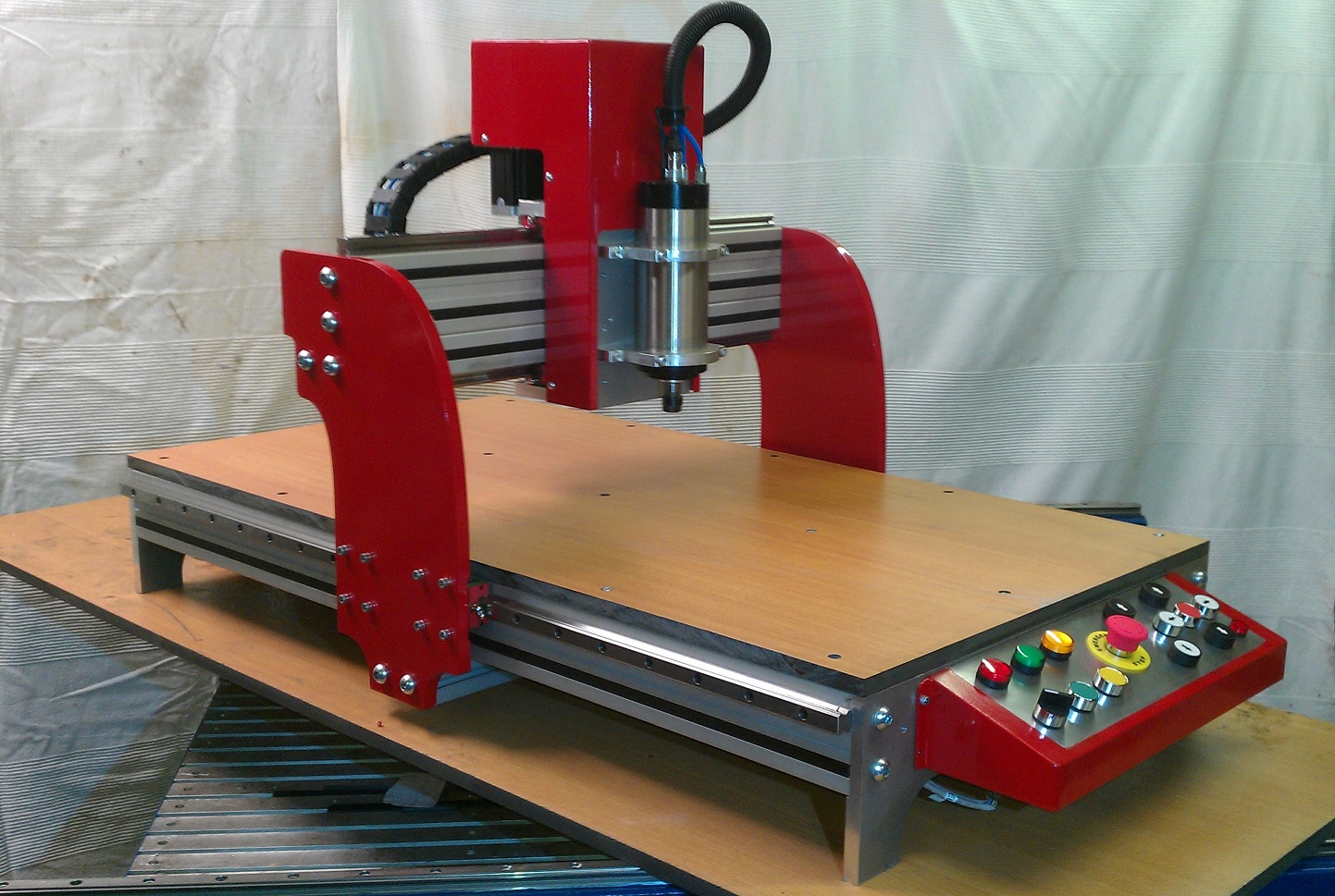

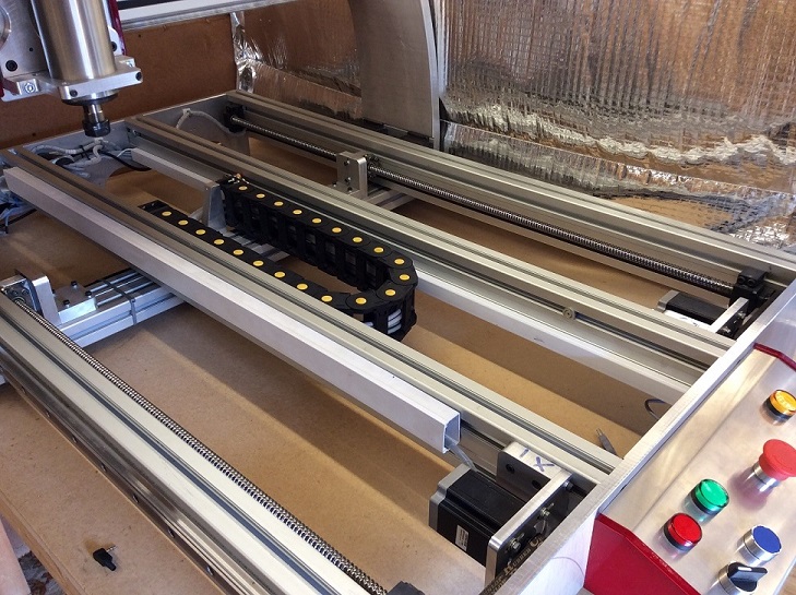

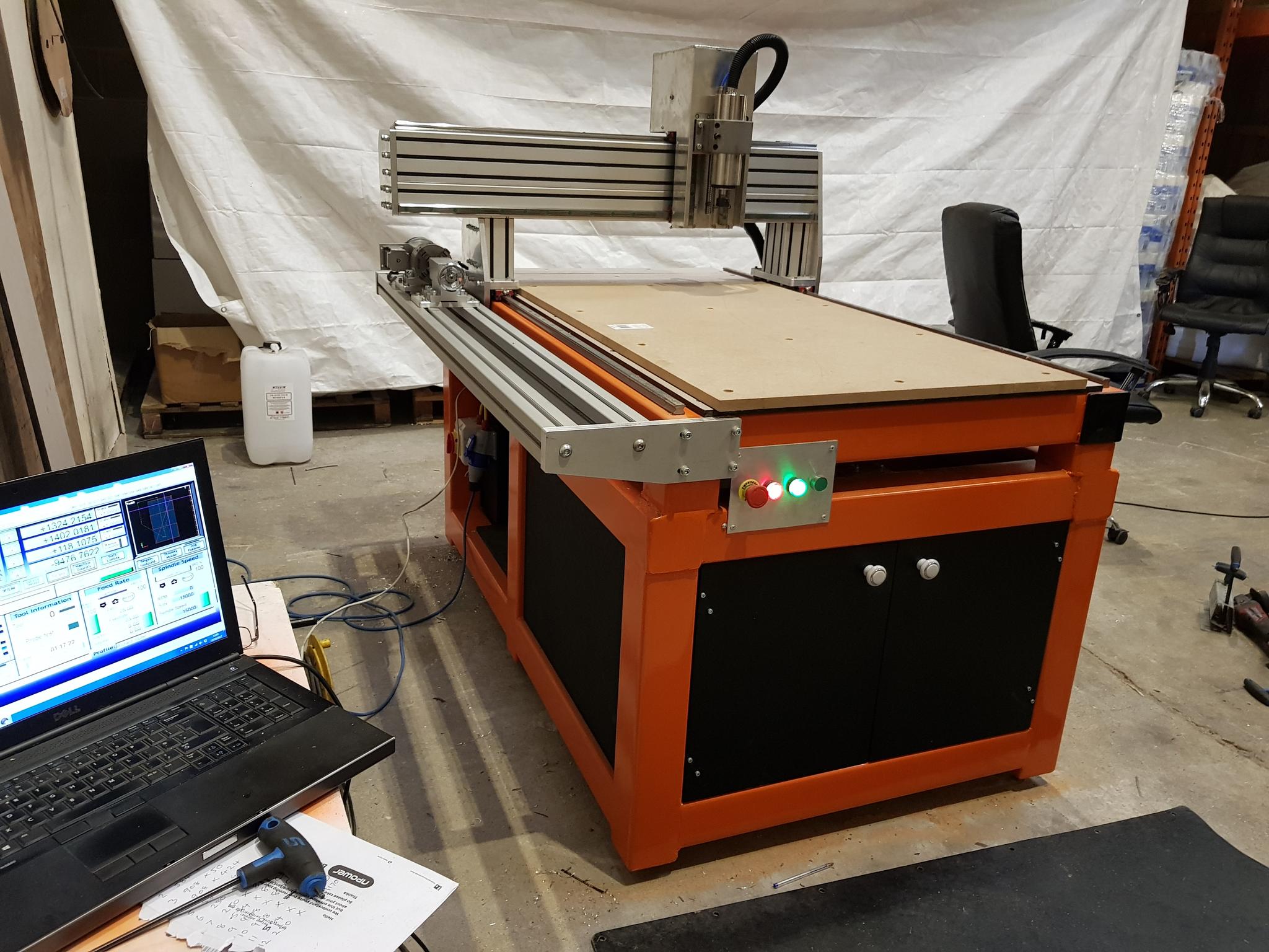

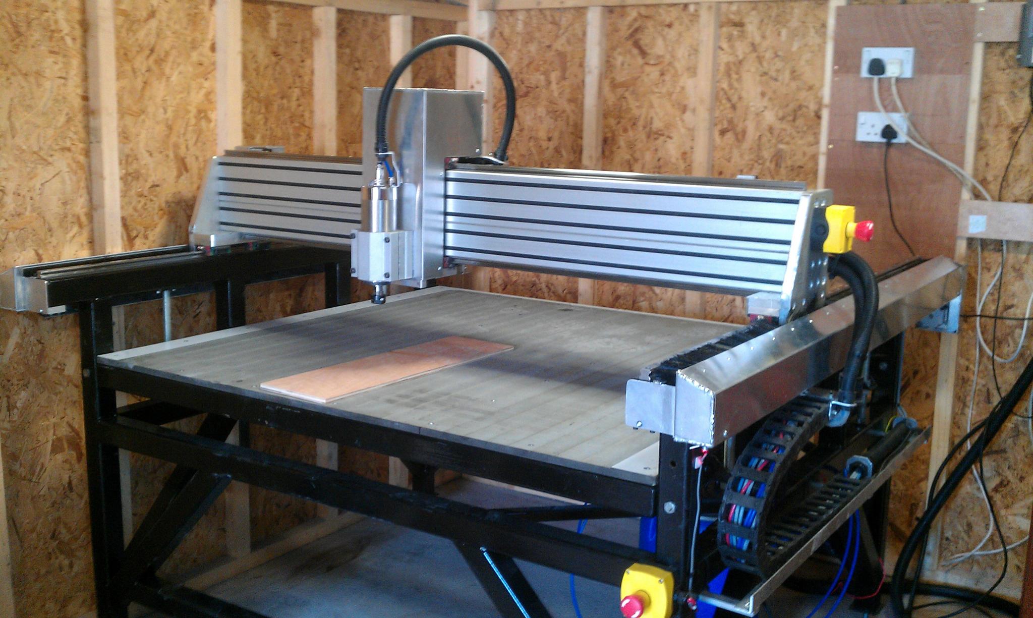

3 Attachment(s)
		Re: Lowcost capable CNC - Make vs Buy?
Andrewg
			 Mechanics
Ballscrews all round, but only 3
Single Y ballscrew will save a bit of budget, however I do need to cut ends of boards set vertically. With an under-table ballscrew and cross brace, I will needs to have the spindle sitting forward of the bearings enough to do this. I only need 65mm of cut distance beyond table. Is that a sensible design option?
 Single or double ball screws it doesn't make any difference to if you can overhang or not. This is down to gantry design.
Many will sweep the gantry beam back from the centre of the bearing plates to recover lost tablespace. However, in your case this can't be done because you need the spindle to project past the end of the bed so your better with the gantry beam inline with the bearing plates.
There are other design methods, like having the long axis frame rails extend past the end of the bed. In this way you can have both methods and have any overhang amount you like(within reason). The cost is it takes up more physical room and slightly longer rails which cost more money.
I've used this design on several machines so that a 4th axis can be used on the end for turning and fluting etc. The same can be done with extending the gantry at one side and using the length of machine for longer work. (See pics)
Andrewg
			Gantry
I get the material in the slots to lock the two extrusions together, but see that 10mm aluminium bar is not a standard size so what to use? Options seem to be either machine a ½” aluminum bar down to 10mm slot size on a router table or forget  the slot filler and have multiple bolts. By creating a gantry length ‘washer’ with regular clearance holes along it, I could use it as a guide to drill the access holes in the lower extrusion, then install bolts in it to mate with slot  nuts in the upper extrusion, so they are bolted every 50mm or so. Avoids having to machine material to tolerance?
 Your way way over thinking this.!! . . .  For machine this size it's not required. To be honest at this size you would get away with NO bolts. If not using the spacer method then 2 x M10 bolts spaced evenly along length and tapped into the upper profile will be more than enough.
Andrewg
			Electrics
Tempted by closed loop steppers - looks like for 2nm nema23 steppers it is about £40 stepper plus £20 driver vs £80 for closed loop motor and driver, so maybe extra £20 per axis well spent. Where will I see the benefit besides getting error rather than inaccuracy due to missed steps?
 Depending on which you get then the main differences will be smoothness and speed/torque.

 Don't use 15mm for the Z-axis as it makes more difficult to build regards clearances and they are fiddly. 20mm cost very little extra and make for a much stronger and easier to build Z-axis.
Whatever you do don't cut corners on the Z-axis, it's THE one area you don't want to get wrong because it holds the tools so if it flexes or vibrates this will be seen in your work.!
Below are 2 machine designs, both can be single or twin screws and placed under the bed for protection. The larger one will extend past the end of the bed and the side, it also adjustable length 4th axis.
Edit: also a larger version with extended side rails for more front extension.
Attachment 27791         Attachment 27792   Attachment 27793

  Attachment 27792
Yes this is what I aspire to:Neat, clean, capable looking machine!
From your previous posts I am assuming I am looking at
- 45x90 extrusions on Y axis with two for the L gantry.
- 12mm Plate for ends and gantry sides
- 20mm linear rails all axis
- 1610 ballscrew, 1605 on Z driven via belt and pulleys so steppers can be tucked out of sight, 1: 1 gearing? is it worth added parts?
A little worried about the X/Z carriage getting complicated. If rails on front face and ballscrew on top, then couldn't it be a single plate again?
I am assuming this design cannot cut beyond the table, but by removing the gantry sweep back and maybe mounting the rails on the face of the gantry (and removing the control panel) I could create sufficient over run.
 Again feedback from real experience appreciated. How much should I be worried about keeping Z axis weight down? I was assuming that on a small machine, I want to keep the weight being flung about to a minimum to ensure good acceleration and performance whilst allowing modest (lower cost) motors and drivers to be spec-ed.

 Yes 45 x 90 with 10mm slot Bosch Rexroth or equivalent with this style of machine. This is type and size is required to allow easy fitting ball screws because the slots match up with Bk12 bearing blocks so no extra plates are required.
12mm could be used for the end plates but I wouldn't use it for the gantry sides and Z-axis. Normaly I would use 15mm for the end plates and making motor mounts etc and use 20mm for the gantry sides and the Z-axis.
Andrewg
 Well yes and No.
Yes could be done but with this design, it compromises the machine in other ways. Rails on the front face only mean the distance between the rails is narrow so there's less support to the Z-axis rear plate.
Next the ball screw on the top means extra plates will be required so the bearings can be mounted, this means extra work and it also raises the screw high up the Z-axis rear plate causing an imbalance in how the forces are applied.
Andrewg
			I am assuming this design cannot cut beyond the table, but by removing the gantry sweep back and maybe mounting the rails on the face of the gantry (and removing the control panel) I could create sufficient overrun.
 No, it can't, well it does but not by much. This design doesn't suit cutting past the front. If you want to cut past the front then use a gantry design like what's used on the other machine along with a slightly different base frame for rail placement.
That machine uses ITEM style profile 120 x 80 with an 8mm slot. It makes a very stiff gantry and if you look closely you'll see one rail is on the front face and the other is on the top.
If you like I could quickly knock you up a model of how it would look.?

So the X/Z carriage with rails top and bottom and ballscrew behind, ends up being an inverted G rather than C - do you have a picture of the back?

So Jazz..what does that orange beauty look like from behind?
Andrewg
 Here you go watch this.

		So I am still mulling design options
Is there something wrong with me finding the sight of Dean's machine undresses slightly arousing?! I certainly now 'get' the neatness and economy of this single leadscrew Y axis design: Standard BK.LK12 bearings mounting 1610 leadscrew on underside of 45x90 central heavy extrusion, motor tucked away by addition of GT timing belt and 1:1 pulleys. With single traveling homing/limit sensor fitted to Y axis under-gantry and drag chain safely out of the way under table......very nice.
 Yes.

6. X Axis - L shaped gantry design. Rails on top/bottom of front of gantry. Ball screw on back. L from two 45x90 Bosch style extrusions allow BHK/BF12 bearings for ballscrew to mount directly to it, as does 20mm rails.
7. Z axis/X plate - Z axis is simple challenge of sandwiching rilsa and ballscrews between two plates, with 20mm raisl 15mm narrower than ballscrew assembly. X plate more complicated
8. Spindle - 2.2kw water cooler spindle seems standard, mostly as the ER20 collet takes up to 1/2in router bits and is quiet for long runs. I'm still wondering if this is overkill for wood cutting where max of 8mm cutters might be enough for most jobs.
9 Steppers - You need power not so much for speed as acceleration. Closed loop are now more affordably and give more power, smoother/quieter running and accuracy/safety as they will error if steps lost rather than spoiling project and/ ripping machine appart in accident! High voltage and low inductance motors allow the power to be delivered, so motors and drivers can be selected appropriate - 3Nm Nema 23 or bigger probably;y required
10 Wiring and control box - Each step is simple but there is a lot of it. Drag chains,earthing, connectors, safe separation of mains and low voltage. Electrical
 interference, especially if there is a VFD for the spindle. etc Know little at this time about this area so much more work needed to define.
So before I order my rails+ballscrews set and my steppers plus driver from Aliexpress, my extrusions from Motedis and my controller from UNCNC. I need to be confident I have a design and and a route to the required machined Aluminium plates to pull it all together along with abuild approach (as you pint out, and I have only recently picked up - alignment of rails etc is critical)
SO another too long brain dump - you can see why I need to get this out, ti feels 2/3 complete but mising bits...back to CAD
