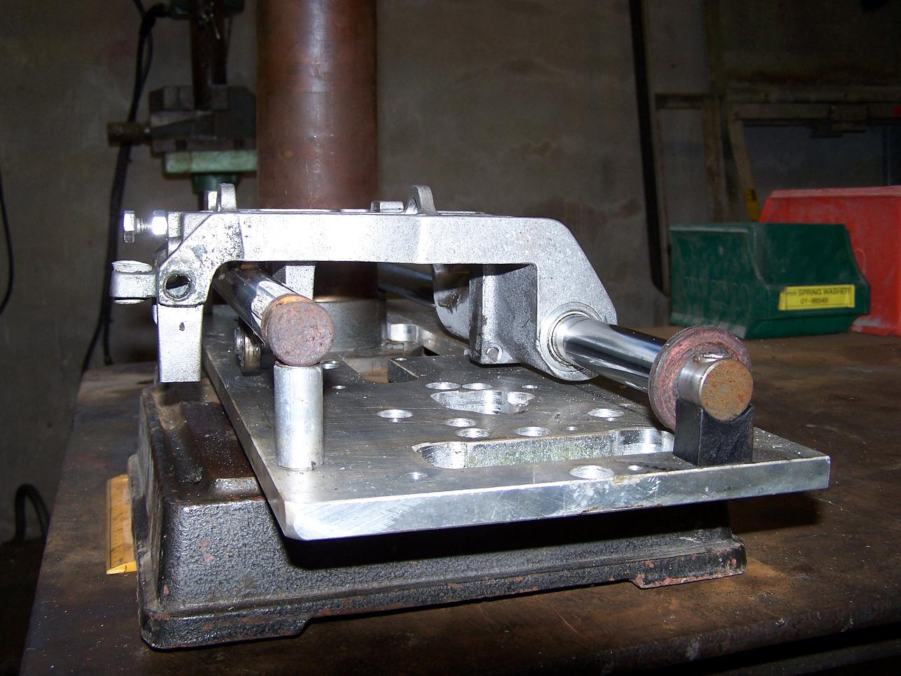

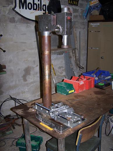

		Ok worked out how to attach photos, sorry Lee if it isnt the prefered way with the media centre.
here is the pillar drill with x axis attached
Attachment 463
I plan to cut down the upright once i know the height needed
Attachment 464

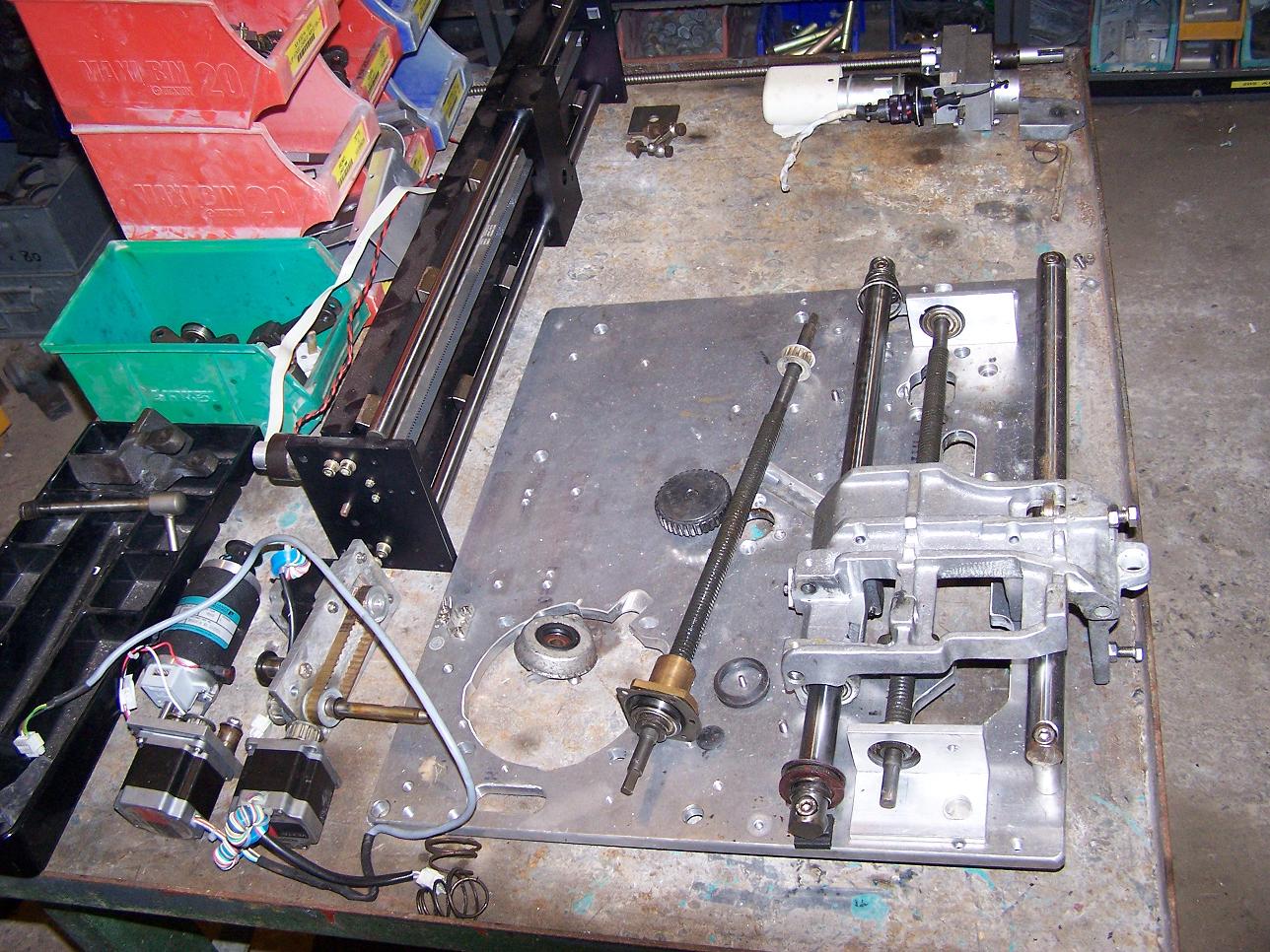

The rails are 22mm and have a solid brushing on one side and a skate bearing set up on the other side
Attachment 466

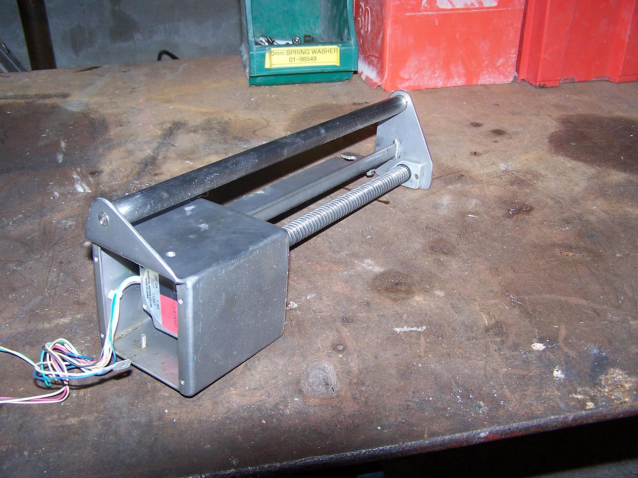

This is the the y axis,once its cut down, with the 3mm lead screws
Attachment 468
This is the drive from the machine but it only has a half drive nut and not enough travel, any one know if you can get a acme nut for a 16mm dia. with 4mm pitch?
Attachment 465

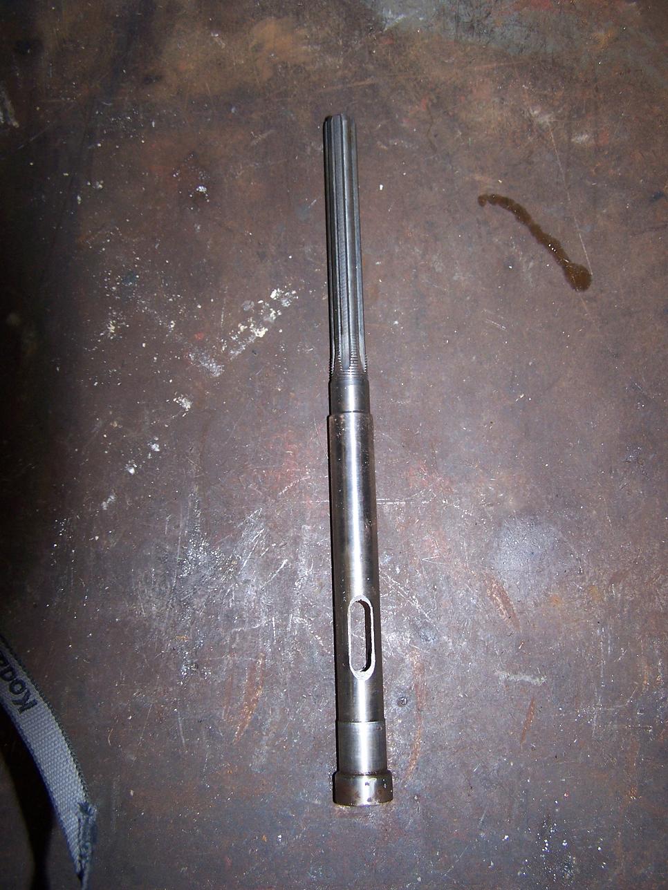

And the biggest problem is the quill. The bearings are shot so I plan to get new taper bearings anyway. I have a couple of ideas to mount a collet chuck.
1. get a 2no. taper ER25 collet chuck and dowel/glue it to the quill through the knock out hole(if thats what it is called)
2. use a 20mm straight shank collet chuck to got through the bearings and then cut and turn down the qull to preload the bearings and secure the collet, leaving the spline section to function
3. the most favourable, but hardest to acheive, is to use an ER 25 morse taper collet and drill down the centre of the quill to fit a drawbar. not sure if this will leave enougth strength in the quill.
Any way I had better stop now before you all fall asleep:heehee:

			Did I see one of Bungalowdogs ballscrews there? What diameter is the splined end of the quill...and what taper is it?
 Kip
Dam you have good eye sight, it is a bungalowdog ballscrew, bought it before I saw the coments on here about how usless it might be, Shed load of backlash in the reduction gears, need to isolate the ballscrew to check that, but it dosnt look up to much.
The quill is a morse 2 taper and the spline is 14.75mm outside dia. and an effective dia. of 11.25mm minus the splines and would require a 225mm long drill bit. The collet chucks have an M10 thread so would need sleeving I presume.
Im a little concerned about the quality of the internal taper on the quill so was wondering if I could cut the end off and put an M10 thread on that and screw it in to 20mm straight shank holder? or will I have allignment problems and is it likely to shear off under load?

Out of interest what would be the biggest size hole for the centre of the quill? Maybe I can get it done locally. The other option is to forget the collet chuck and just use it for accurate drilling :smile:
Re: Help with drill-Mill conversion
		The draw-bar hole in my (MT3) ER32 collet chuck goes right through. If your chuck is the same, you could always screw up, through the chuck, into the spindle (with a smaller bolt). I find I don't need to tighten the draw bar on my morse taper quill quite as tight as on most R8 devices, since the taper is fairly secure on its own. I'd have thought that a long M6/M8 allen bolt would hold the chuck in place perfectly well for light use.

		Bill, just re-read your first post and realised you suggested mounting the chuck from underneath then, sorry I didnt twig.
Anyway just ordered the angular contact bearings for the spindle and found a suitable ER collect chuck. But not sure wether to go for the ER32 on a morse 2 taper so i can use the collets on the big mill when I make it.
Any one know if will this be ok on that size taper? and In reallity will I need 20mm capacity for milling Ali?

		Cheers, so I probably need a lock nut as well then? The original one just squeezed the inner race on to the step on the shaft.
The other problem is how to drill the hole in to the end of the quill for the chuck lock bolt. I foolishly thought it would fit in the lathe but that also has an M2 taper, Duh
Is it safe/accurate to hold a drill bit (facing up) in a vise and lower the quill down over it?
Ross77
 Safe - maybe if you can hold it tightly - drills have been used as lathes by holding the tooling in a vice and the workpiece in the chuck (I've done it).
Accuracy, its hard to see how you'd get the drill absolutely in-line with the quill.  Here's an idea tho.
Acquire a block of MS say 50mm cubed.  Drill an M4 tapping hole through the center of one face and tap M4.  Put the cube in the vice with the M4 hole horizontal and accessible through the side of the vice jaws then drill down through the centre of the face with the drill you want to use to drill the quill.  Remove the drill and without moving the vice put the drill shaft in the hole and lock in with a M4 bolt.
Remove the chuck and lower the quill onto the drill...  careful with speeds and use coolant if poss.
You might need to grind a flat on the drill shaft to locate with the locking bolt.
The accuracy depends on how square the chuck was to the quill initially...

Ross, What's the end of the quill look like? e.g. does it have a centre spot  from the taper machining operation?
 Actually, your clever plan means the new drill 'chuck' will be properly aligned with the quill travel regardless of vice alignment.

		Added thoughts...
Size of block = size of drill x 2-ish  need enough metal for the locking bolt to remain rigid
If drill shaft < drill size (as it might be if its a big drill) then drill out the hole shaft sized first then use the proper drill to bore down 10-15mm to provide a locating seat... then remove drill etc as before....
Ally instead of MS...  can't see why not, maybe go for a bit more 'meat' on it.  Only issue might be getting a good lock on the drill...  if you never want to use the drill again without some effort you could try loctite in the hole!

Hang on, reality check.
Just how long is this drill bit?
Sounds like it has to reach up through the morse taper, past the taper knockout slot and then all the way up through the quill?
You reckon this pipe auger is going to start on centre without some kind of guide bushing :heehee:
		Uhmm. How do I say this.........
It dose fit in the lathe. :redface: I forgot the splined end was narrower than the 20mm shank at the taper. Just fits in far enough, about 25mm projecting from the chuck.
SORRY,SORRY, SORRY
 Not all the way through as this was the point, securing the collet chuck from the underneath, 90mm for the taper and knock out section + shank in chuck + depth of hole for new bolt thread. so long enough.
		Finally got some workshop time this evening and finished setting up the lathe. :dance:
Spent 30mins centering the quill in the 4 jaw chuck. What a nightmare!think Ive got it sorted now. (when I realised that 0.001" run out is F**k all) Ive drilled out the knockout slot to 10mm and created a start point for the tap drill.
The hole through the ER chuck is about 9mm , so the max bolt size I can use is M8, Problem is getting a drill bit and Tap that will reach the 150mm
required.......
Any one know of a source of long reach taps? or will i have to make up some sort of extension bar?

 Let me get this right...  you're drilling out the quill to allow a draw bar through to pull the ER collet chuck into the quill...  so what are you planning to tap?  did I miss something?
 I decided against drilling all the way through the quill as I could only get a 6mm hole through the splined section and the chuck needs M10, resulting in a long thin drawbar and some sort of thresd adaptor.
Bill suggested drilling from the chuck end up into the quill and then use a bolt through the chuck to secure it (similar to some drill chucks)
So i need to to drill a 7.5mm hole in the quill and then tap it for M8, dose that make sense?
		Can't you just put a fancy nut through the taper knockout slot and save driling anything?
 with the extra long tap at £7 and probably the same for the correct drill bit.  That's looking like a good idea, it's only a 10mm slot tho so M8 tread is pushing it a bit...
Would a M6 be good enough?

		M5 even, so long as you use a good quality screw and key. HT would be overkill, just avoid stainless and cheapies.
If you buy a box of screws you could torque one to destruction in a piece of scrap. Then you'd know :beer:
 Thanks Robin. HT ? high tensile?
			10mm slot width or height? It's ok to engineer a twist fit solution.....
 10mm wide. Approx 30mm high. What do you mean twist fit :question:

No extra space in a knock out slot to twist into, they are cut to fit the taper tang.
Hopefully you will have room between the spindle nose and the chuck so you can slip a fat spanner in the gap to lever it out.
OTOH you can cross that bridge when you come to it :beer:
		Yeah not worried about getting it back out. just as long as it stays in:dance:
Just cut a piece of steel to go in the knock out hole, but cant find my M5 tap, why is always the one you want that disapears in to thin air......
I'm going to try this route first, If it wont hold then I'll drill up into the quill from M8 bolt. I'll get some new taps tomorrow and a selection of bolts.
Let you know if it works................

		It will be a miracle if i ever finish this... with every day comes a new problem
Drilled and tapped the new key for M5 but cant find any bolts long enough. (125mm). Would studding be ok? The other option is to make up a small drawbar 8mm dia. to go thro the chuck then turn down the end for an M5 thread, problem is making it strong enough and providing some sort of slot in the head for tightening.
The next challenge is deciding wether to cut down the main post and fix the head at a set height or allow it move up and down to suit the job, like a proper mill :tongue: I will need to sort out a better clamp than the existing grub screw arrangement , may be cut a slot and then bolt up to pinch the main post? would this help remove the current play, and provide an accurate reposition when moved?
		Why did you abandon plans to drill & tap the quill?
Although, I think M5 should be OK. (you won't be taking it in and out all the time)
 Might work.
I'm happy with the way my [ame="http://www.cnczone.com/forums/showthread.php?t=70099"]wishbone stabiliser [/ame]works if you want to copy.
 Cost..lol the depth into the quill is over 100mm so I needed to buy extra long taps and drill bits. In hind sight it would have been worth it tho as it is definatly the best solution. M8 bolts over 100mm no problem.
Try the cheap option First eh.
Cheers for the stabiliser idea, Not quite what i meant tho. not bothered about rotational postion. I was refering to the the existing head rocking on the post (out of tram(I think..))
In the picture of yours, is that the locking bolts I can see at the back of the head casting?
