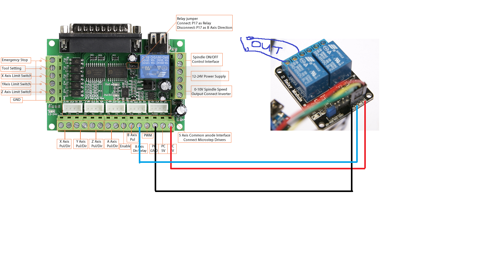

5 V +on Vcc on the relay board or you will burn it out !
Printable View
Chaz wrong time of night for sense:distracted: But I think you need to supply the bob with two power supplies one 5V and the other 12-24V before you will get any sense from it. Those bob's are £3,20 from ebay (China) inc PoP
Attachment 21063
So, is this correct? If so, assuming the PC setup is right, my BoB is broken. P17 never changes state / voltage.
If you have set up the BoB OK with 12-24v GND and 5v from the PC using the USB cable AND the jumper on the BoB is off, AND ports and pins are set properly in Mach3, - then if your BoB is working it should work.

Pretty sure the BOB is screwed. I tried to use its relay output and did something wrong. So a new one should be ordered I believe.
Fcking electronics.
New BOB, all works. Awesome.
