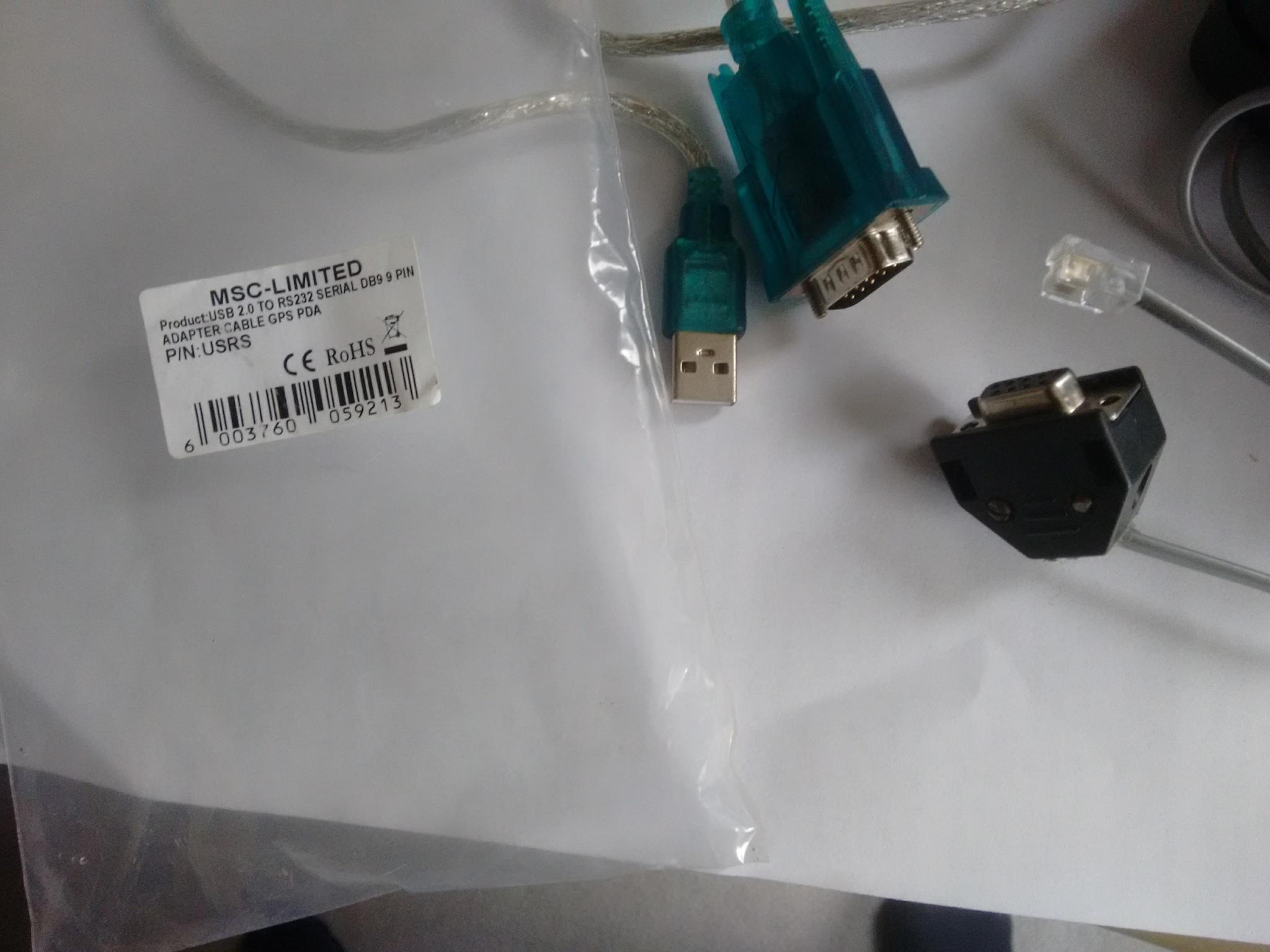

For the avoidance of doubt I use AM882's on the router, they are programmable with the RJ11 socket on the end.
You can make a lead up from an old phone then chop the end off and fit a D9 plug on using just 3 wires. Then use a USB to D9 adaptor to connect the RJ11 lead to the PC.Attachment 23247

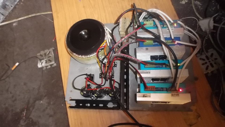

Trying to work out how to setup the bottom axis something to do with joints in the .hal file I think or .ini
my 12v PSU came fits perfectly in the bottom right corner (White box) and fitted another barrier terminal for power in, have the current limited thermistor as well will get that hooked this evening.
Attachment 23271
Where's my AM882 Mr Postman starting to wish I'd ordered EM806 instead but thought I might as well stick with AM882's all round and was 1/2 the price for what appears to be identical driver.
Re: New build with recycled parts on a ridiculous budget 120cm*60cm work area
The current limiter thermistor came so hooked it up and turned on the PSU came one OK although need to test it with load of course.
Now need to wire it through the mcb type b then through the resistor and to the transformer and see if it works ok, now we get to see if I got the right one lol was quite confusing which one to get.
Attachment 23281
Can't do a lot more until the last AM882 comes although getting it to move the dual ballscrew axis would be good, have got the fan holes drilled now.
Got the MCB hooked up and the current limit thermistor and it all works perfectly ;)
MCB 6amp type b, trips without the thermistor doesn't trip with it. PSU appears to be running fine have to wait for the AM882 to come so I can test it under load but should be fine. The resistor is rated to 5amp once it's up to temp.
Is there any point adding a slow fuse as well now I have working MCB type b protection?
The 12v PSU doesn't go through the MCB only the toroidal transformer.
Attachment 23286
This is the correct current limited thermistor for a 1kva toroidal transformer
http://www.ebay.co.uk/itm/2x-NTC-10D...72.m2749.l2649
If anyone else is interested.
I notice when you turn the transformer off the AM882 stay lit for about 5 seconds and when you test the capacitors when you've turned it off they're ready 7v's so it's good to know the capacitors are mostly discharged by the AM882's at switch off although I might still add a resistor.

Long time coming but finally she moves using the AM882's and the Toroidal PSU from linuxcnc ;)
https://www.youtube.com/watch?v=JH7ISQcmeUM
At the moment I auto tuned the steppers (Hopefully, flick the SW4 switch on/off/on with rotation knob in 0 position) and set microstepping to 2 just to get it working but will get it set it properly next couple of days.)
What microstepping do others use for their AM882's? I was thinking X16.
