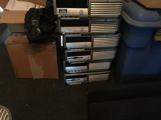

BTW do you still want those Compac PC's ?
How big are they? Trying to work out if they will fit in my bikes top box, thanks
Re: Thor, or should that be Zeus?
If your top box is built like Thor then possibly !!
They are 340 mm x 380 mm x 100 mm and I think that there are six of seven of them

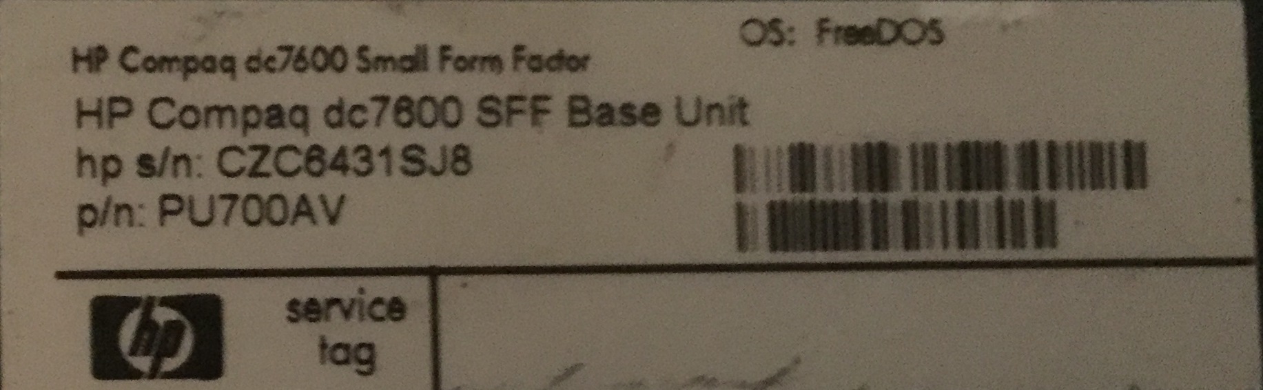

Chaz pictures of the PCs attached:
Processor Intel(R) Pentium(R) D CPU 2.80GHz, 2793 Mhz, 2 Core(s), 2 Logical Processor(s)
Most have had the HDD removed but I've found a box of suitable HDD's !!!! Some have DVD / CD players, at least one has a floppy disk play - all are modular so you can make a specific one from bits of the others.
All have a parallel and serial port so good for MACH3
Attachment 22005
Attachment 22006

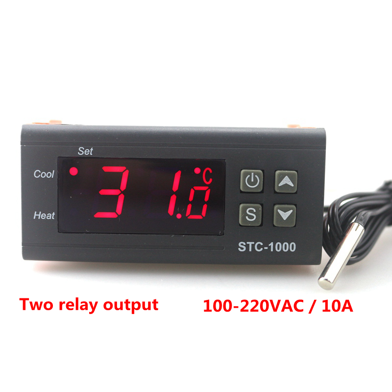

I would add a 2nd pump to circulate through the spindle then hook the chiller to a thermostat like this
Attachment 22061
A pond style water pump will work fine I have a box of 20 of them I can send you one for free if you want and will use less electricity than the pump in the chiller.
With a reasonable size res of 20l's the chiller will only need to run a few minutes in an hour and I bet that water pump in the chiller uses quite a bit of juice.
Attachment 22061
With a reasonable size res of 20l's the chiller will only need to run a few minutes in an hour.
