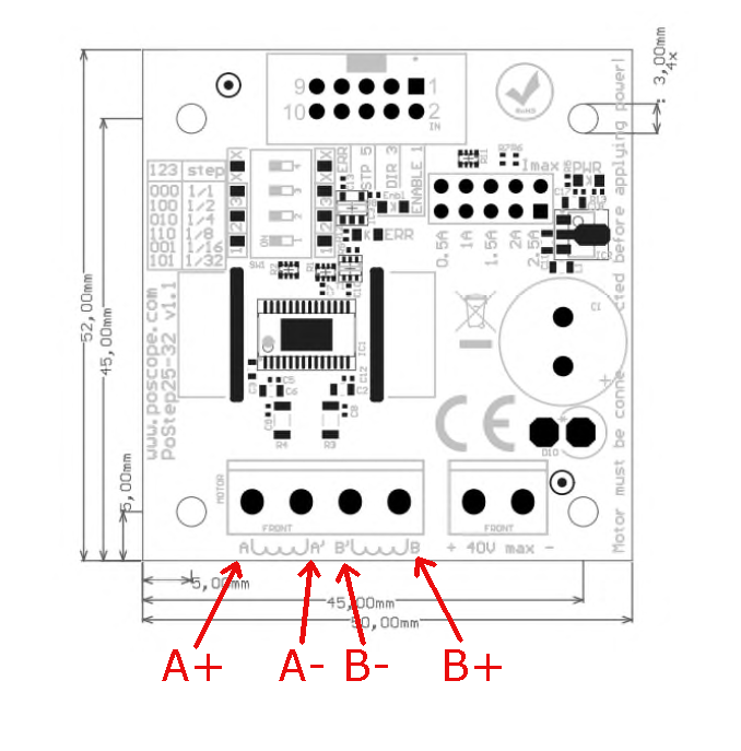

I've found a schematic for your driver board - my assumption was correct... you will want to set the jumper to the second from last set of pins to allow it to use 2.0 Amps (has 2A next to the pins). That would explain your motors being so pathetic as they were only getting half an amp. You can also see the dip switch settings to set microstepping which will give you smoother motion. You will need to then adjust steps per unit to match however.

		awesome detective work there, I was too busy trying to find a schematic for the whole box.  didnt think to look for a schematic for the individual driver (actually forgot they existed)

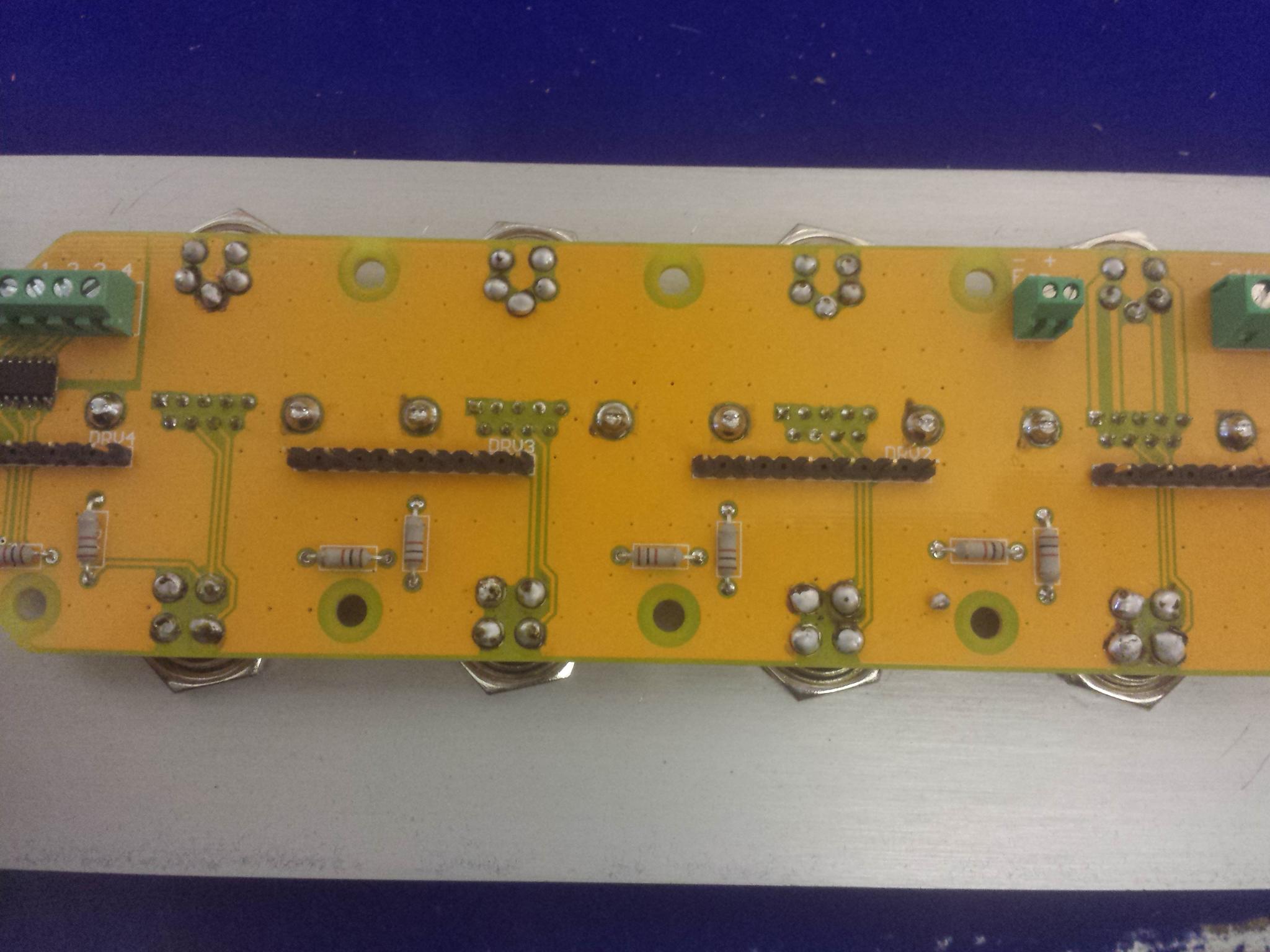

		here is a pic of the soldering I did, the limit switch plugs are on the bottom.
Attachment 22662
I cant see anything obviously wrong from the picture, to check the back of it would mean removing all the soldering to allow it to separate.  Am I correct in understanding that I could program the end socket to act as the y axis input if it works?
Just an idea
		Re: My Cheapo Chineese 3020t mini CNC Build (more like improvements) leanring all the
		Really the easiest way to check for shorts or a break in continuity between points is using a multimeter... anything else is just guessing. If you don't have one, they are fairly cheap and extremely useful when doing anything remotely involving electronics.
Yes it is probably possible in your software to assign whatever switch input to whatever axis, but I have no experience with the planet-cnc stuff I'm afraid.
