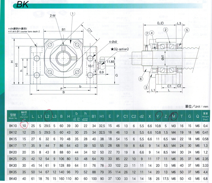

The distance between BK12/BF12 fittings is 46mm they do fit but it's less than perfect, my gantry is fit like this. I made adapters for my bottom axis (With the proper 46mm spacing) and you can tell the fit is better.
Attachment 23083 look under P
Personally if I build with extrusion again I will make adapters for all the BK/BF fittings. (A non issues for the Z of course)
