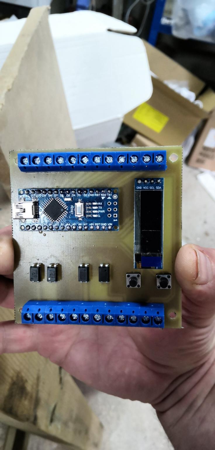

Interesting idea, but I'd look at the pulse output frequency of the DDCS and your intended stepping rate, then the frequency response of the PC817s and the effective throughput you'll get on a 16MHz '328. You are limiting the performance of the machine. At the least I'd look to replace the opto's. Pass-through performance can be easily added with adding a 74-series logic device to allowing DDCS signalling to pass-through, or to augment from the Ardy.
Of course, your mileage might vary.
EDIT: not suggesting this, but have a look at the ESP32s - particularly with the onboard OLEDs, having a dual-core processor at 240MHz meant for a very easy protocol converter with fancy graphic display (was converting RS485 to RS232 at 1.2MHz, with one core dedicated to the graphics and one just copying from UART buffers)... similar but different kind of solution.
Re: Joe's 1000x600x200 steel and aluminium router started
Clock of DDCS is 500khz, my code mirrors directly off the port so low overhead compared to arduino libs. I will verify propagation delay with the scope. PC817s are only on switches not step/dir, this is also the opto inside the DDCS, i've just had a look. Agree easy to build part of it with multiplexers but I'm not sure it is required. I've got a box full of ESPs here, again not required for this.
With 16x ustepping and 10mm pitch screws you are at 320 steps/mm so 500kHz gives 1500mm/s and a screw speed of 10k rpm, we only need 1/10th of this tops so I don't think frequency will be an issue.
Interested to see how this goes. Glad to hear you're bit-banging, though as the 328 is inline with the axis pulses to the stepper drivers it has to keep up at all time (not just homing) and I'd be curious if you can hold the signalling whilst I2Cing the display - interesting challenge.
I did realise after writing that the optos were for homing switches/reflection into the DDCS, so, yeah, will be fine - I'll withdraw that.

Yeh the I2C is the dubious part, albeit it is done in hardware, I haven't coded that yet, if it gets in the way it can be omitted. I just usually add them to all my boards these days as I have a drawer full and they only cost a few quid. In this case I had disable the uart to use the rx/tx pins for outputs so without I2C there is no way to get any debug out whilst testing. I did this so I could get a full 8 bit synchronous port write to the drivers rather that making multiple consecutive writes. Every true IO pin is in use ;-)

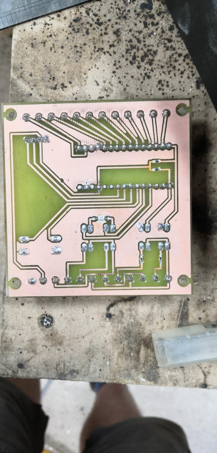

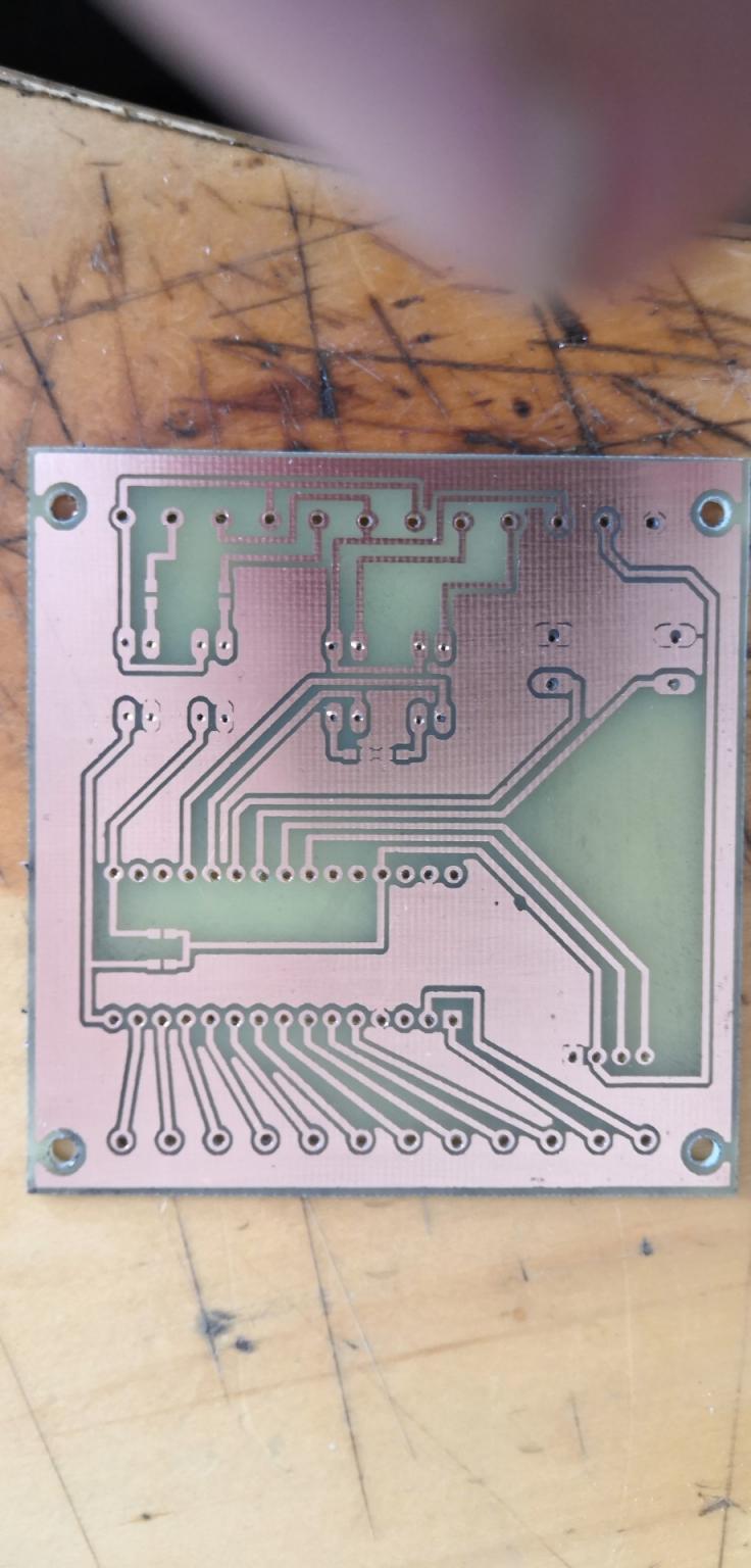

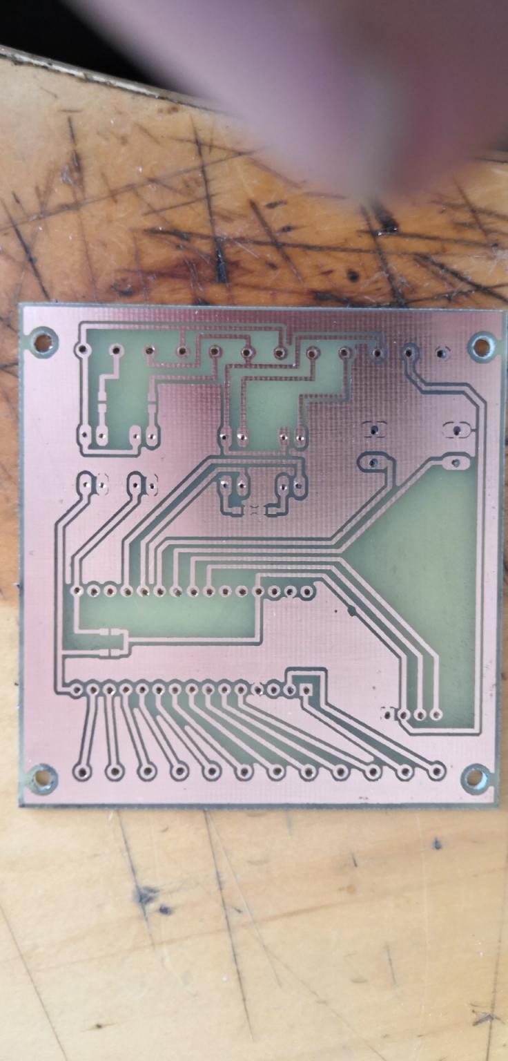

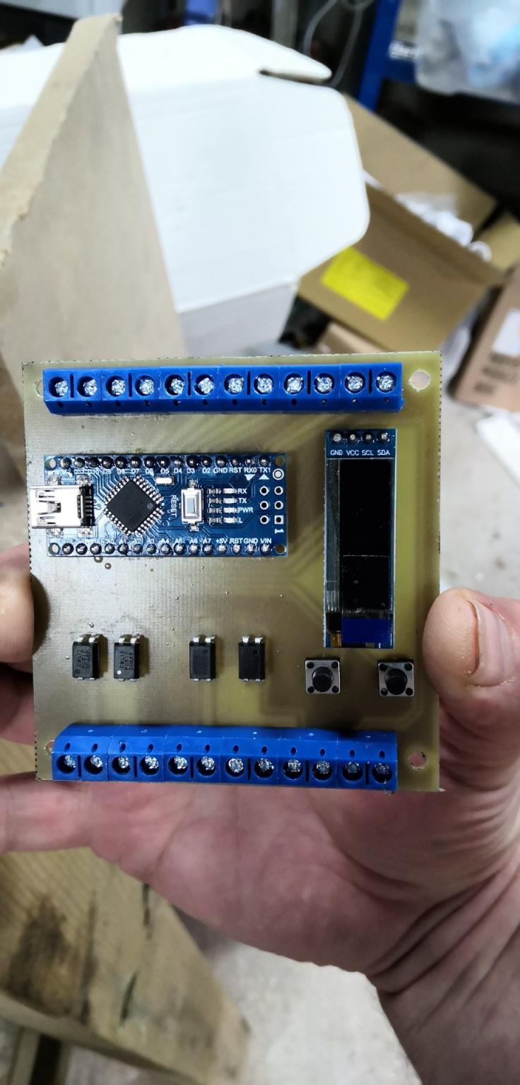

I still have a PC with a MACH license on it to revert to if this doesn't work. Just want to try and remove all the associated cruft (keyboard, monitor, desktop) I usually have around the machine to make it work. I've now drilled and assembled the board, tested connectivity then lacquered the copper side (just in case it is a keeper!).
Attachment 28311 Attachment 28312 Attachment 28313
I need some more solder paste mine is about 5 years past its best and someone has bent the ends of my nice tweezers meaning putting those resistors on was a PITA.
Cheers, Joe

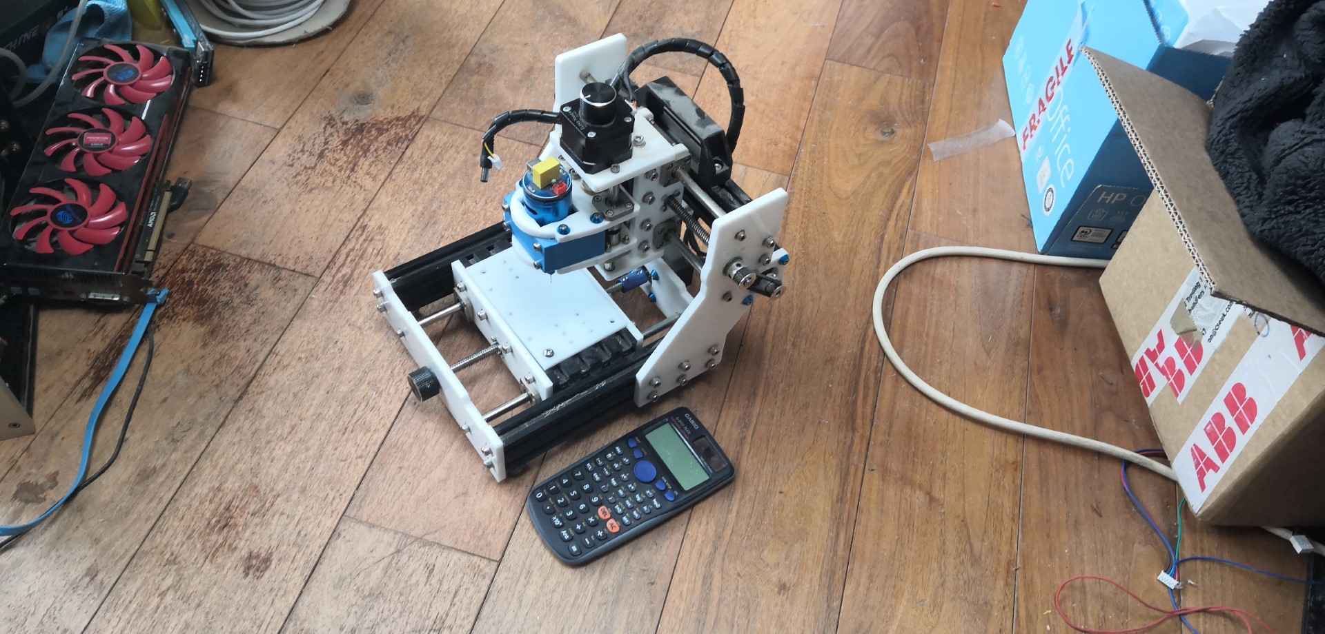

For crude through hole boards with thick traces like this one I use the toner transfer method with a £50 Brother laser printer from Argos, good results and takes <15 mins to make a board including etch and drill, I drill by hand on a tiny toy CNC machine. This process works well for double sided boards as well.
Attachment 28335
For higher resolution boards I use a CNC photo method on the same toy machine. Spray the copper with black paint then use a low power UV laser in the machine to isolation route it. Wash off the ablated paint then etch. If the board requires any drilling and/or is double sided I use a fixture so to re-locate it after etch. This process takes a bit longer but I can achieve 0.2mm features/tracks.
Anything more complicated with >2 layers gets sent to China, even if just a proto. All the SMD stuff gets soldered with hot air, agree very easy if your solder paste isn't like gritty chewing gum.
