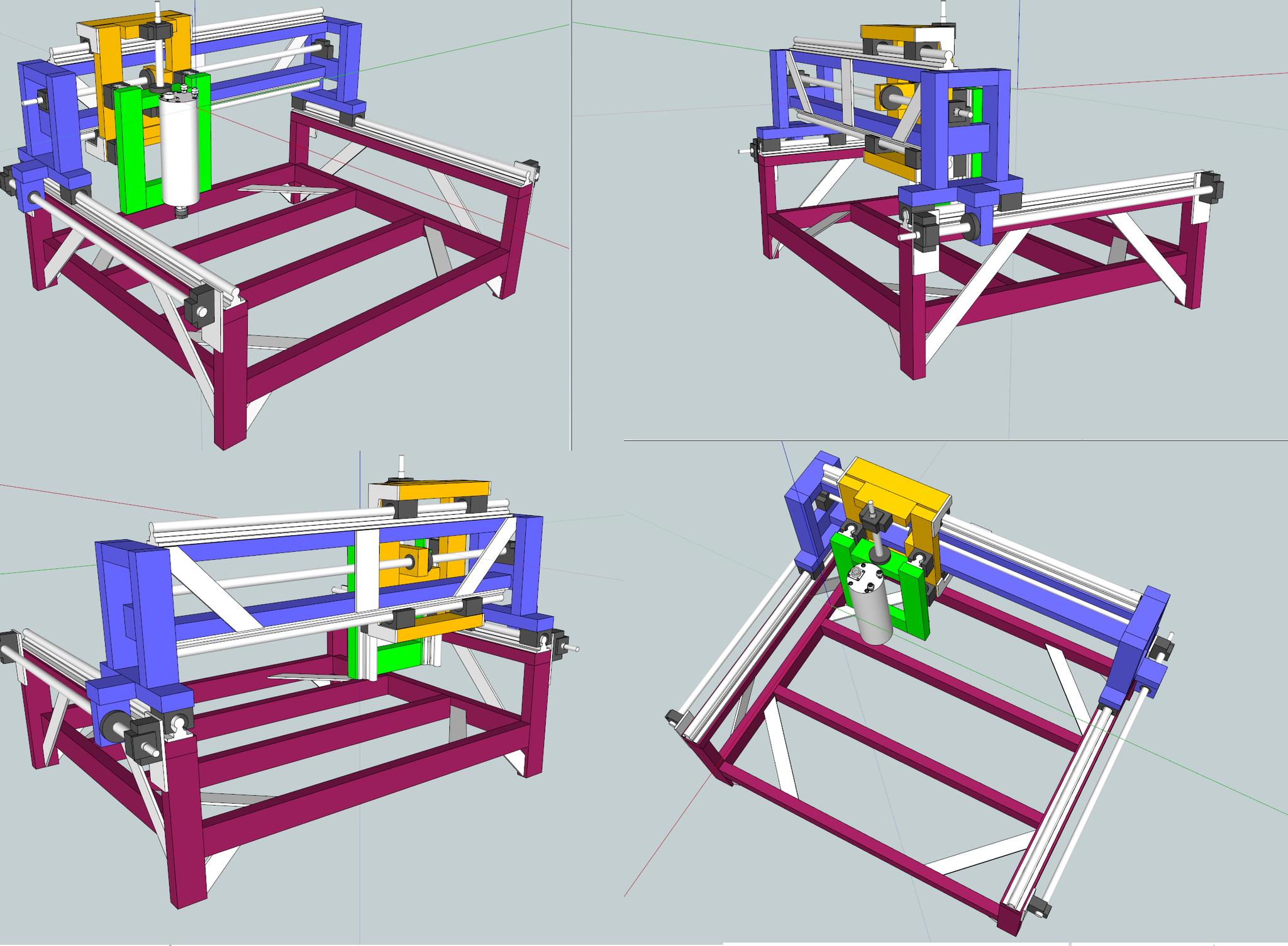

never thought about that, but if you look back at the previous page, dean has kindly gone over my design and reduced it down and says that it should leave me with 3 meters now out of a full length and all i have to use is 50mm x 5mm instead. which outs the cost at £90 on the dot so i'm more than happy.. and it looks a damn sight better than mine lol
right, i've finally too jazz's drawing and re-drew it back in to sketchup. i couldnt get on with rhino, its possibly something i'll go back to as i'm aware sketchup isn't that great for actual cnc work.
any way here it is
Attachment 7900
all colour coded as previous designs, the white flat bits are 50 x 5mm flat bar.
travel is around 450mm x axis, 578mm y axis and 100mm z axis.
i havn't worked out how much steel is used here, but i know already it's going to come in well under the 2 lengths now.. but as a trade off i've gained 50x5mm flat bar so that total cost of the steel as i said before will be £90. i'm happy with that and i still feel it's going to come in under my £1k budget.
i think it's time to start clearing the garage up a bit and think about ordering the steel :D
just added everything up total length of steel is 11.7mtrs before cuts which will probs be closer to 12mtrs leaving me a good 3mtrs spare..

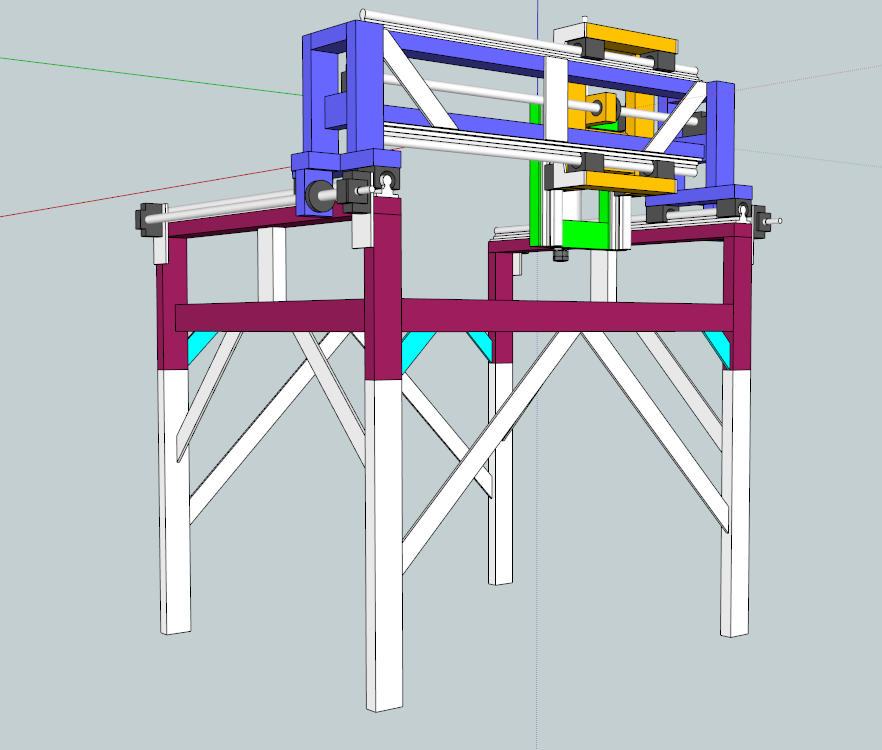

now i've just done this rough but with 3 mtrs if i extend the legs down by 500mm shown in white here, i have enough flat bar to put support where the longer bits are pictured and that will be pretty much it, but i have a feeling that wont be enough :s
in this picture i have dropped the legs down 500mm, as shown by the white bits, i've also moved the rail supports down and put a piece of 50x25 in the middle of the rail support. the turquoise blue bits can be removed i've just left them in so i can revert back.
my question is will this extension of the legs work or will it be a bit wobbly? this is the maximum use of the extra steel left over but it would make it better for me to have it floor standing as i know the bench is no longer big enough to support it.
Attachment 7906
Wilfy sounds like you need to take a trip to the scrap yard? Go have a poke around and you never know what you may come up with. look for old metal cabinets or similar. this would work for your base, stick a wanted on Freecycle? save your money for the best bits :eagerness:
Take this with a pinch of salt as my experience is with wood not metal but I'd say that your (white) bracing at either end is too long for that thickness of steel your using. I would shorten the bracing to roughly half way between old and new and then put stretchers between the legs (like a dining chair has). Grab a length of your 50x5 bar at the length you've drawn the brace and see if you can flex it by hand, if you can I don't think it'll be strong enough to act as a brace at that length.
it doesnt have to be done this way, it was just an idea i had to use the rest of the steel what you see in the picture is all the steel end of.. if it doesnt work, i'll just figure out a way to make it work as a desktop machine it might mean that 2 legs are secured to my worktops and with the left overs i will have enough to extend the other 2 legs down to the ground and do it that way and brace as you said like a chair.
is it likely i'll need any adjustment in the feet of the machine??
I agree with the earlier post - those strips are too thin to be useful for bracing. Your problem is they need to be strong in tension (which they are) and compression. A strip is the worst cross section under compression as it'll just bend. Angle would be better, or better still more box section. Also using thin strip for bracing is asking for trouble with resonance as the strip can vibrate, just like a rubber band. If the resonant frequency of the strips is a long way from the frequencies induced due to the motors and cutter then you wont have a problem, however calculating that is not trivial. Shorter strips will have a higher resonant frequency, so are less likely to cause problems, but clearly to an extent offer less support so it is is a compromise.. There's some good information on this site, Mechanical Resonance - Factors that Affect Natural Frequency.
