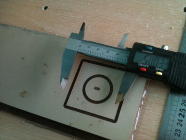

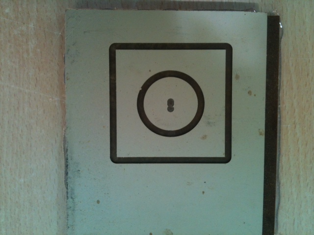

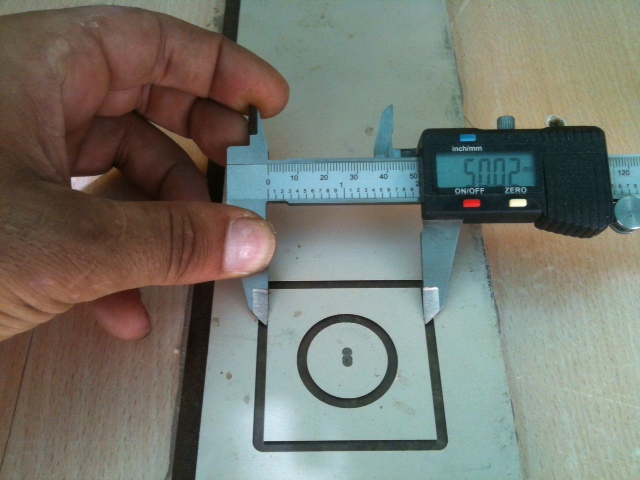

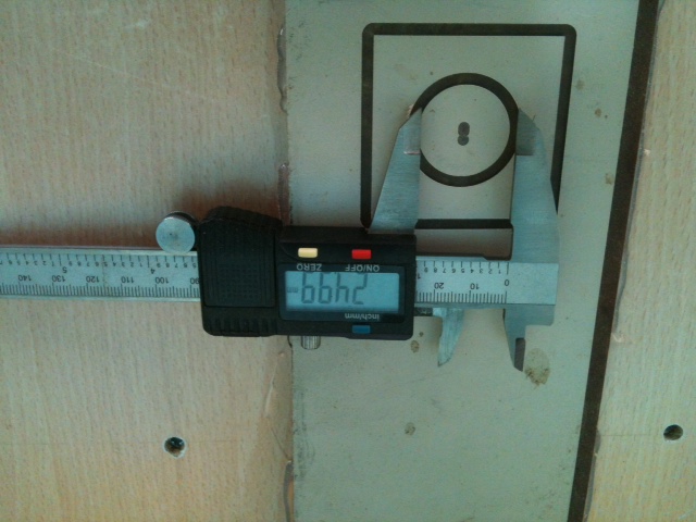

Now about the final accuracy i achieved. Today i run it for first time cutting. My typical starting test is 25mm OD circle in 50mm square
Pictures speak better than words but lets say that all the careful fiddling payed itself and the final/accumulated/ accuracy of the machine without any compensation on mach 3 motor tuning and so is :victorious:0.01-0.02mm :victorious: or less , having in mind that the digital caliper measuring may be not perfect. As you can see perfect super clean circle cut. No mismatch or whatsoever.
PS.The bed is 5cm thick so the Z at the test was extended at its lowest point.
Attachment 12773 Attachment 12774 Attachment 12776 Attachment 12777
